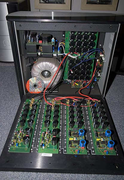

It means an amp where there's by design no sag on the supply rails irrespective of the output demanded by the load.
ML2
Classé Omega, both 1st and 2nd ed. (v2 btl monaural=> http://www.diyaudio.com/forums/atta...504-sound-quality-vs-measurements-ooh-pen.jpg )
(l'Ampli Fou Fou, by Hephaïstos aka Gerard Perrot, '90, l'Audiophile magazine. my ksa50 mono turd, handles 700W dissipation at 5 amp bias level, rail regulation circuitry from the omega)
ML2
There you go, of course it can be done, and obviously is being done.
In the end, it all comes down to space (due to enormous passive heat sinks required if one doesn't want any fans) and of course cost.
