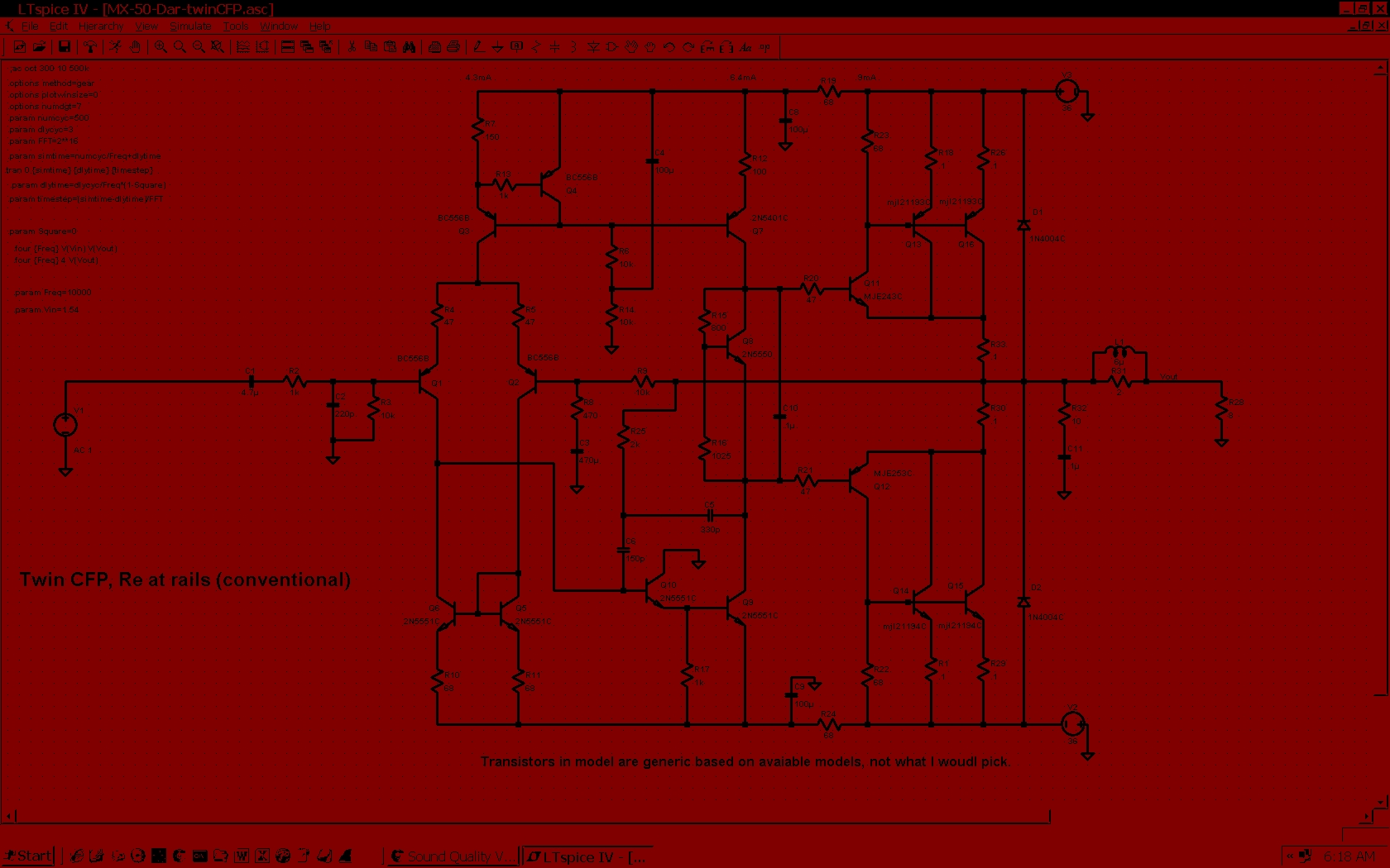

Here is what I keep coming to for a "reasonable" amp. I don't claim anything greatly insightful, just that the SPICE testing of many combinations keeps coming to about this. Before I build something like this, I need to put the effort into the selection of driver and outputs. 2sc5200/2sa1934 outputs maybe? I don't claim I have sufficient understanding to select the perfect choice in standing currents yet. Clearly, no effort at all in protecting over-current or clipping recovery. This was just to understand the amplifier function and how it related to the discussion in this thread about why some amps ( Rotel 9 series) sounded better no my then less than desirable speakers, and why when I build much better speakers the much better amps (Parasounds) then sounded much better. Then when I modified my DH120 with what I first learned, it was most successful.
Any suggestions are most welcome. Please provide some insight on why as the goal is not to build a super amp, but to understand them better. (I have stockpiled enough HCA 1200's and 750s I am set for a while)

From only my beginner understanding, I am amazed at the choices, as I am not in a position to say "mistakes", but things as simple as omitting the current mirror in the input and not buffering the VAS as well as a host of layout and mechanical issues does seem inexcusable by this day and time. I have looked at well over 100 published schematics and there does seem to be a willingness to ignore prior art. I do have to put a time filter in it. As an example, comparing Erno's first published MOSFET amp, through the Haflers and into later updates, what I would suggest are errors in not compensating for the different capacitance between the N and P was quickly learned and corrected. Anything built after, oh say 1980, should make use of the insights learned.
Based only on SPICE, after a few more tweaks today, the above amp posts less than 100 dB THD + Noise @ 10Khz. "Reasonable" I hope. Then what would it sound like? I suspect I have not dealt with dynamic issues such as clipping recovery and I am concerned with bias stability just by how sensitive it is is picking a "fixed" value in the model. Will just clamping the bias and one driver transistor together suffice?
Provided physical construction is correct and the obvious protection/limit issues, have I addressed the majority of what you consider major discrepancies? I am going to post over in the solid state thread with some of my protection questions.

Well, amplifiers can be made robust, to drive difficult loads by improving the power supply side of things. To be blunt, I have not changed the topology of existing amps, I work to enhance the stability of the voltage rails, where it counts - I'm not interested in turning the 60W amp into a 300W unit - I just want those 60 watts to be genuine ones!! So, one of my "tests" is to run amps up to just below their clipping point, and listen for the telltale tonal changes which means the amp has run out of steam ...

I see your points. Let me limit this to a voltage source amplifier with sufficient current, not the rare current source or some big-box AVR with almost no power supply. A real amp as we expect. Basically, I am saying if the amp prefers a higher impedance ( inductive by nature) load, why reduce the impedance of the speaker to make it flatter? It could actually make it harder to drive and it will increase the distortion. Obviously, this assumes we can get the transfer function we want out of the crossover first.
