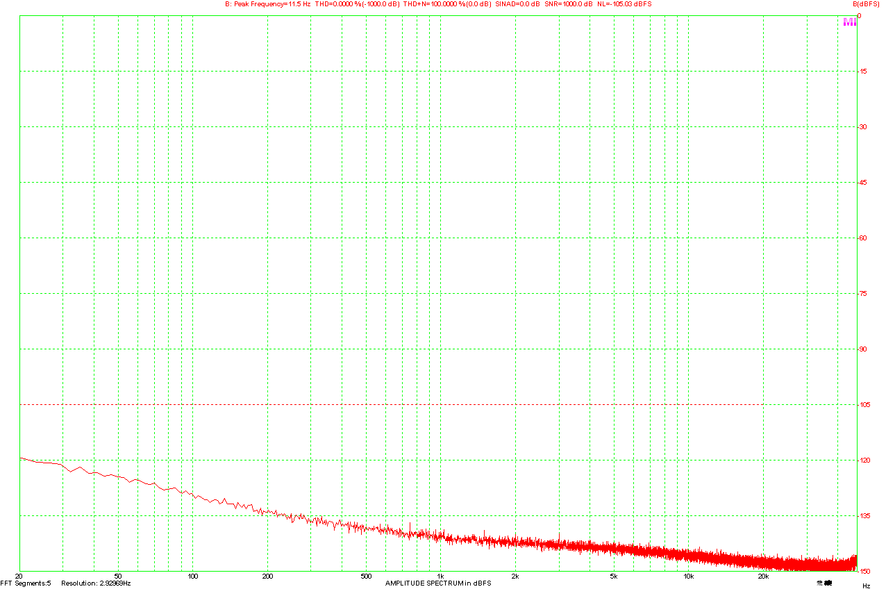

All, to make sure we understand the basic term, what is the noise level over audio band in the attached image?
The fact that the two are frequently presented as a single entity doesn't help matters. And, from my point of view noise is distortion, it is signal injected by the playback mechanism which is not part of the original waveform, the fact that it is largely random in nature is neither here nor there - distortion is distortion ...
So what is better - the design that has such low non-linear distortion that it rises from noise no sooner than somewhere at 10W, with noise level about -100dB re 2.83V unweighted over 20kHz.

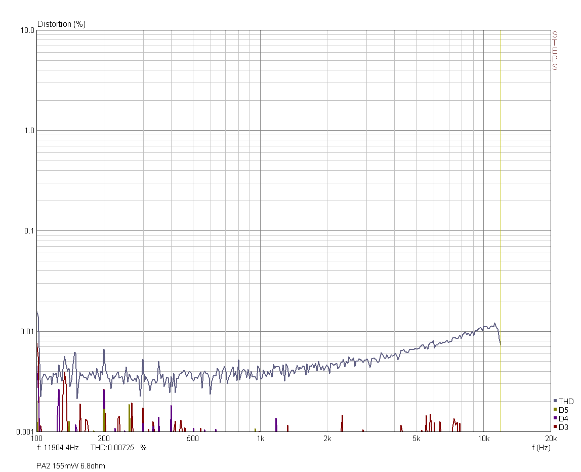

The design with noise level about -80dB re 2.83V unweighted over 20kHz, much higher non-linear distortion that dominates from some 100mW above noise, but is claimed to have superbly clean first watt?
134mW (you can read it from the image), 6.8 ohm.
I have digged out the board from the amplifier grave, just to show something. Normal is below 0.001% at 100mW. There are some Messiahs that like to speak about high distortion at low levels, these stories might have been true in the seventies or eighties. Or for a cheap underbiased design.

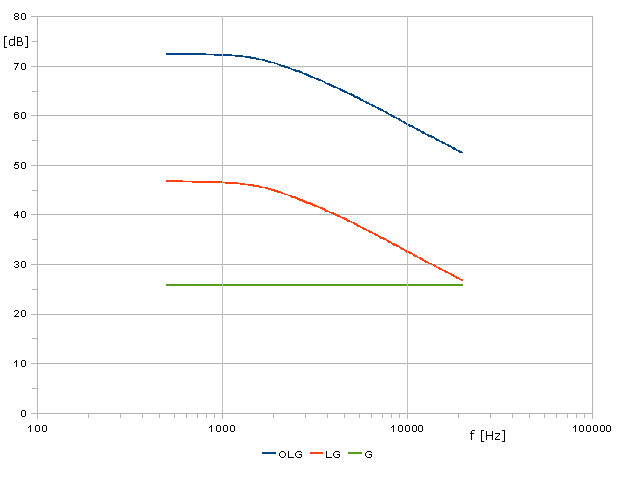

the Cordell feedback thread had a number of pages on Baxandal "harmonic multiplication"
I did my usual simmed demonstration for a 10% "pure square law" gain device:
http://www.diyaudio.com/forums/soli...erview-negative-feedback-287.html#post1875719
here is that sim reworked with ~ 1% open loop 2nd order distortion, and with 40 dB loop gain negative feedback
you can see the new 3rd harmonic in the yellow fft harmonic peaks, it is created by the negative feedback around the "pure square law" behavioral I source
@ -108 dB this new distortion product would be at or below the human hearing threshold in a anechoic chamber for most loudspeakers < mid 90s dB SPL/W sensitivity at the "First Watt" drive level under discussion
the added E1 gain block in the feedback circuit only uses Av=20 because I credited the feedback loop with the gain of 5 from the output device since the closed loop gain is 1 for the feedback circuit
