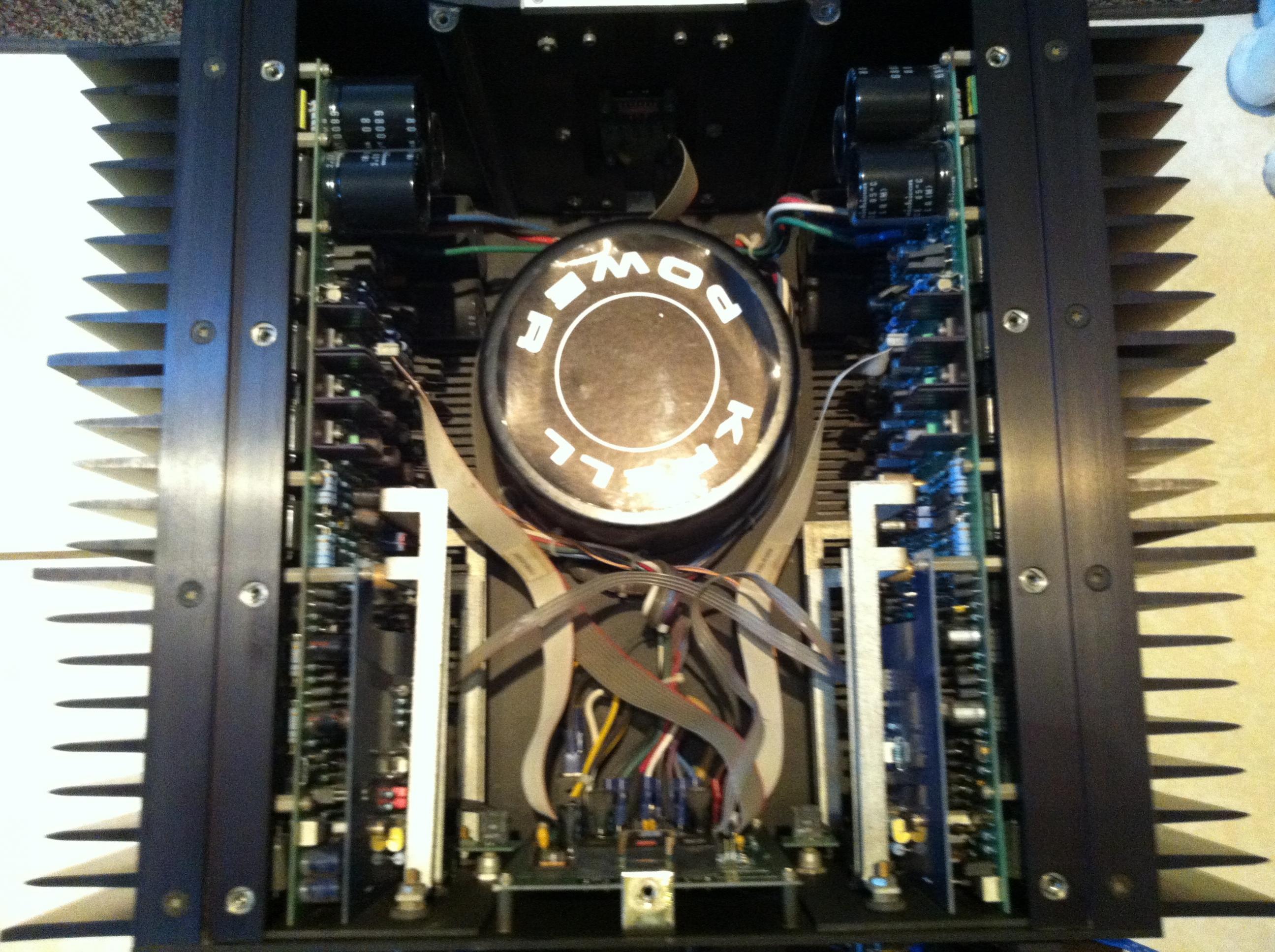

Agree , everyone i have ever heard sounds different , unfortunately they cost . Take a look at how much PSU 8K buys you , pathetic, yet sonic dash to spare ..
Try and find the PSU caps and yes it hates the big Bembeh ....:)
What's the problem, Wayne? I easily see 4 6,800uF caps per side, plus an additional pair lower down, in grey.
