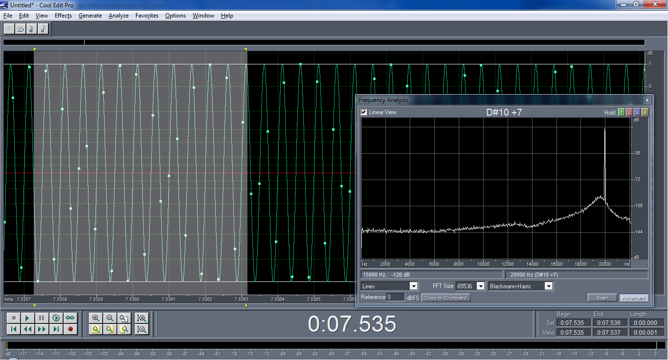

32-bit 20kHz sine generated in CoolEdit, converted to 16 bit with 0.5 bits dithering, triangular pobability distribution function and "Noise Shaping 44.1kHz". noise floor at ~ -142dB. I did not use averaging, because it looks even better then.
