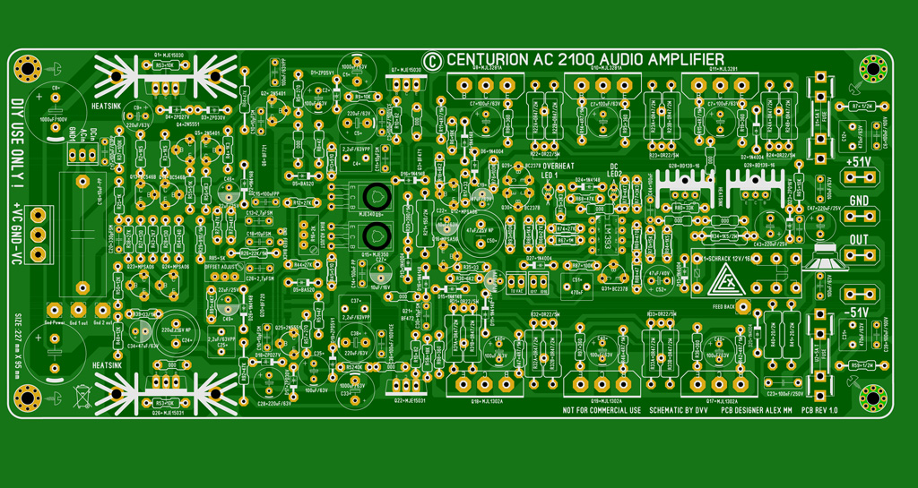

Nige, my amp is still in the process of birth. After that, there's the development stage, and that will take some time, I have an unholy list of things I want to try out.
But yes, I am rather proud of how it works with no global NFB. It's possible to get even more mileage from it, but just as I'm afraid of falling short, so I'm afraid of overdoing it.
With a THD of 0.3%, 20-20,000 Hz, 100WRMS/8 Ohms, but much more importantly with a harmonic decay rate ALMOST as good as I want it to be (more work is needed), I hope I am home and dry, with reasonably more development work.
Also, very important, even so it is pretty tolerant of not so nice loads with no global NFB. At least, so says my simulator, which has never before lied to me. Nevertheless, I don't completely believe in it all until I have a test unit running on my table and am starting to photograph 'scope screens.
According to my calc, it should be capable of working steady statedown to 3 Ohms; it should also be capable of around 560 Watts into 2 Ohm in impulses. IEC says impulses should be 20 mS, but to me, no less than 45 mS is what I want.
I nearly pulled it off with my last one some years ago, but even then, I somehow knew that wasn't the real McCoy and that I'd be back at it sooner or later.
Since most people here probably have no idea of what we are on about, here's the incriminated device:
Just a quick note: some part designations are wrong, and the note lists the wrong transistor to be mounted on the heat sink.
And the second board, one to be piggybacked, is still to come any day now.
The end result should be a complete power module, with everything but the large filter caps on it. So someone may want to install say 3 in one case.
Also in the works is the basically same amp adapted to half the nominal power, 50/100 W into 8/4 Ohms, but REALLY pushed into pure class A.
Then I would have enough to upgrade my loudspeakers into fully active.
Is that a real speaker load, simulated load, or a resistor?
For the time being, just the simulator, working into an 8 Ohms +/-10% load.
As UI mentioned, my simulator has NEVER ONCE failed me, or even just lied a bit to me. And if it is off, it's always for the better, it says say 300 kHZ, and actual sample hits 350 kHz.
While it is obviously a good simulator, another reason for this I believe is the fact that I make very sure proper part tolerances are correctly noted. Capacitor - 20% tolerance, resistor - 1 or 5 % tolerance (5% for Motorola MPC series, as quoted by Motorola and as experience confirms), etc. I am amazed how people tend to overlook this obvious aspect, and often simulate with no tolerance parts, i.e. prefect parts.
Let me repeat - all that is nice and fine, but until I have an actual, working unit in front of me, I will doubt.

Nige, I won't know until I actually make it. Yes, it looks good on electronic paper, but real life can play funnies on one.
If it makes the grade, I will send you the PC boards. If I make it to the UK this September, I will bring them with me. German made Mil Spec glass fibre board, 70 micron copper layer, fully metalized through holes.
