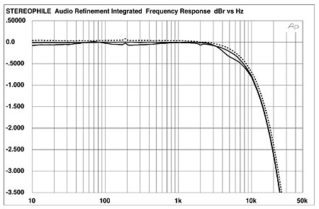

as I wrote before, some 2 weeks ago I had the chance to do some comparisons, including my amp vs. an entry-level Accuphase (entry-level as per their definition, e.g. 3k new). there was a definite improvement in highs reproduction with the Accu. which made me remember my amp's FR response which you can see below. -2.5 dB at 20kHz. not much, eh? I mean, we all know that not many adults are able to hear past 18kHz anyway, some don't even manage past 16k. (FWIW, I'm 33 and never had an audiogram done; I suspect a tiny bit of hearing loss in the right ear because of an otitis I suffered from a few years back).
and... after all, just look at a spectrogram of real music, you'll be able to see there's not much high-frequency content to begin with, not even instantaneous, let alone averaged. right? and, as if it wasn't enough, there's Fletcher-Munson. we're definitely less sensitive to highs, right? and... finally, ~2dB is considered the "barely detectable" threshold for freq. response variations.
but I thought I have all the tools to test just what those 2.5dB at 20kHz mean. so I generated some white noise and applied an inverse curve in order to have a near-flat frequency response up 20kHz. then A/B'd from my listening position as I have a PC remote. I could even do ABX, as pressing "next" a large number of times with the eyes closed makes it pretty impossible to tell which of the 2 files is which.
well, I couldn't believe how audible the difference was. in a way it's "barely" detectable. in another way, that "barely" means a lot. it's able to give a very distinct tonality to the hiss and make it sound, well, more "open". I'll try it with music too but I don't expect any change in perception.
next time when someone goes on about how "smooth" the NOS DACs are I'll remember to keep some salt nearby 😀
(and the FR)

All you forgot to think about is phase response. With -2.5 dB at 20 kHz, it is not good.
I read somehwre, can't remember where, that many people can hear a 4 degree phase shift at 20 kHz as a slightly out of focus sound, not clear enough. Working backwards, you need an actual bandwidth of about 200 kHz to avoid this problem.
I push mine to 350+ kHz at -3 dB ref. full nominal power into 8 Ohms, then I install a low pass filter with -3 dB at around 200 kHz. Never fails, even if the absolute overall results do vary.

actually, I didn't 🙂
but I have absolutely no serious reason to believe that what I heard was because of phase-related issues. yeah, I know, if you have -3dB at 20kHz you have phase issues below that. but all the studies I know about don't mention phase audibility at the top of the range. quite the contrary, audibility is said to be lower there. at least compared to midrange audibility.
and I could mention that a decoupling cap at the input of an amp, if incorrectly chosen, can have effects up to the mid-bass where it's pretty much proven since the 70s to be audible. you rarely see discussion about that, everyone cares about the magnitude response 🙂
and, with independent channel white noise there's practically no phasing to talk about.
but yes, I do agree that an DC-coupled amp having a corner frequency in the 100s of kHzs region and will shut up all naysayers 😀

Thats alot of rolloff for only 18K and it will absolutely affect the sound below it, you need double bandwidth(0-40K) to not have any top end issues and more has been known to "sound " better for whatever reasons.
allow me to waste my time, money and nerves drawing that conclusion 🙂
IME, in this regard (post 20kHz response) "has been know" = guys who sell stuff say so. I'm not saying it's not true but I'll refrain from drawing any conclusions until I do side to side comparisons.
and one more thing. there are 2 distinct issues at play.
1. the pre-20kHz phase deviation caused by my amp
2. the audibility of a 2.5 dB boost centered at 20kHz. no-one asked whether my EQ was linear or minimum phase or what happened post 20kHz 🙂 even if my conclusion (the audible difference between the 2 amps being caused by magnitude response alone) is partially incorrect, the discussion of minimum vs. linear phase is still relevant.
