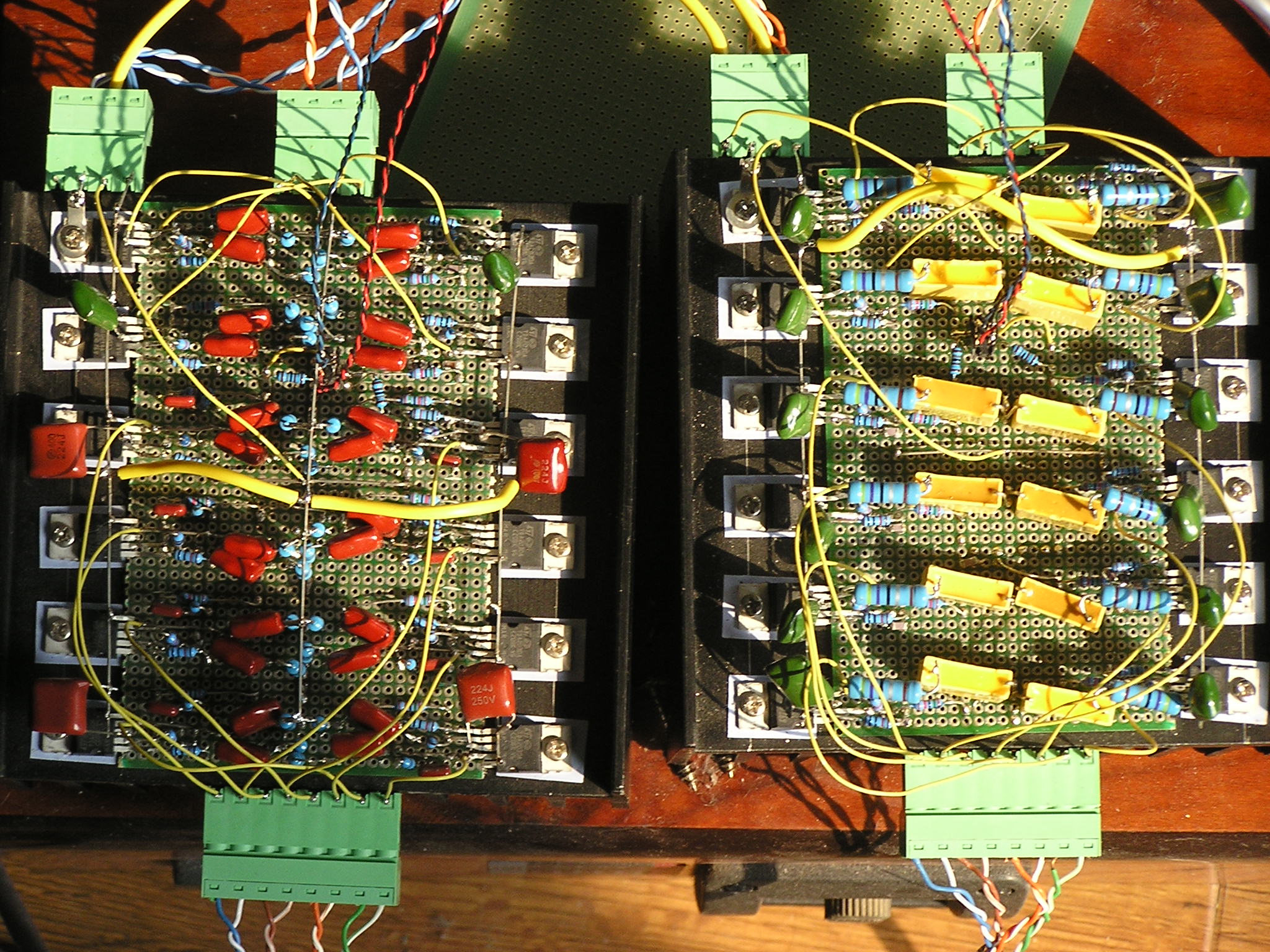

Indeed TDA2030's can be stacked - I did it 4 wide for the bass mids on these amps. Doesn't help with their sucky RF rejection though : http://www.diyaudio.com/forums/blogs/abraxalito/attachments/284d1289805868-more-transparency-active-speakers-part-ii-p6020438.jpg
I bet they still would run rings around valve amps on that problem ? When Henry Ford grafted two model T engines together the world never was the same . Suddenly an engine so very humble was not . The Flathead Ford V8 . Model T was remarkable . With the state of our roads maybe that's what I need ? People who laugh at model T do not realize it's special design . If the going gets tough is almost a 4x4 and no complexity .

Yeah - for audio there are better choices than TDA2030 I reckon. Not very transparent because of their RF susceptibility. I abandoned arrays of TDA2030s primarily though because sometimes on start-up they'd crowbar the supply, which was fine running from my bench supply because I could set the current limit so nothing got blown up. But I was unwilling to troubleshoot this problem as it was intermittent. Another reason for avoiding the TDA2030 was its lack of mute.
If you want to stack chips then TDA7293 would be my choice - its much easier as it has a master-slave facility built in. It also has mute. Its not quite as cheap though as TDA2030 (I was using the A version which has slightly higher max supply voltage).
