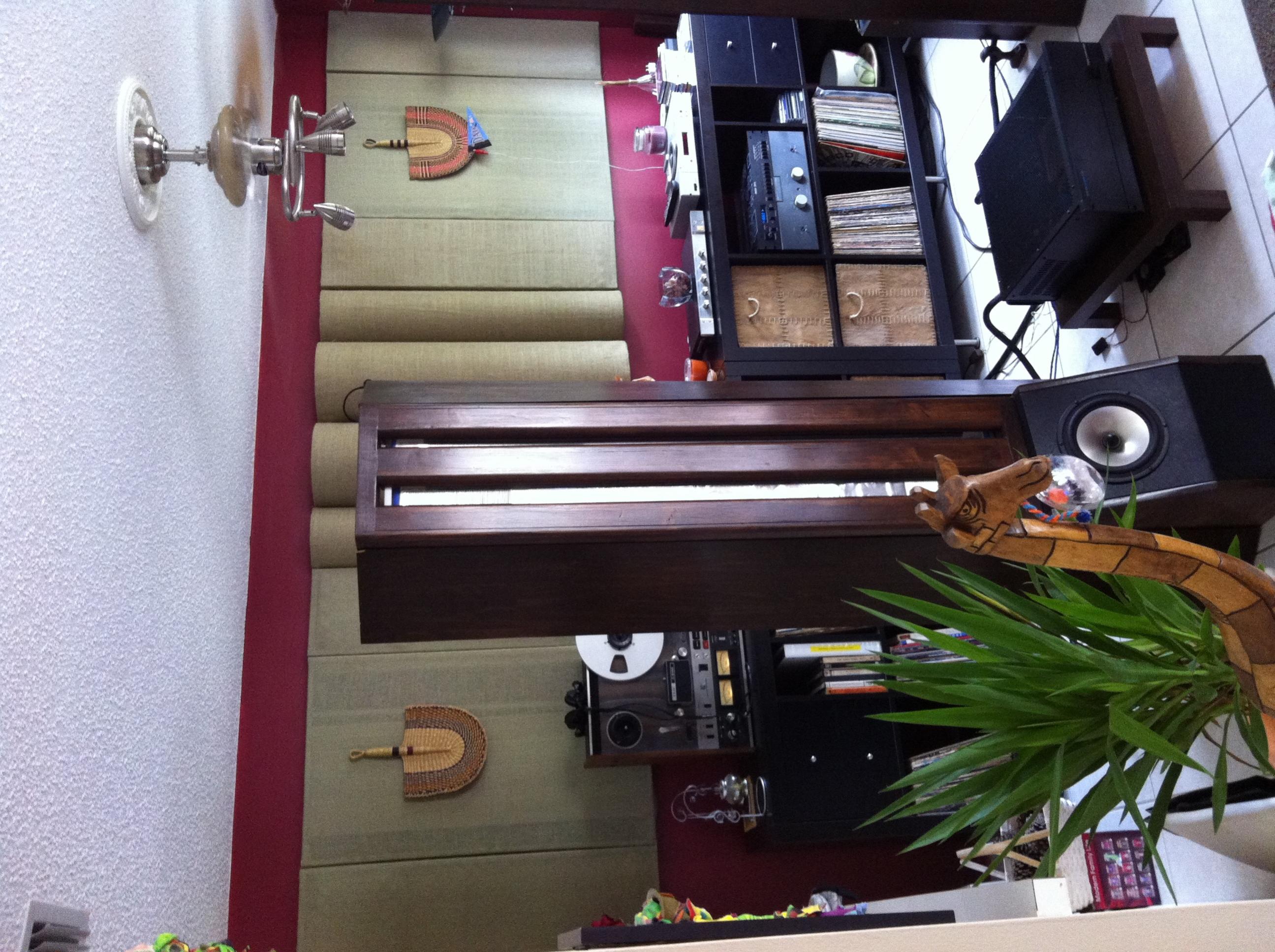

I'm using 6volt rms when playing loud , ok its nominal 1ohm (300-22k) , only man amplifiers need apply ...

Yes DIY, 3way direct drive ribbon (no transformers) hybrid.
Bel Canto class-d mono's did not work , as well as others . Krell,Threshold ,PS audio, adcom(565/555) are the few that has worked , i did not like the sonics of the adcoms ..
The PS audio works amazingly well considering 3pr output ....🙂
