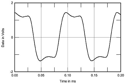

Yeah but doesn't class-d measure's poorly and they use a lot of negative feedback '...
Bel Canto mono's 10khz square wave ....
but doesn't class A measure poorly as they don't (generally) use a lot of negative feedback?Yeah but doesn't class-d measure's poorly and they use a lot of negative feedback '

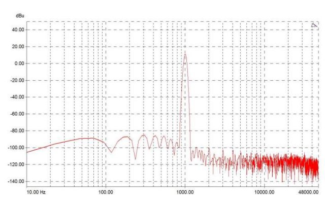

harmonic distortion:
Plot generated using Prism Sound dScope III.

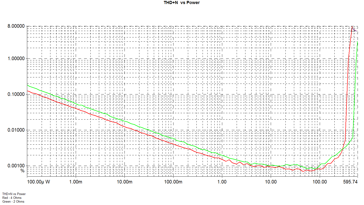

Distortion starts high, lowers then knee the rotation starts right at about 150 watts regardless of the load , so it's a 150 watt amp in 8/4/2 for best sonics , does have good drive ...

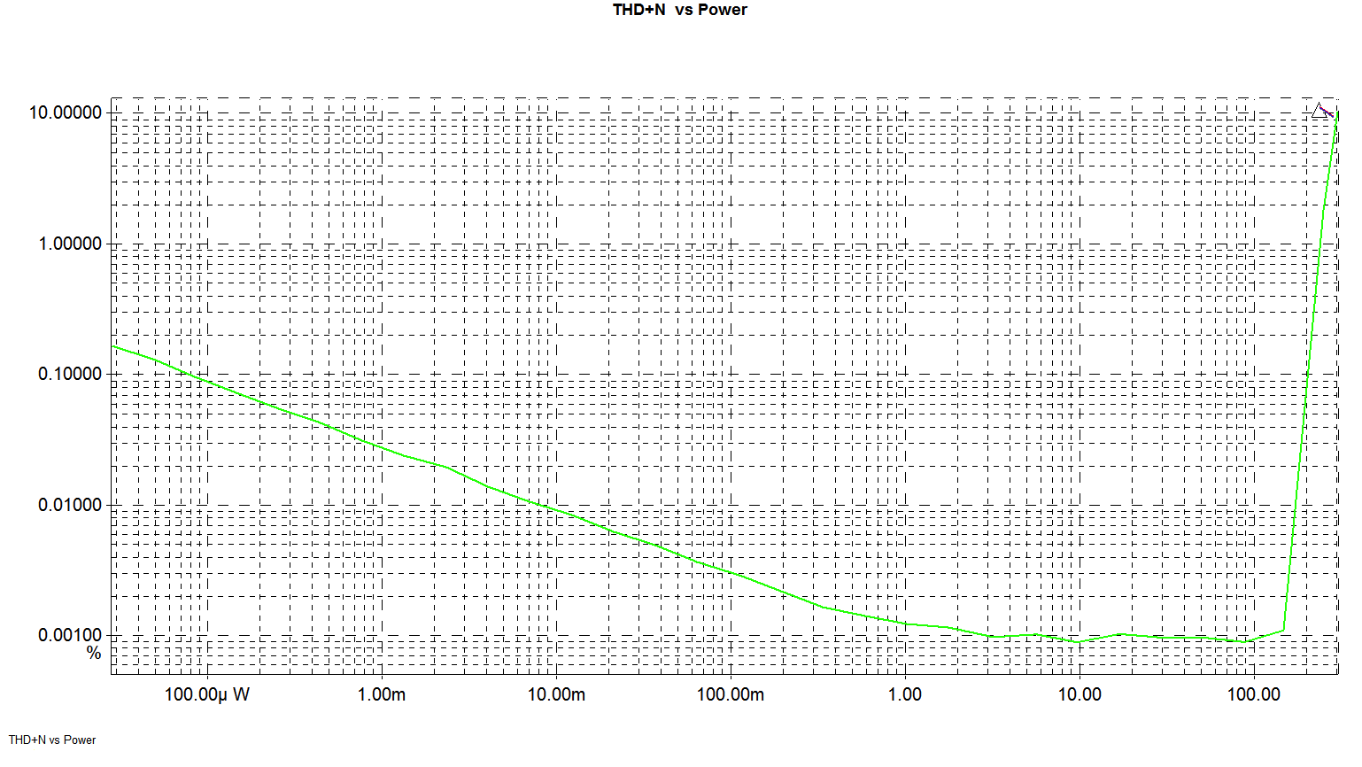

This is not true of the genre, search again ... 🙂
Datasheet of the Hypex amps I use, I think they measure (and sound) rather nice. http://www.hypex.nl/docs/UcD400HG_datasheet.pdf

Not all class D amps measure badly, and what's wrong with negative feedback as applied in the UcD & nCore examples I used? (Yes I just opened that can of worms 😀)

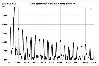

that is a well respected design. note that I erased the name. I can post many resembling HD plots.This is not true of the genre, search again ... 🙂
there are few class A amps measured by Stereophile that failed to reproduce a satisfying 10kHz wave. my point is that as long as we quote the measurements that we like to quote, we're going nowhere. I still don't see how a "perfectly" (note the quotes) reproduced 10kHz square wave relates to good sound while a distortion plot has nothing to do with it. yes, one can feel that an amp is subjectively not fast enough and intuitively relate that to square wave response but I'm yet to be convinced there's a direct connection.
