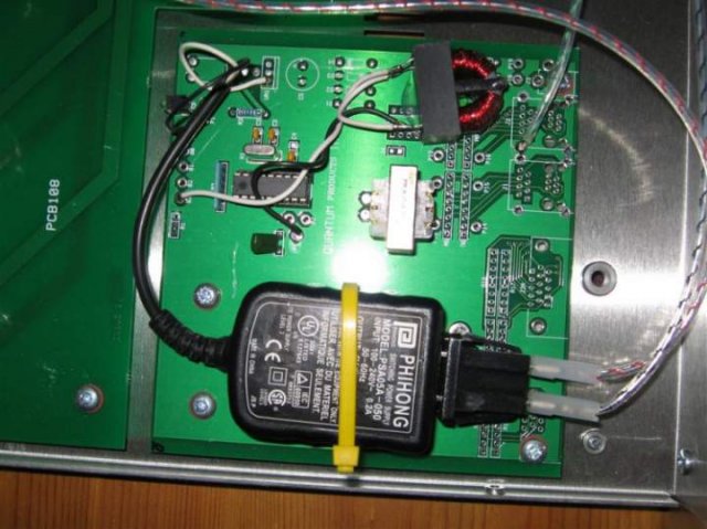

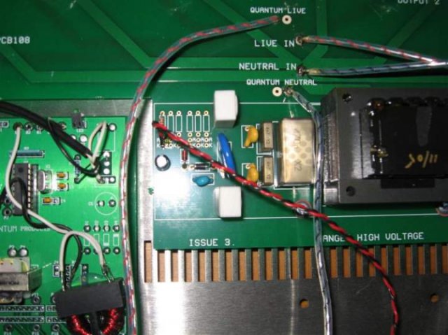

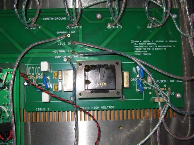

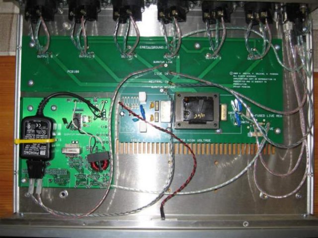

line "conditioners" you say? this is the Nordost Thor, $3300.
any speculation about the "role" of the PHIHONG wall wart supply?
What is that? A company? A product? A new type of whatever?
Frankly, I've never heard of "PHIHONG".
If that's some kind of wild new power supply, and if it's locked to the wall, by default I think it's more probably junk than anything else. Call me traditional, but a good power supply in my book has to have at least two decent, milk bottle sized capacitors, and I don't get to see that in wall warts.
A REALLY good power supply merits a separate case all of its own, as it needs to accommodate a heck of a lot of components, including a power line filter. It should be built in by default, not a wildly expensive extra. And it should be such as to both prevent garbage coming in and to stop any returns back to the grid from the device it powers.
Gotta get power for that Quantum Resonant Technology somewhere :rolleyes: Note that the wall wart is connected with superduper wire too.

Sorry my sarcasm wasn't more evident. Yes, it is a cheap d.c. non-switching wall wart from one of the world's major wall wart suppliers, and its only advantage is low primary-secondary capacitance. Since California essentially banned them in favor of cheap noisy switchers, we aren't allowed to buy them anymore here (they waste energy, supposedly, and the amount they do is tiny --- however, the law helped the coffers of such companies as Power Integrations immensely).
For me, this gushing review and the ilk are among the prime candidates for nasty tricks to be played on the reviewers. Never mind double blind --- just secretly sabotage their precious quantum devices etc. and let them suddenly notice, and tell you, that the music is missing. If they don't, tell them they are delusional and present proof.

Those things usually have a small transforme, one 1N4007 diode and a filter cap 470-1,000 uF inside. And that's it. All of which are of junk quality.
As such, they are, plain and simple, junk that is best avoided.
When I did ultra-cheap powered speakers (talking here of order 10 dollars for the entire bill of materials!) for Harman Multimedia, I typically used simple adapter transformers, no diodes/caps. It makes it far easier to accomplish quiet powerup/down, and as well it's more cost-effective to have the bulk cap close to the circuitry.
But usually the cheap d.c. output wall warts have a bridge, not a single diode, because it permits the transformer to have less core :)
When wall warts other than switchers were essentially outlawed in California, a lot of cheap powered speakers had to be modified from their original designs because the adapters induced so much more noise, owing to a much poorer degree of mains isolation.
So are wall warts still available and recommended ...?
