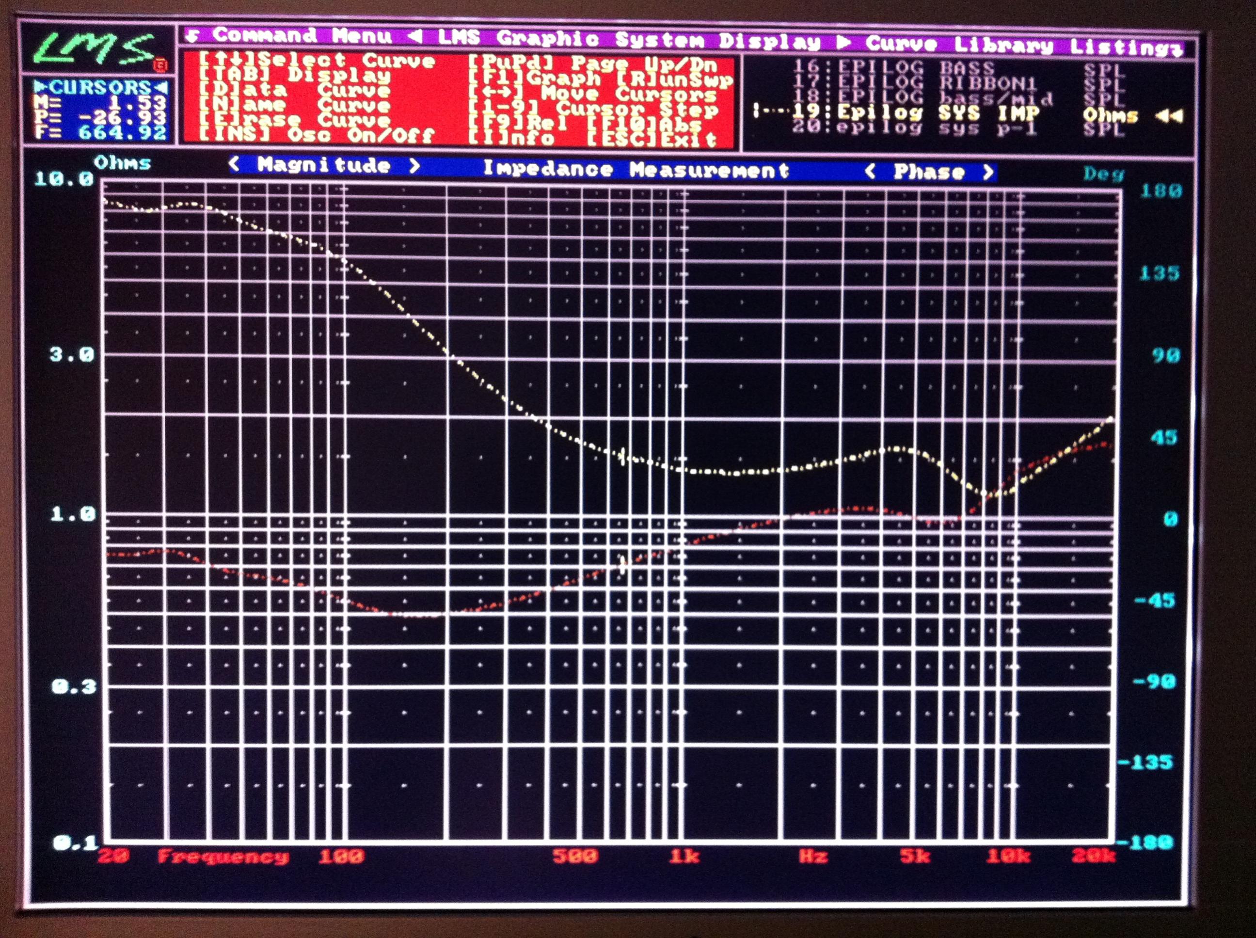

Just make sure it can drive this ......🙂
Wayne, good buddy, that's my new reference standard for evil loads. 😀 😀 😀
That's no loudspeaker, it might just as well be a welding machine. In my case, your minimum of say 1.3 Ohms is 6.5 Ohms, I quite simply do not need what you obviously need.
It will not be able to drive that loudspeaker on a continuous steady state basis; it could be done, of course, add two more pairs and watch it go, but I'd also have to beef up just abut everything, and especially heat sinking.
However, if we come back to Earth, and recognize that we simply cannot run a power amp at full rated steady state power all of the time, as we must provide at least some headroom for transients, assuming we leave just 6 dB of headroom, then it should be able to drive them, bless your cotton socks.
As for those transients, remember that the protection will stay dormant for about 40 mS, so even larger peaks can be accommodated. Meaning you wouldn't have to settle for whisper level sound only.
Where DID you find those speakers, anyway? 😎
