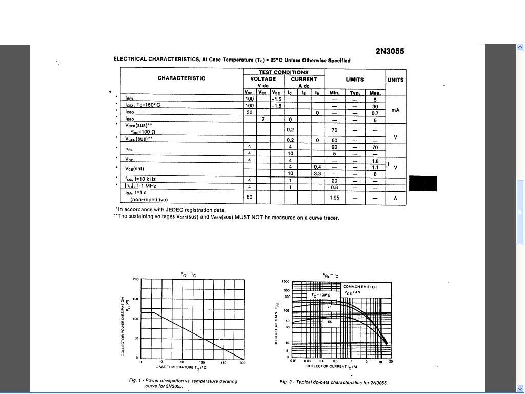

Anyone actually measure a 2N3055? The 2N3055 was a Hometaxial design. As this process is no longer used everything made today is not really designed the same. That means the transistors sold as 2N3055 now have secondary breakdown issues and higher Ft than the actual first parts.
For a while the specifications were so low by more modern standards that many manufacturers would label any parts that did not meet better spec.s as 2N3055.

hfe of 20 is fine . 2N3055 goes down to 5 at 1 ohm . Uses a 3055 to drive a 3055 if so . Gets you 25 ( use H version ) .
