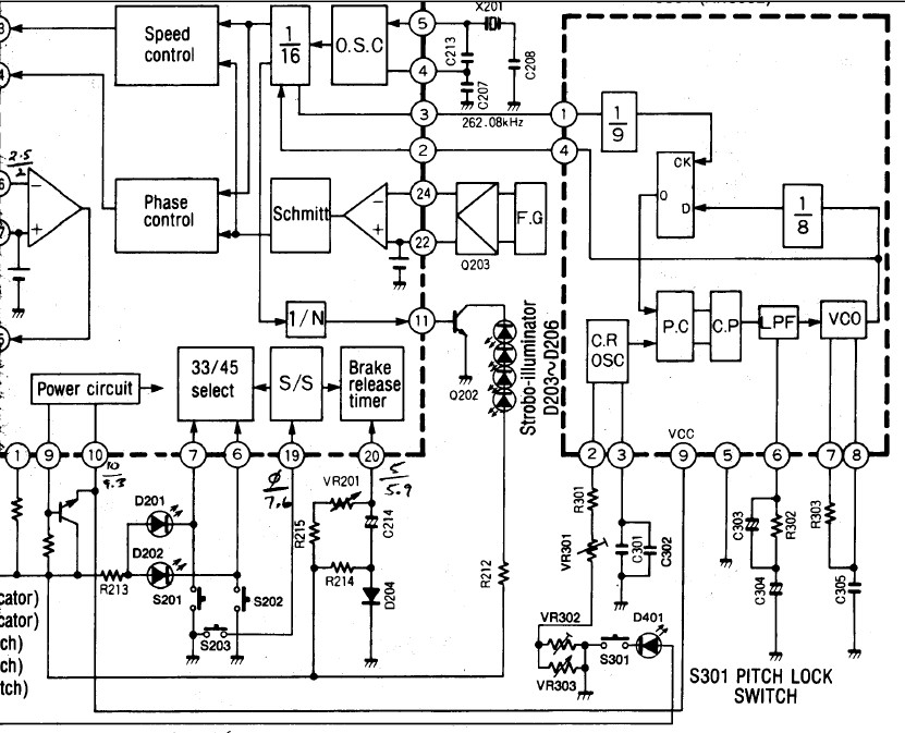

First, do these Technics turntables have Velocity or Phase lock servos?
PLL.
Second, what is the 'bandwidth' of these servos?
Exact current of charge pump is not known (tens of microamperes?), since it is Matsushita's custom IC, but externel filter components are as follows, if that helps:
C303 = 1uF
C304 = 10uF
R302 = 470 Ohm
Nothing fancy, as you can see. C304/C303 ratio is 10:1, so it is pretty much textbook design. Both capacitors are electrolytics (ouch!)
Third, how much inertia does the turntable have. Is it enough to fill in where the servos can't correct anymore?
Not enough for my taste, but opinions may vary.
