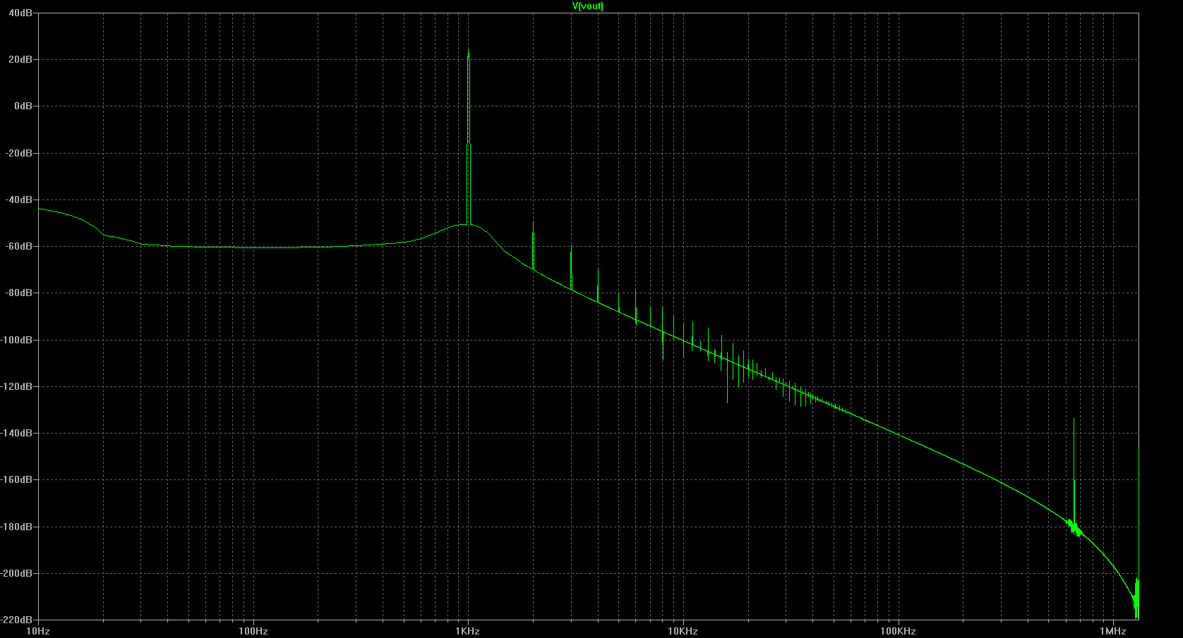

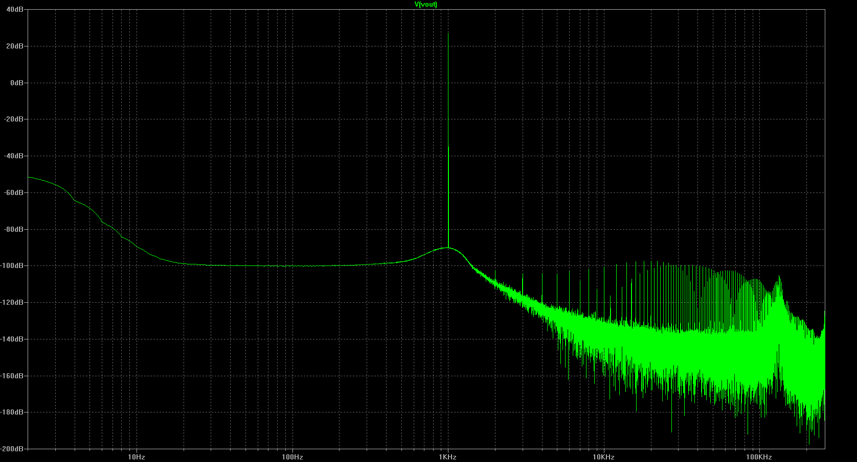

Difference in MODEL performance. What do you think this tells me with respect to my wife's critical hearing? I have not succeeded in making one behave like the other.

The next thing I noticed is how much distortion in the model the output filter causes. But, when one adds some semblance of a load, without it you get instability and other such bad things. This leads me to a couple of conclusions:
The amp and the speaker must be designed together as a system. Output filtering and compensation taken as one.
Moving to active crossovers to eliminate the inductors in the crossover may do more for the result than this week's fancy VAS.
Without seeing the Schematics I cannot comment how to change one into the other. What does interest me though, which one is it that your wife prefers? Am I correct that it is the second one?
Then something is not right. The output filter should not add distortion. If it does, it means you introduced an unfortunate interaction between it and the amplifier and load.

Yes, first amp is the modified Hafler 120, second Rotel 951. LTSpice models attached. Some liberties in devices due to limited models.
The above is purely LTSpice, not reality, and sure not using ones ears. So distortion added by an inductor is what the model does. When I model just a passive filter, I also get quite high distortion. What the model is assuming I have no idea.
