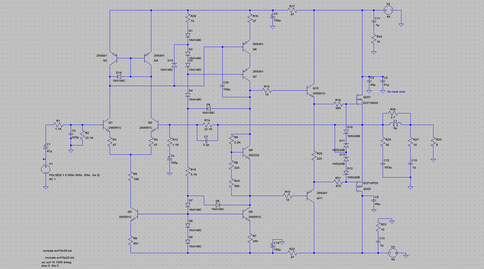

So here is the final config for the DH-120.
Have a look at this and give consideration to where the diode strings of your cascode reference terminate:
http://www.essex.ac.uk/csee/research/audio_lab/malcolmspubdocs/J10%20Enhanced%20cascode.pdf

After a week of struggling, it is now rock solid, BW of over 80K, symmetrical. So here is the final config for the DH-120.
<edit> Also Samuel Groner has things to say about current mirrors:
SG-Acoustics · Samuel Groner · Power Amplifiers
I can't help commenting ...
M. Hawksford is, in my book, an old and trusted address which has been there for a long, long time. Every time I took his word, I was better off afterwards.
I haven't read (just flipped through to discover it's worth the read) S. Groner's text, but I did catch a few interesting details even on the fly (I will read it all later on).
It constantly amazes me how some things I hold to be common knowledge have to wait for decades for the scientists to show how and why it is better than many of the rest.
Case in point - BC 550/560 trannies. They are usually used because of their nominal very low noise figure, this being the most common reason given for their existence in a circuit. However, there's a graph comparing them with Motorola's 8099 trannies, which shows that initially, the BC trannies do have a higher level of distortion than the 8099, but higher up in the range, their distortion rises much less than the 8099.
This corresponds exactly to my experience. You may have noticed that I have a sweet spot for Motorola in general, and their power devices in particular - this is true. But over the years, for reasons I can explain only as a feeling that the BC trannies "sound better overall", I have ditched the 80xx family in favor of the BC family.
That would mean little, if anything, if it was just me, but the entire circle of my friends who are into electronics did exactly the same, for more or less the same reasons - they simply sound more natural to what appers to be quite a few people.
My cascode would use BC 550/560 as the actual input pair and BC 546/556 as the "upper" pair. I was told, many years ago, by an engneer from Siemens who was in transistor manufacturing, that BC 550/560, 546/556 and 547/557 were in fact made in the same general batch, and were selected for propreties and arranged in families by sample selection later on. At the time, early 80ies, this shocked me, I suppose I expected to hear of some exotic process they used.
I had no other option available to me but a concerete, sample-by-sample try. To my surprise, I discovered that well over one half of the randomly chosen BC 550/560 population, although rated at 45V, lived on to 55V or a bit above without any particular problems. Ditto for 547/557, also rated for 45V, also do mostly fine by 55V. BTW, all were made by Siemens, I try very hard to make sure my BC family trannies all come from Siemens, having found them to be extremely reliable.
Now I am about to read appearently why my purely subjective evaluation was in fact based on hard science without my knowing it.
You really need to read the whole article and look carefully under which conditions this applies and what the surrounding circumstances are.
Then you realise that there are no "blanket" statements about transistor linearity possible.
Generally bipolar transistors when driven by high source impedances (which is the case in this circuit) are current driven, not voltage, which has a number of interesting consequences.

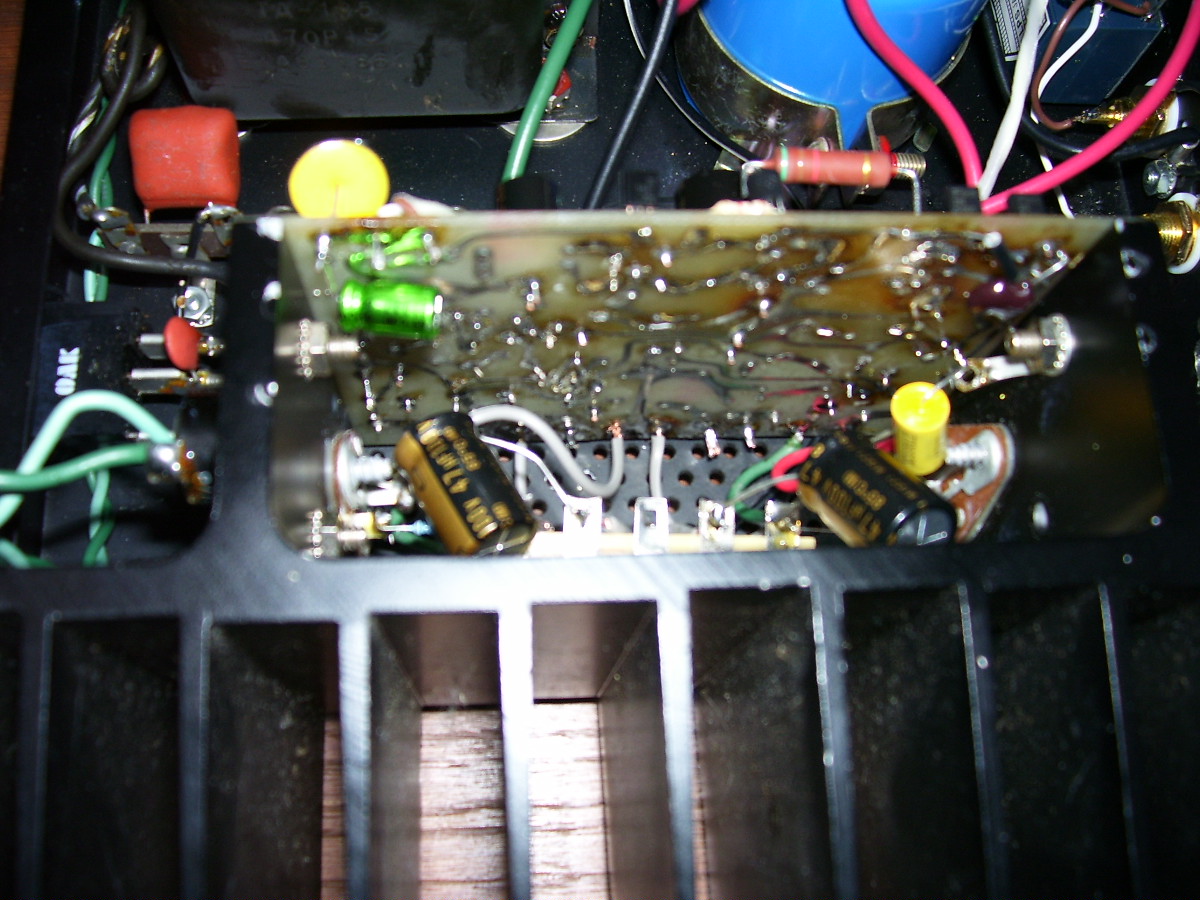

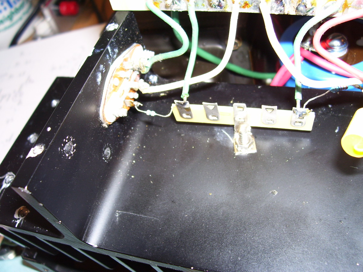

Here are a couple of pictures that show how I moved the gate resistors and added bypassing. Not "production ready" but works.
