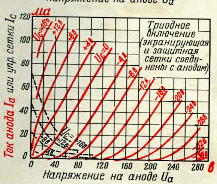

You can compare for yourself: 4P1L is better for fraction of price.

I am familiar with the curves for both tubes, personally I would not call the 4P1L more linear than the RE604, plus both sets curves are heavily averaged from large lots.
But if you like the 4P1L so much, please send me all RE604's and YO-168 you happen to have and I'll send you double the number of 4P1L's back in return and promise not to e-bay the tubes you send me.... ;-)

Sorry, I have no RE604 tubes. But I would send them to you if you love and can use them, like recently I sent to one guy on Russian forum LED indicators that he needed, and to another guy some samples of opa1612 I got from TI when they were fresh new, but never used.
