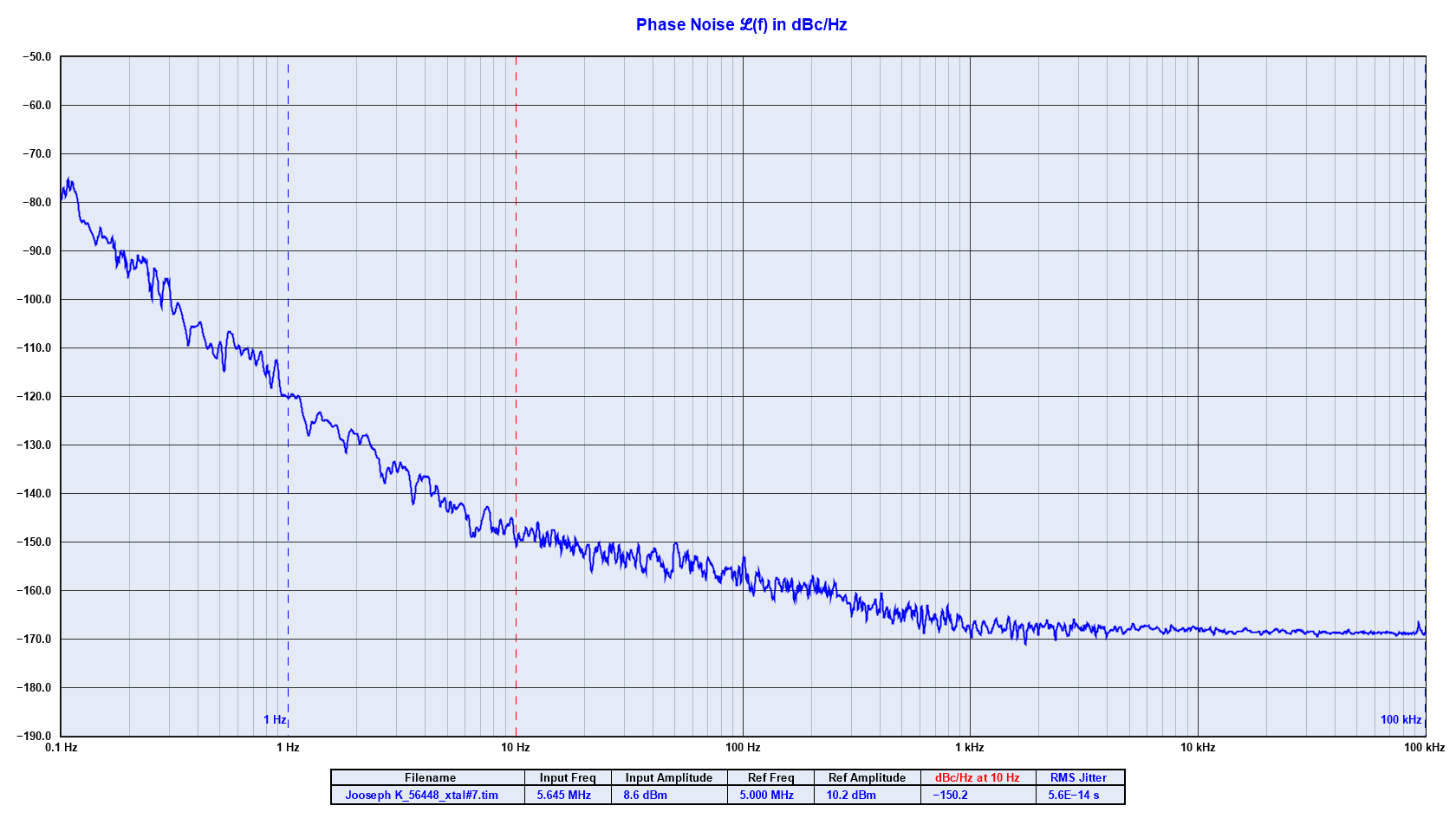

Which is exactly why I am strongly suspicious about the claimed phase noise results with Andrea's oscillators. A dangling PCB beats the space grade Wenzel oscillators. The PCB is good for audio use only, of course.

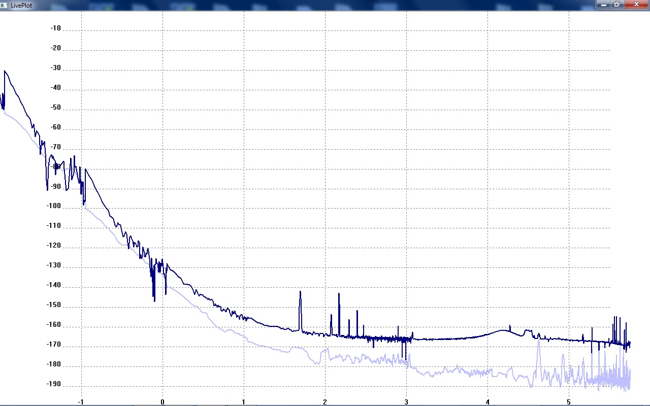

Duh.. Where to start. I had received (bought) Andrea's clock(s), and obviously had been really curious about the toughest one, the 5,6448 MHz Driscoll based oscillator with the Laptech SC-cut third overtone crystal.
So here is my measurement of it. Obviously, my tool is different from Andrea's TimePod / Microsemi box. It is a beautifully executed project by Andrew Holme, PhaseNoise
Now, obviously the problems mentioned here, about thermal stability (non existent..) of an SC-cut crystal out of it's flex zone - are real. There is a constant, slow drift during operation. This drift is worse for a measurement - a typical phase noise setup works with cross-correlation, long averaging, - it definitely works out better if the signal is not drifting too much.
Then, there is a difference between how instruments deal with it. In the Timepod, visibly it had been better elaborated this part, probably the FFT's are longer, less bin with in the lower segments..
The Holme setup had been more concentrated on high quality, ovenized crystals, so less attention had been given this type of slowly drifting carrier.
In a sense, reassuming in a word. my measurement is more 'exposed', or sensitive to this problem, and it shows.
Obviously I had wrapped the oscillator in some layer of bubble wrap. Not more has been done, apart from the long waiting for thermal stabilization.
ok, so here it is:
Thanks, about what I was expecting, nothing else to add; obviously the close-in phase noise affects the sound, while the thermal drift doesn't :rofl:. So much about "the best on the market, competing with Wenzel".
Product buyers, don't forget to wrap your oscillator in layers of bubble wrap, allow a couple of hours warming up before listening to music, and don't forget to suspend it by some rubber strands, to eliminate the earth crust vibrations.
