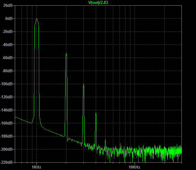

.... How much H2 as predistortion depends heavily on the driver being used, many found somewhere between 0.1 to 0.9 % to be optimum, perhaps 2-4% would be too much for the majority of drivers....
Pre-distorsion is a concept of injecting the anti-phase of a functions inherent distorsion to reduce/null said inherent distorsion on its output. You seem to describe it as an icing of a cake which is it not.
I don't know about injecting either. But fets and triodes in SE do have some H2 with some topology showing relatively high H2/H3 ratio.

It is something I am trying to make sense. You seem to know more about it than I do. Anything you can share?
This is not a new concept and is used atm in some commercial offers in loudspeakers.
The idea is neat and smart the real world application of it not as easy as it seems: you have to try to solve a non dynamic behavior for it to work and as we know not all distortions are linear or have a 'predictable' behavior...
That said it is used by Presonus in it's Sceptre range of coax loudspeakers ( with horn, Altec style rather than Tannoy style) to counteract the issues related to the horn diffraction ( the original algorythm come from Fulcrum Acoustic own research on coax and is licenced to Presonus). It works nice but the issue's behavior is more or less fixed and somewhat predictable ( at least it was managable to measure it's effects and then make a 'profile' from them) .
