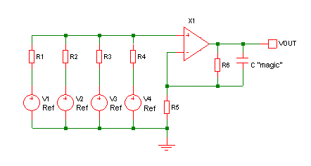

Getting back to SY's idea of using multiple Vrefs to get lower noise, it seems to me there's another way to do this. If the references are connected in parallel, instead of in series, then you get the desired noise reduction even in a voltage regulator with Thorsten's "magic cap" reducing the AC gain to unity.
E.g. The circuit below should be 6dB quieter than if a single reference were used, assuming the opamp and averaging resistors don't add too much noise themselves.
