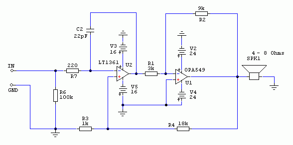

I used OPA549 as an audio amp too, in Nelson's Super Symmetry topology. That's the only AB class amp that I kept and still listen to occasionally - it regularly surpasses the expectations.
Here is the sch. (small error - 220p caps should be 5-10 times smaller)

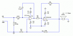

Hi Juma!
1) Could you explain why feedback capacitor (220p) should be 5-10 times smaller? Will 200p cap attenuate signal at higher frequencies?
2) Question about the amp based on Walt Jung's paper on composite amplifiers
Could it possible to increase R1 to 3.32 kOhm. Firstly, I have a this value on hand in contradistinction to 3k. Secondly, is it OK to increase R1 so that LT1361 will amplify voltage, and OPA549 will amplify current?

Hi Juma!
1) ...Will 200p cap attenuate signal at higher frequencies?
2) ...Could it possible to increase R1 to 3.32 kOhm. Firstly, I have a this value on hand in contradistinction to 3k. Secondly, is it OK to increase R1 so that LT1361 will amplify voltage, and OPA549 will amplify current?
1) Yes
2) it's OK to make R1=3k3 and R2=10k so that in total gain LT1361 contributes with gain of about 6 and OPA549 with gain of 3. If you use OPA549 with unity gain (current only) the output power will be lower since LT1361 works with maximal supply voltage of +/-18V and OPA549 can go up to +/-30V.
