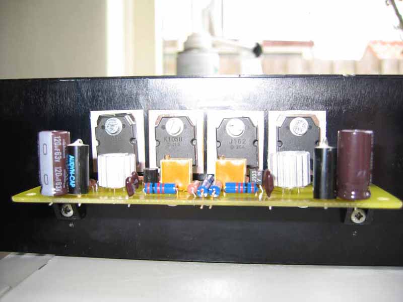

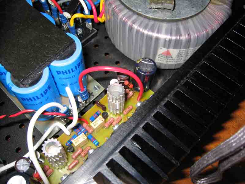

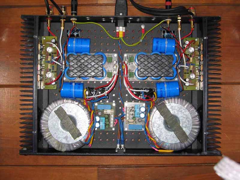

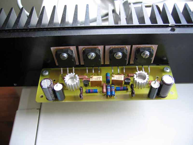

Some time ago I started a thread inquiring about Zenquito evolution. It resulted in me deciding to build one and promising to report my findings.
Well the amp is finished now. I can only compare the sound against my old amp, Elektor's IGBT-amp (nonante in French). I had hoped that Zenquito would be a worthwhile upgrade because I had read a lot of positive things about the amp, mostly in a French forum.
In comparison, Zenquito sounds less dynamic, less transparent and somewhat muddy in the midrange. And completely flat soundstage.
In another thread someone compared the sound of amps with muddy ponds and crystal clear mountain lakes. Zenquito obviously is of the former type. I'm sure it can sound good to some, but not to me. It has no special timbre of emotional engagement at all. To me it just sounds uninteresting.
In short: I don't like the amp. I really don't understand why people like this amp. I hope that someone can explain what it is he likes about the sound, I'm very interested.
Perhaps there is something wrong of course. I attached some pictures. If anyone can come up with improvements or sees any mistakes I may have made, please let me know.

Hi Choky,
Do you think it would matter. I compared both amps in exactly the same setup. Are there any known issues with Zenquito that makes the amp sensitive for speaker load?
Anyway here it goes:

Even though I have never built the Zenquito, I believe that the
speaker does matter, and so is pre-amp. This amplifier reminds
me of some MOSFET amps I have ever built including the Crescendo.
What you have described was just the "signature" of MOSFET amps
running in class B and with relatively short path (amplification
stage). I have heard that this amp is only a little better than
the crescendo (but that's just somebody's opinion).
Assumming that this amp is similar with those MOSFET amps, especially
the crescendo, you need at least 8" woofer of Peerless quality, or
a floorstander. 3-way is better, may be because the amp is not good
at mid (muddy).
MOSFET usually have low transconductance. I believe this makes it
dificult to match with many speakers to get an interesting sound.
And of course, you cannot compare such amps with Alephs. May be
MOSFET is good only in class A???

ABO,
There are a couple of ways to improve the sound of Zenquito. One is to run yhe front end off it's own bridge rectifier and possibly regulate it and the other option is to increase the bias.

Thanks for your reactions.
Till,
I haven't read the datasheet for any power opamps, but usually the THD+N vs. power plot has a bath tub shape. In the lower power region the values is determined by noise and HD is neglectable. As output power rises the contribution of noise decreases, but HD rises. There is a optimum somewhere between in the 1-10 W region, then HD rises more than noise falls and THD+N is rising again.
At least this is my conclusion from these graphs. It seems that S/N ratio of your amp is just better than most chipamps, not HD.
Jam,
thanks for your suggestions. I did try a low-pass filter between PSU and input and VAs stages (10 ohm / 1000 uF), see picture. The sound seemed to clear up entirely. Bass seems tighter, soundstage much more transperant and less muddyness.
However there still seems to something wrong. I can't put my finger on it yet. Perhaps it's what Jocko says about current feedback: it just don't sound right.
You said you liked Zenquito. Difficult perhaps, but can you tell what is was you liked? What is the amps strongest point?

Hi JFG,
According to the designers, the IGBT-amp is one of their best sounding amps! It is true however that is is notoriously unstable, both electrically and thermally.
You are also quite right about my grounding scheme. I've started another thread about that, and I think I have it sorted now:
http://www.diyaudio.com/forums/showthread.php?s=&threadid=35973
Changing grounding scheme is an improvement. But the real bang comes from some modifications that Jam and I are working out. I can now say that, with minor effort, this amp can be great. The improvement is so big and the mods are so simple that I cannot understand why Plantefeve didn't do this himself.

To ABO : This amp must have big distortion on high frequencies, 'cos current in VAS / driver stage is too low and OLG is low too. Only what you can do with this connection is, that you must get out driver from PCB and replace it by another type with higher Pc, which you must get on main heatsink. Certainly you must get there resistors with lower value to the emitors of VAS. But don't wait, that sound will be dramaticaly upgraded 😉 , circuit with this concepcion is not quite correct 😎 .
Hi Epupa,
I have indeed some problem with that. Because of thermal problems (VAS transistor ran too hot) I decreased bias to 9 mA. The VAS stage by design has bias current of some 10 mA. This is low indeed. On the other hand, the input capacitance of the lateral mosfets (2sk1058/2SJ162) is also very low. Using another VAS transistor should allow for larger current. Do you have any suggestions?
Changing the VAS' emitter resistance is tricky. It increases open-loop gain and could compromise stability. The same may go for changing the transistor, because it determines the dominant pole.
Unfortunately, I don't have a scope and signal generator or any other faciltities other than my DMM. So I'm not in for real serious changes to the circuit.
Hmm, I should have kept my job as a design engineer
Easy way for replacemet is MJE 340 / 350. Yes, with lower resistors rise gain, but it is,what you need - but do it without scope is it suicide 😉 . But some of your friends have it, or no ? Input capacity of two fets is app. 1200 pF ( n ch ), respectively 1800 pF ( p ch ) and it is not so little.
Hi Epupa,
I'm afraid I don't have any friends with even the slightest interest in electronics or audio. I can sometimes use some equipment of our local univeristy. But only on occasion.
I took a look at another amps:
Elektor crescendo ME: vas-bias 35 mA, inputcap of mosfets 1700 pF
Zenquito: VAS bias 10 mA, input cap. 1200 pF
Indeed VAS bias is somewhat low. OTOH, input capacitance is a more linear. At 20 kHz the reactance of 1200 pF is some 6600 ohms. This cannot be neglected at all. I think that improvement can be made here.
Now I really wished I had more facilities. I can't see myself experimenting with other transistors and emitter resistances with only a DMM.
