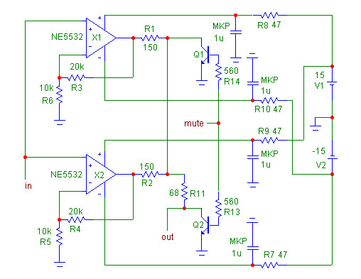

Here is the schematic, followed all the tracks on the double layer pcb
😕 Why do they take the feedback before the 150ohm resistors ?
😕 Better remove the muting circuit ?
😕 Better remove the 47ohm resistors on the power supply pins ?

the 150ohm resistors are summing resistors. They are there to even out any minor differences between the two amps / gain resistor networks so you don't end up in a situation where one opamp is driving the other like crazy.
You can eliminate the muting circuit if you don't need it.
the 47ohm resistors are for decoupling. yes, you can take them out.

Parallel anything (tube, fet,opamp) sounds different than single. There is often loss of immediacy and focus but there are also some virtues. Many believe that the negative effects can be minimised by precise matching of gain - the resistors in your case.
A commercial product should be able to drive a wide variety of loads - if it sounds better to you single that's how you should set it.
Of course it will sound better without the mute.

I once did a THD simulation with parallel opamps driving an output stage, there was no virtue as far as I can remember.
One reason why 2 units of 5532's are used could possibly be to supply more drive current for headphones.
mcp said:One reason why 2 units of 5532's are used could possibly be to supply more drive current for headphones.
You're certainly right.
This opamp can (only) output 38mA
The 150ohm resistors are for current limiting when 8ohm headphones are used.
IMHO they used 1 pair of 5532 for channel separation, and as they had 2 for each channel they used them.
38 ma is the short circuit current. I doubt that the 5532 is able to drive this amount of current without significant distortion. The 150 ohms resistors have probably both purposes (isolation between the 2 x 5532 outputs and for current limiting (with the 68 ohms).
If the goal of paralleling 2 x 5532 is to increase the current available, then it is not the virtue that I would be looking for!
Isn't it better to use a discrete transistor class A amp to allow enough current?
Is there another virtue of parallel op-amps for the sound reproduction?
