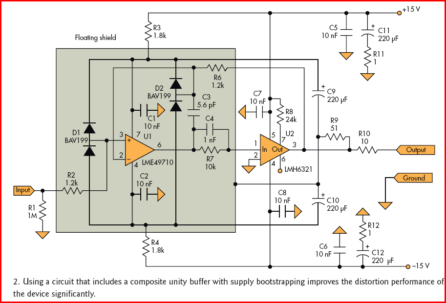

There is something else you can do that I never see mentioned on this forum, or anywhere else for that matter, that makes a significant inprovement. Maybe more than the O/P biasing. It has to do with common mode distortion - and I am not going to say anything more than that..
then I suppose you really don't want anyone looking at my http://www.diyaudio.com/forums/solid-state/45794-high-loop-gain-composite-op-amp-circuits.html
or to look up Jung's substrate bootstrap, or Dimitiri's
Supply Bootstrapping Reduces Distortion In Op-Amp Circuits | New operational amplifiers optimized for high-performance audio and ultrasound applications combine extremely low total harmonic distortion plus noise (THD+N), -130 dB, with large output vo

Jung's toying with Otala inspired inner loop feedback is ill advised in my opinion (really only in one instance - he has generally advocated several "multiloop"/composite amplifier topologies)
his use of gain in the output op amp of a multiloop/composite amp allows sub regulating the input op amp supplies - since the input op amp has little dynamic current demand even simple Zener shunt gives good regulation
the psrr is then boosted by both the excess loop gain and the subregulation
to address common mode input distortions I was pointing to the Sandman "feedforwad" as one example of power supply bootstrapping
the feedforward bootstrap can improve cm distortion if the bootstrapping amp is good - say a cascoded fet - and the main amp adds gain, possibly better noise (Funasaka used a discrete fet ps buffer amp) AES E-Library Feed Forward Floating Power Supply (High Response-Speed Equalizer Circuit)
Dimitri's floating ps bootstrap circuit does even better in that the composite amp input sees only the bootstrapped U1 input - effectively "cascoding" the entire input op amp
