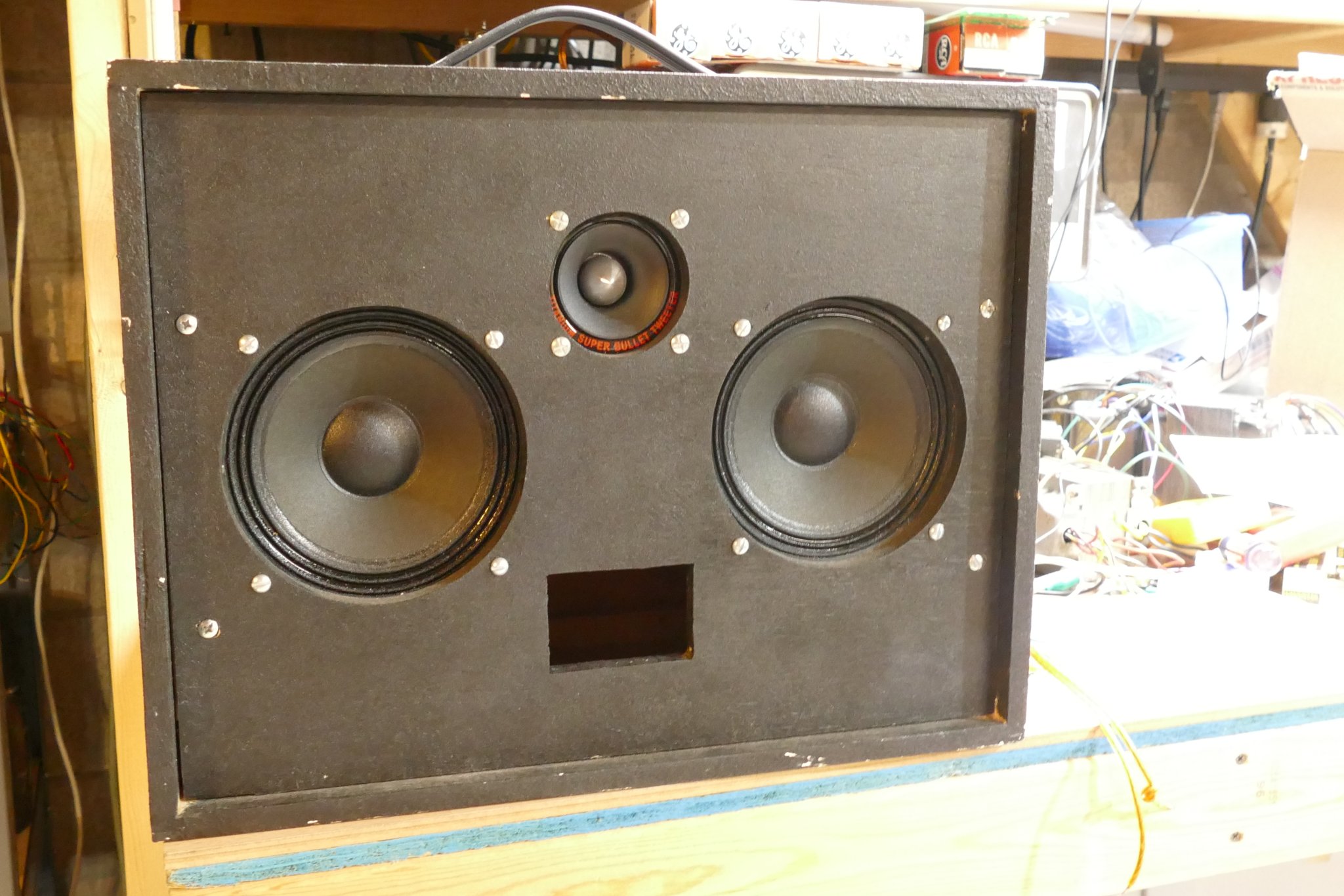

Ten to 12 years ago I decided to make a pair of cheap speaker cabinets with no plan or real idea of what I was doing. I had a pile of (too thin) scrap wood left over from some real projects and one 4 hour time slot in a high school woodworking class. I bought four cheap 6 inch Pro Audio drivers from Parts Express and also got a pair of cheap "bullet tweeters" as an afterthought. The cabinets are about 1.6 cubic foot with a simple 2 X 3 inch hole in the front for a port. One of the speaker cabinet simulators pit this combination at an F3 of around 70 Hz with reasonable flatness. I have been pleasantly surprised by their performance and they have been used for lots of "testing" for 10+ years. They can be seen and "heard" here:
So, my question is, " If I stuff a wad of paper towels in the port, connect the cabinet to a 100+ watt amp, plug in a bass guitar, and simple slap the strings downward towards the pickup while lightly muting them to create a pseudo bass drum thud, why does the paper towel wind up on the floor a couple feet in front of the cabinet." This action causes the speaker cones to travel inward, away from the listener. Reversing the polarity deposits the paper inside the cabinet. Clearly some air is being moved in sufficient quantity to launch a paper towel.

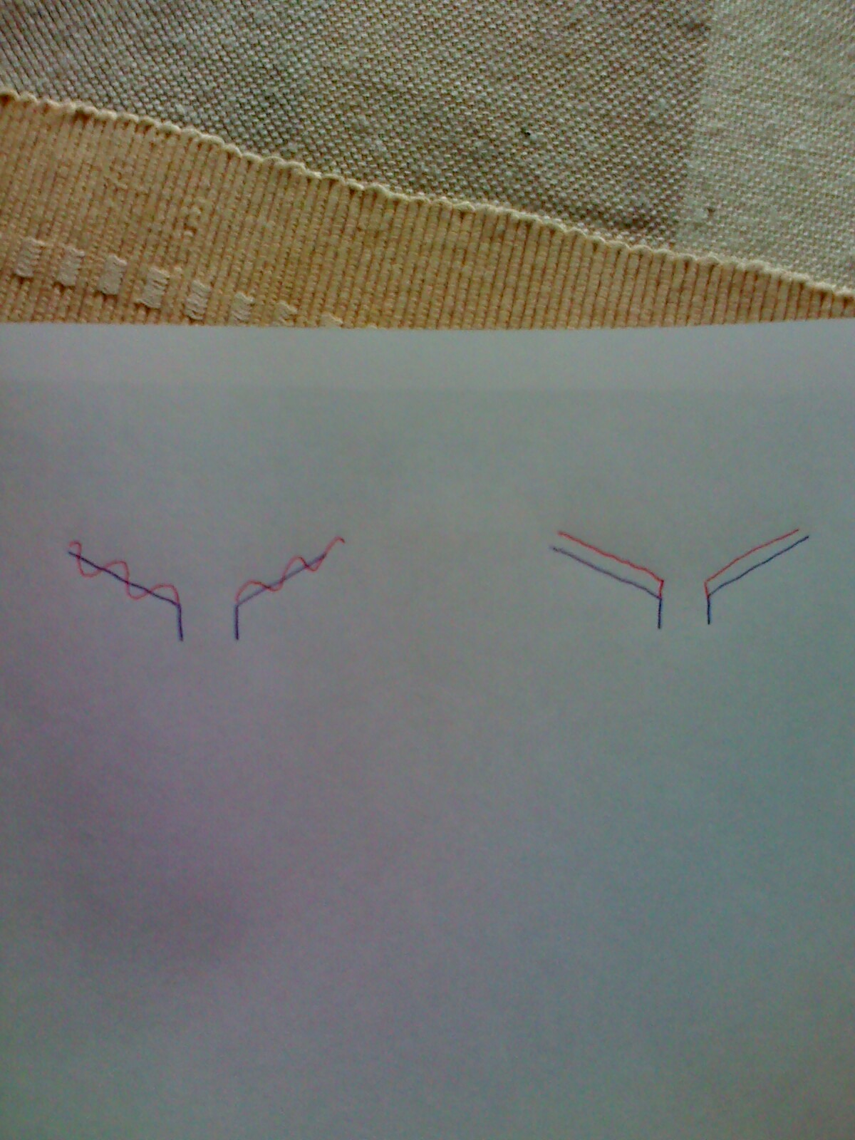

If the Princeton Kids had also dealt with kettledrum, for example, they would have published a more comprehensive article. But in the hi-fi field, we can simply look at the phenomenon of sound transmission using the example of a loudspeaker diaphragm and cabinet. A diaphragm functions both as a "bending wave", not exerting pressure, and as a piston, exerting pressure. The eardrum also functions in the same way: both as a bending wave and as a piston. Diaphragm size, diaphragm structure, diaphragm material, mass/rigidity ratio and other factors determine whether it is a bending wave or a piston.
And if we place a loudspeaker in a room, it also generates pressure when the diaphragma as piston moves, which pressurizes the entire room and transfers this pressure to the eardrum. But not in high frequency ranges.
Like this;-?
