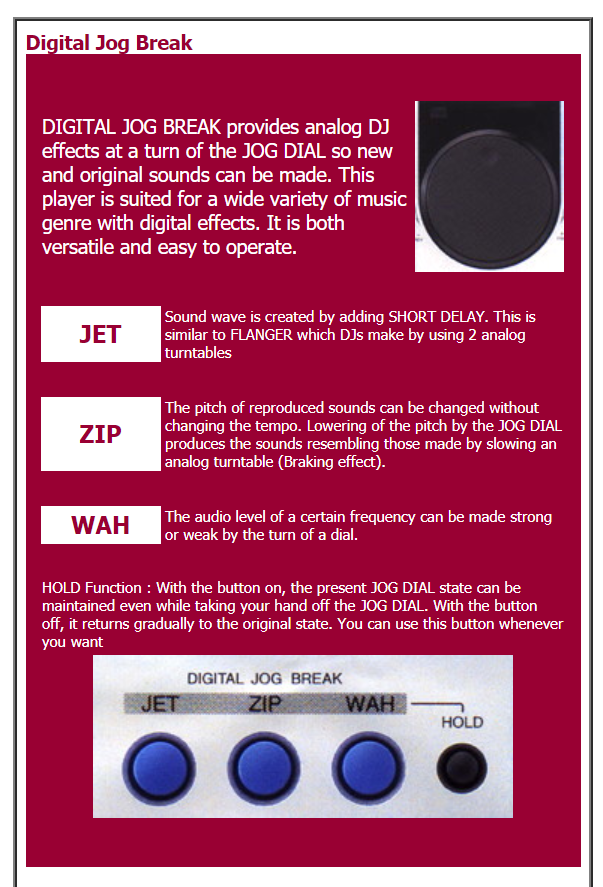

Hi
Do you know about any (cheapo...) kits/schematics/projects for a standalone sound-effects for DJ'ing?
Modern DJ-consoles and CD-players often contain effects like "jet, Wah" Ect..
Please see the attached for details on the effects on the CDJ100 from Pioneer.
I suspect that a single standalone chip can do it all?
Kind regards TroelsM

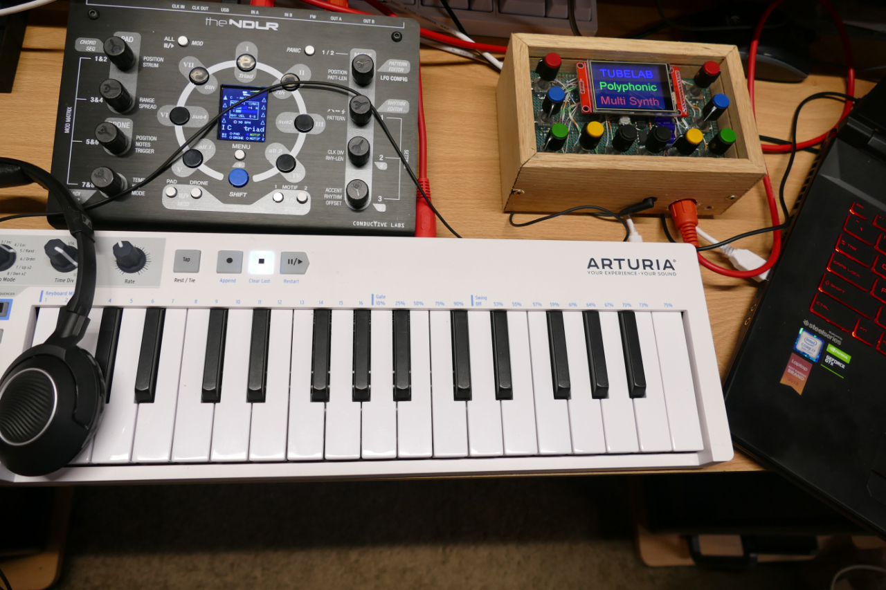

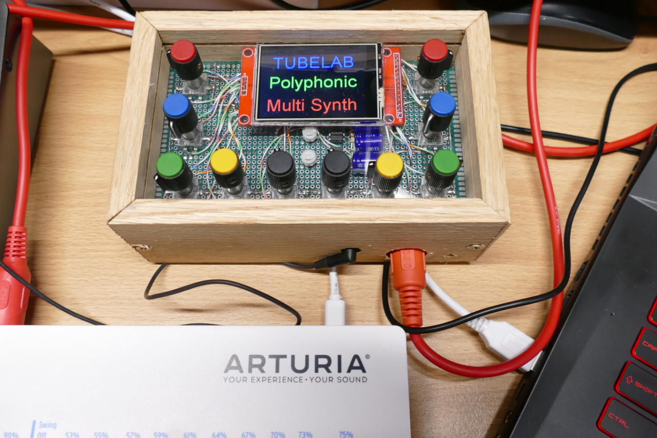

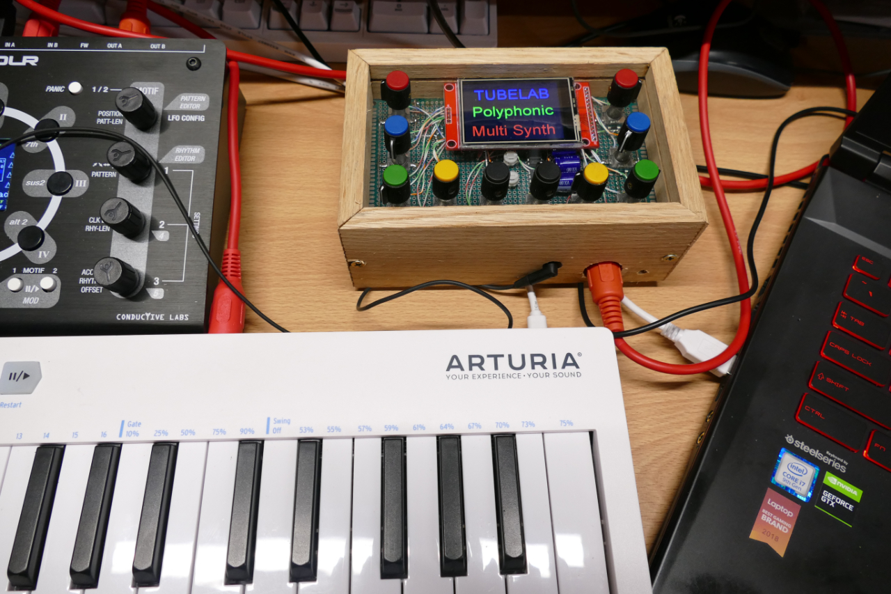

Here are some pictures of the micro synth. It's really just a Teensy 4.1 board connected to 10 rotary encoders, a small color touch screen, a MIDI in jack, and a PT8211 stereo DAC chip that feeds a pair of LM386 chip amps. I'm still experimenting with the code, but it is now running a 6 note poly synth on one MIDI in channel, and a 6 note poly K-S synth on another. This uses about 10% of the CPU power, so there will be a few more synths added as I get the code working.
The NDLR seen in the pictures is a polyphonic MIDI pattern generator / sequencer sold by Conductive Labs. It is also Teensy based.

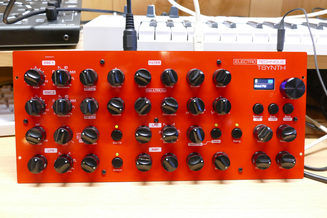

I recently stumbled across a Teensy powered poly synth on Youtube. I bought one of the board sets and built it. Yet another cool toy to play with.
ElectroTechnique TSynth - Teensy 4.1 based DIY Synthesizer - YouTube
I am including a picture. I haven't built a case for it yet. Still too cold and snowy for some table saw time outside.

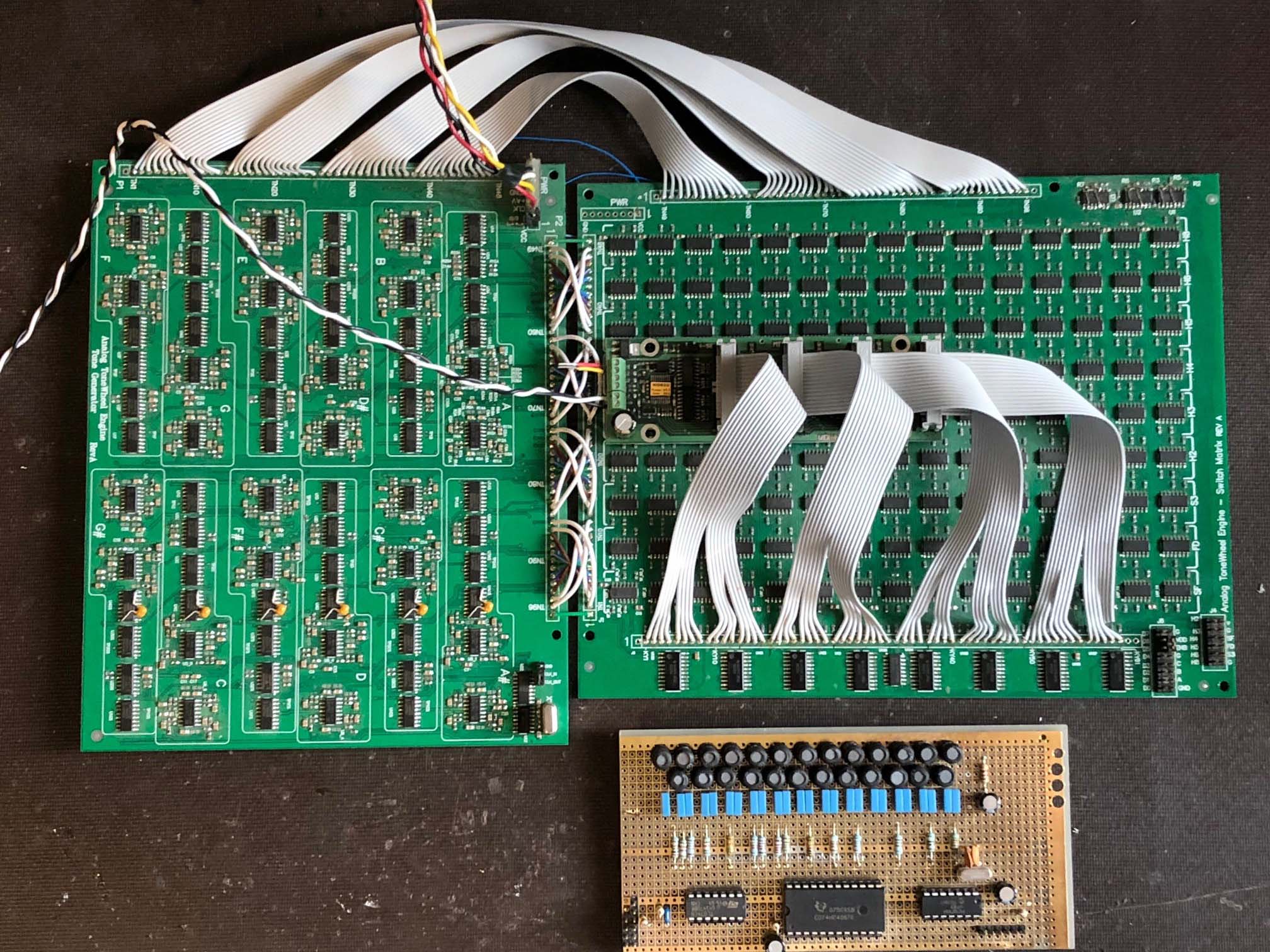

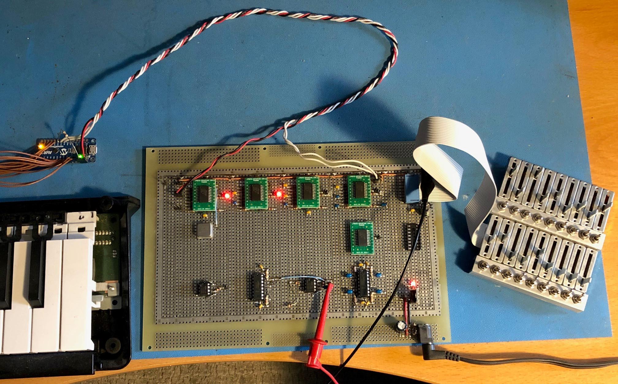

Clearly we are kindred spirits in our "synth follies!" I have always been fascinated with Hammond organs (I have an A100 in my basement - too bad I can't play). I thought that the world needed a clonewheel that was not just software running on a fast processor, and that was "as analog as possible". The first pic below is folly #1. The left board is the tone generator. I used frequency multipliers and dividers to exactly replicate the Hammond tonewheel gear trains, then filtered them to 96 sine waves. They go to the switch matrix, consisting of 96x9 analog switches that couple each key to the nine harmonic drawbar busses. A Midi decoder generates the key presses. The proto board on the bottom accurately replicates the Hammond chorus/vibrato by electronically (rather than mechanically) scanning a 25-stage LC delay line. It uses a PIC to generate PWMs and analog switches to do the scanning of the LCs. It all sounded really good, but it was wildly impractical. (Think of all the unique Rs and Cs in 96 separate 3rd-order filters.) Besides, all-digital clonewheels have gotten too good to compete with.
Folly #2 is also Hammond inspired, but not meant to be a clone. It is officially a "hybrid paraphonic additive synth". It uses one ATtiny416 processor for each voice, in this case four-way polyphony. Each processor generates the nine harmonics of a single note. Each output is a pulse-density modulated sine wave signal that is summed with the corresponding harmonic of the other processors and RC filtered to nine analog signals. The slider pots control the summing of the drawbar signals to a single output. A fifth processor scans the keyboard and does the "note allocation" to the four voice chips. More chips can be added to make it N-way polyphonic. The plan then was to use yet another processor to generate control PWMs to VCAs to create note-on "percussion" and chorus/vibrato dynamic effects (the "paraphonic" part). Why the ATtiny chips? Because they are simple, fast, and cheap (<$0.90 apiece) - perfect for bit-banging.
That multi-oscillator drone synth stuff is way too weird for me. Is seems more "performance art noise" than instrument or music effect.
The Teensy products and tools are really interesting. I never played with Arduino - it is amazing how much hardware and software "infrastructure" has been developed. But as you can guess from the above, I am much more of a "bare metal" kind of guy. I consider complicated IDEs, libraries, middleware, peripheral drivers, nested include files, and other levels of indirection and abstraction to be a decent into "IT hell". Also, I am leery of the 16-bit analog interface for music effects. The 24-bit stereo codec on the Daisy would be at least comparable to what we have in the FV-1.

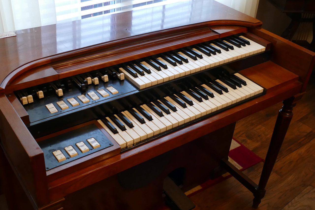

About three years ago my wife and I were wandering through a Goodwill store in Pittsburgh, and there it was. The manager said that is was non functional and being sold as furniture. He said that the power cord had been cut off to prevent use. One of the workers said otherwise. Against my wife's wishes, I brought it home. Now I need to figure out how to move the 250 pound M3 down into the basement. It is from 1958 and still works great.

OMG, you got a functional (and very nice cosmetic condition) M3 for $39 in 2021? cool synth DY development stories between you 2 by the way.
