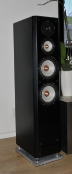

Hi all,
My Emotion speakers (image nicked from the interwebs, but mines are identical) just got a new paint job after almost 20 years of children's abuse :p. I dismantled them beforehand. After putting 'em back together left and right speaker sound rather different. Left is (overly) bright but open. Right is laid back but (a bit) muffled. Used a TEAC amp with low, mid and high controls to check differences, and it's mainly the mids that differ.
Attached pictures show frequency analysis (mono-channel, 1m from floor; 1m from speaker; 30 sec. Norah Jones song). Can anyone give a hint what could have gone wrong. My suspicion is that I put back the damping material differently.
Thanx,
Adam.

It is hard to tell differences by using a recording as a reference (they do differ in the contenet of the channels after all).
The biggest difference I see is in the mid-high crossover area. Are you sure that you reconnected all drivers with correct polarity ?

The charts are both from the left channel of the CD, and fed into both speakers (one after the other of course). I will check polarity as per your suggestion. A real pain to dismantle 'em again however.

Pink noise (or a proper mls or sweep) would be best. Also you should really move the speakers so that both measurements are with the speaker and mic in exactly the same spot.
If you get a program like audacity you should be able to create a pink noise file of arbitrary length and burn it to a CD if hooking the computer up is not an option :)

I used Audacity to produce the Freq. picts. Will try some 'real' measurements (square, sine, sweep, pink noise) anyway before taking the speakers apart.
The reason I asked the forum for input is that I HEAR something is wrong. Measurements probably only aid in pinpointing the culprit. Well actually I hoped someone would say "without a doubt it's ... that's causing this" ;-).

If you have indeed wired up one of the drivers out of phase, a proper frequency sweep or pink noise test should show it up pretty clearly :) you should see quite a suckout around one of the crossover points! My first ever acoustic measurement (which was done with a very poor quality computer mic) made it very clear I had my mid's wired the wrong way around!!
