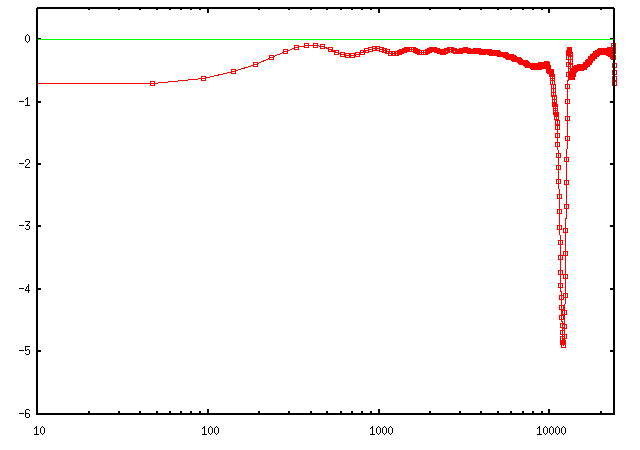

I just used the TSP (time stretched pulse) technique to measure the transfer function of an external Sound Blaster Audigy NX2 sound board. See how ugly! 🙂 there is a hole around 10kHz. Lucky I barely listen that high 😉

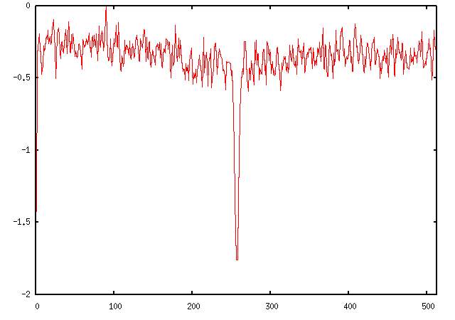

Since you guys seem to like this old-fashioned noise stuff, here is the result of a measurement using white gaussian noise!...
Yes, it seems the gap is still there... Tough it looks more narrow and smaller. But I would bet this is due the imperfection of using noise. TSP is much nicer! 😀
I don't know what can be wrong in this board. I probably should tear it up and see if there aren't any strange capacitances. :smash::smash::smash:

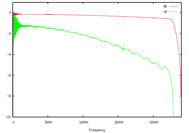

Well, this time I used just a single jack-RCA cable, and a small RCA-jack conversor.
The ripples in the previous graph are because that plot was from the DFT of the truncated impulse response.
This plot here is truncating the impulse response after much more samples. This is not "realistic", but gets a better estimate of the true transfer function... Has to do with handling noise, and stuff, I don't know exactly.
If you consider all samples, your transfer function looks noisy. If you cut it short, you get that ripples. This image here was from a response truncated at around 1900 samples. The original TSP I used had 2**12 (4k) samples, so this is like an intermediary choice... There is a little noise in the low frequencies, but the ripple from the truncation is very weak.
There is still a little ripple in the estimated TF tough, and now I'm inclined to believe that this is a true ripple from the board's filters. The green curve is the same one in "centibels".
Does anybody know what kind of filter should I expect? I could believe this is a 15-order Chebyshev, but I don't have experience with such large order analog filters... Is this feasible?
