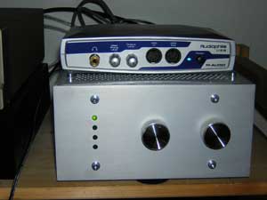

I can see many pople here advocating for the M-Audio stuff. I have owned a Audiophile USB from M-Audio for about 10 months now and are very pleased with it's performance. Basicly it's a USB version of their 24/96 card. I think it's a good thing that the 'card' has its own seperate PSU (E-core trafo) instead of using the computer SMPS. Also, it uses ASIO drivers, thus avoiding the windows mixer. Good thing too, you don't have to run the audio in long cables or have to have the computer next to the stereo.
I couldn't resist opening it to check out whats inside. This is what I found:
S/PDIF Tranciever chip: CS8427 96kHz
DAC/ADC : AKM AK4528, 24 Bit 96Khz
USB Streaming controller: TI TUSB3200 codec / I2S interface
OPAMP’s used: 5532
It looks like it would be possible to tweak this little box. There is no integrated multfunction chip here, all seperate chips, and the datasheet can be found at their respective manufacturers hp. The opamps could easily be changed to something better, possible a clock upgrade too. The I2S could be taken directly for a total DAC upgrade later....
The little box is lookin good on top of my gainclone too.😎
