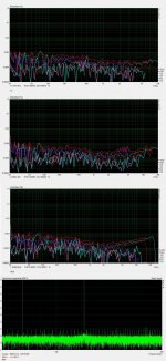

I've got an ST, the PCI version of the ST and can attest to it's quality. I have no problem giving it a firm recommendation.
The only limitation is the bandwidth, it goes up to around 50k, but no higher, regardless of if you're using 192khz, this does, as you can see with the 192khz distortion plot, limit how far the harmonics will extend. This however is it's only real flaw.

Thank you, this is helpful. Do you have any picture with closed loop?
I'm afraid I don't understand what you're asking here.😕

I meant output connected to input to see the actual card S/N, THD+N and spectrum. I am not sure if those pictures you posted are just for unconnected input & output.I'm afraid I don't understand what you're asking here.😕

Yes these are the output fed directly into the input, otherwise there's be nothing to measure and nothing to measure with.
