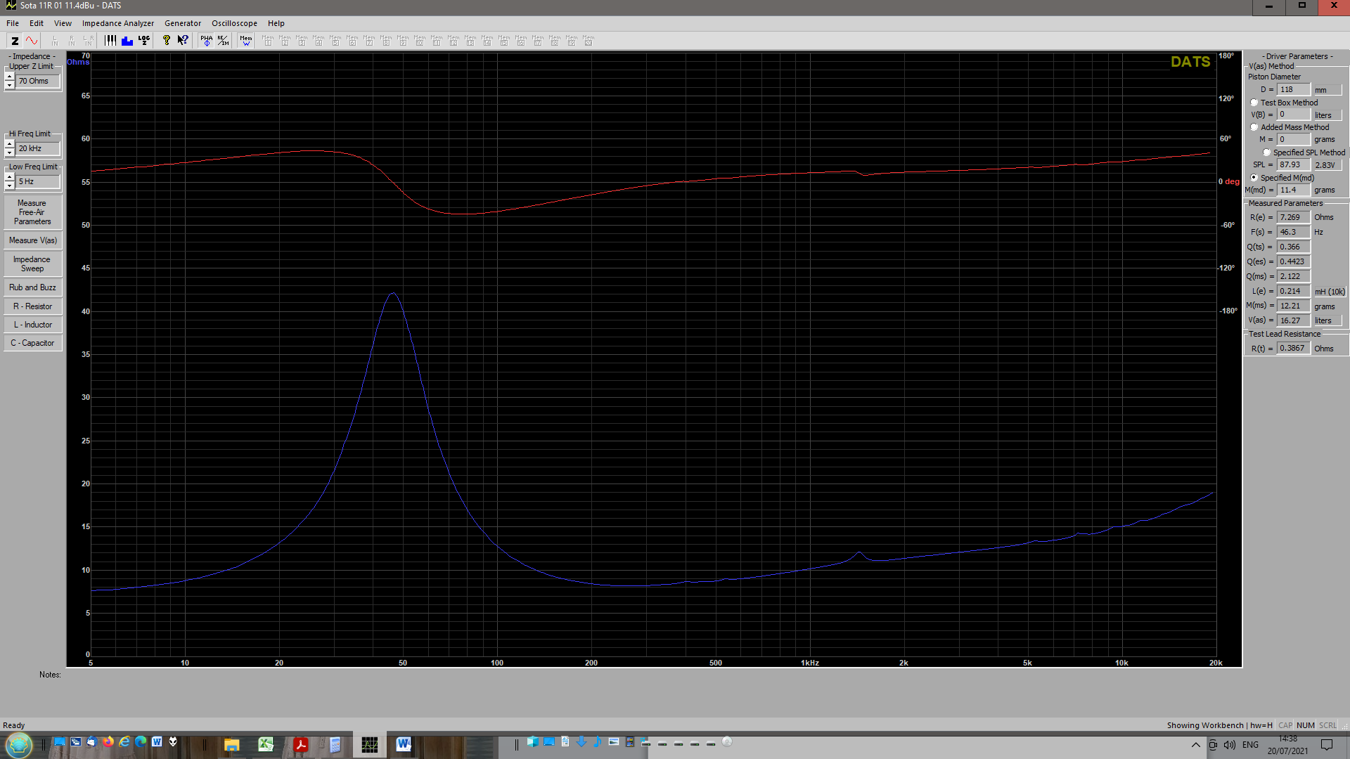

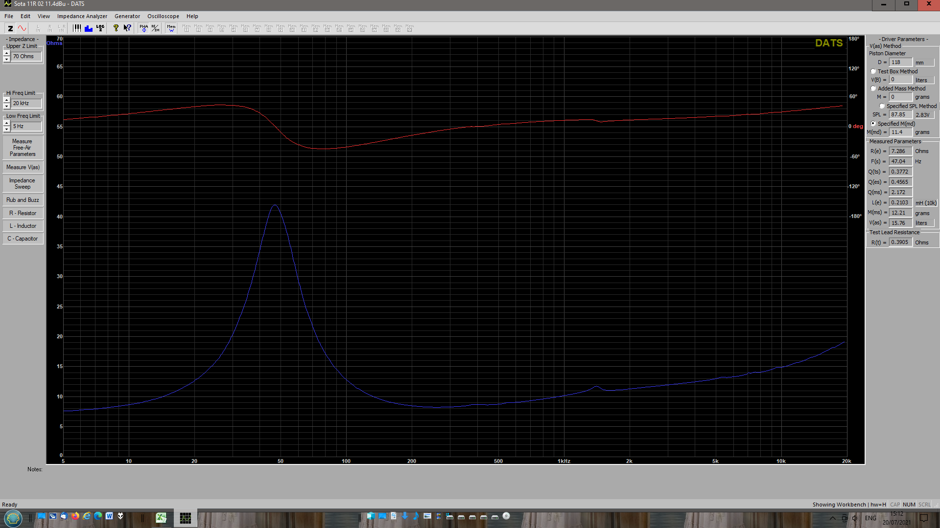

A big thank you to ScottMoose aka Dr Scott Lindgren for making these measurements from my drivers. I hope these will help all those who purchased the Sota 11R drivers
Markaudio Sota 11R
Extended T/S data
Dayton Audio DATS V2/3
Free air measurement
Nominal drive level 11.4dBu
Calibrated test lead resistance: 0.3867 ohms
Known Mmd Vas derivation
Driver 01:
Sd = 109.36 cm^2
Re = 7.269 ohms
Zmax = 42.14 ohms
Fs = 46.296 Hz
Mmd = 11.4 grams
Mms = 12.209 grams
Qes = 0.44227
Qms = 2.1217
Qts = 0.366
B*L = 7.64 N/Amp
Vas = 16.266 litres
Cms = 0.968 mm/N
SPL = 87.931 dB 1m/2.83v
SPL = 87.515dB 1m/w
Xmax = 14mm P2P
Wright Parameters (corrected):
K(r) = 4.1128
X(r) = 0.10585
K(i) = 0.0028368
X(i) = 0.71245
Rub and Buzz Test values:
Test Signal level -40dB to nominal
Fs deviation tolerance +/- 10%
Z(max) tolerance: +/- 50%
Fs deviation = 4.8%
Z(max) deviation = 2.2%
Driver 02:
Sd = 109.36 cm^2
Re = 7.2855 ohms
Zmax = 41.952 ohms
Fs = 47.037 Hz
Mmd = 11.4 grams
Mms = 12.206 grams
Qes = 0.45645
Qms = 2.1719
Qts = 0.37718
B*L = 7.5879 N/Amp
Vas = 15.757 litres
Cms = 0.938 mm/N
SPL = 87.853 dB 1m/2.83v
SPL = 87.447 db 1m/w
Xmax = 14mm P2P
K(r) = 4.5117
X(r) = 0.096537
K(i) = 0.0021903
X(i) = 0.73709
Fs deviation = 1.4%
Z(max) deviation = 2.8

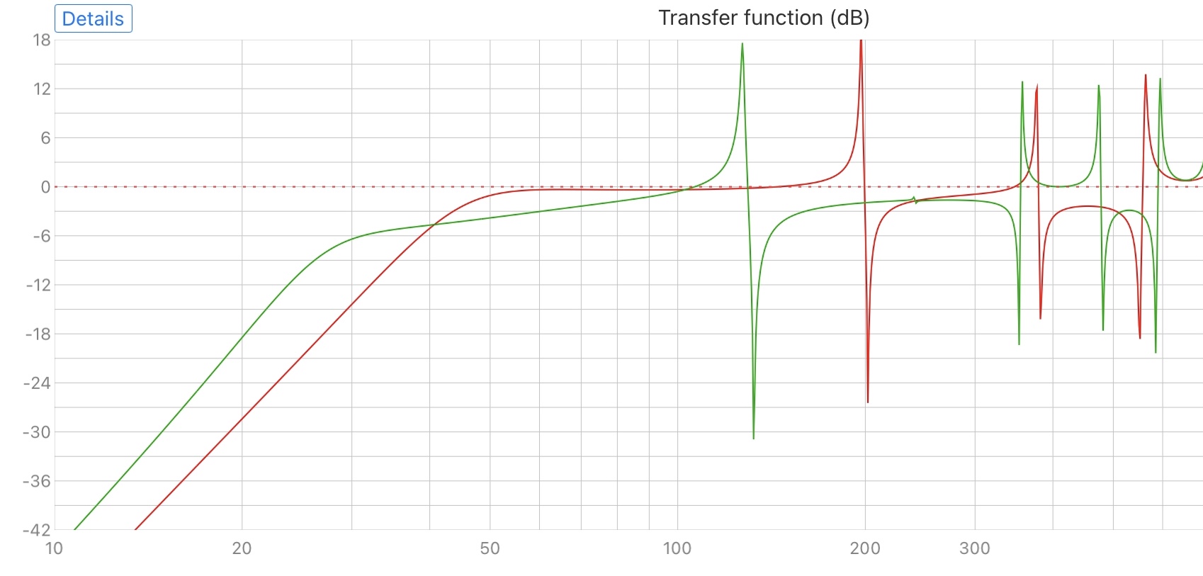

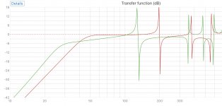

Tha last image is from two separate cabinets:
Red trace is optimised for flat alignment from a 12.5l box with the port tuned to 50.4hz producing 39hz at -6db and 32hz at -12db
Green trace is a somewhat EBS alignment from a 16.4l box with the port tuned to 35hz producing 31hz at -6db and 24hz at -12db but I think the driver would probably blow before you hit that with any volume

DATS runs a low voltage drive. This is six of one, half-a-dozen of the other since Small specified what have become T/S parameters should be measured at low voltage. In and of themselves, as a piece of mathematics that makes sense. However, many manufactures for better or worse measure at higher voltage drives since they regard them as more representative of typical use. The pair of 11R were a good pair match, and the impedance curve indicates good damping of the TL modes for a unit of its size. Under higher voltage drives, I'd expect Fs & Qt to drop, and Vas to rise a little.
