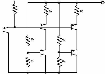

I suspect that 5 parallel is more than enough without series, but I'd go through the process of drawing that load line with scale factor 1/5 instead of 1/2 anyway.
What I meant to suggest from the Bryston schematics isn't the tricky NPN+PNP per side output stage but the voltage divider thing they use in their higher output amps, would be something like this if translated to Darlington:
You have to tell us, when it's done!

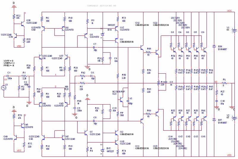

Without having done any calculations, looks reasonable.
Just a couple questions/comments:
1) What is the purpose of the 100 Ohm resistors in series with the bases of the input diffpairs?
2) Same question about the 10 Ohm resistors in series with the bases of Q22/Q23?
3) Are the Miller caps really big enough at only 10 pF?
4) What is the purpose of C6/R42?
5) I would be inclined to go for a longer time constant than 1k / 330 uF for the DC feedback.
6) I can't really read it, but is the cap across the Vbe multipler only 100 pF? I'd be inclined to make it bigger (100 nF at least) if so...
7) The currents in the input diffpairs are biased with a strong negative tempco, so the gain in the input stage will be rather temperature dependent, it will drop at high temp. Probably OK if the enclosure keeps things cool ...
8) Are you planning to include some protection circuitry, to sense overcurrent and / or power supply faults, and reduce output drive, [ or just live dangerously
To mirlo
Thanks for your time
1) Saw it on an other amp (Pure and simpel 1 :-/ )
2) Current feedback to the predrivers for stability
3) I'm still working on that, I have simulated it, and the open loop gain and fase of the output is ok. The fase never gets above 90 degrees (Is it here ok to let it go to just under 180 degrees ???)
4) To reduce gain at high freq (still working on the feedback system).
5) Why ? the timeconstant sets the lowerfreq cutoff to about 10 Hz
6) the signal does not go through this cap since the amp isrunning a "positive and negative side"
7)I have the current generator it's in the upper and lower right corner
8) Planning protection...don't know what yet
\Jens
\Jens
