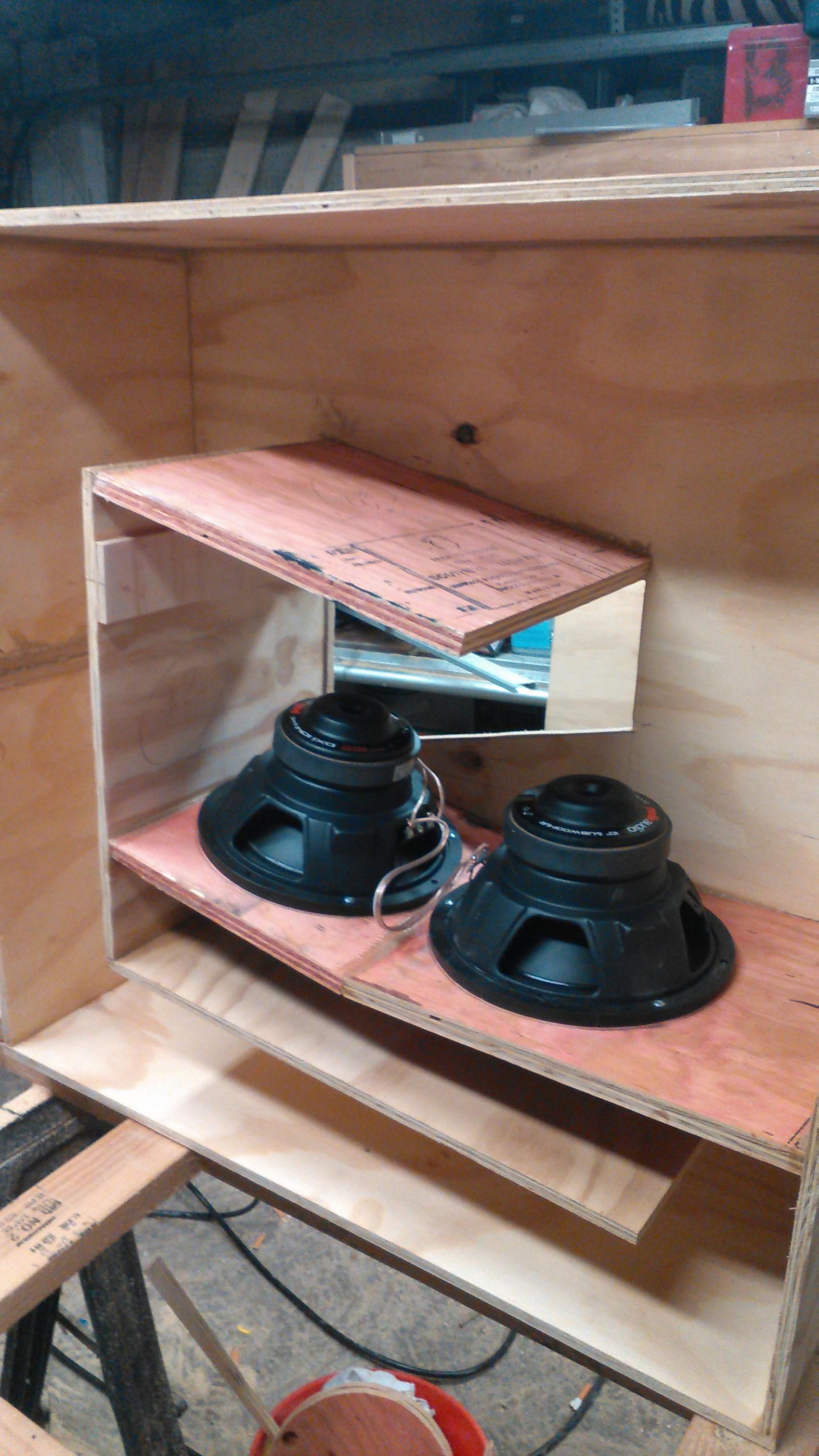

How did you model this/come up with this design?
Design a box for two subs in a ported box, make a box to those specs and add a U slot for the 2 PP drivers?

You have to take into account the space the slot takes up inside the box and increase the overall dimensions accordingly, so that the volume of air inside the box remains the required/desired volume for the drivers / the tuning of the box.
You also need to consider cone excursion (so the 'in' driver cone doesn't smack into the 'out' driver magnet because it's too close at full excursion) and whether you're going to fit the drivers into the box before sealing it or after sealing it (if the latter, you need port width to be wide enough to let you get the 'out' driver past the surround of the 'in' driver, and give space for screwing it in).

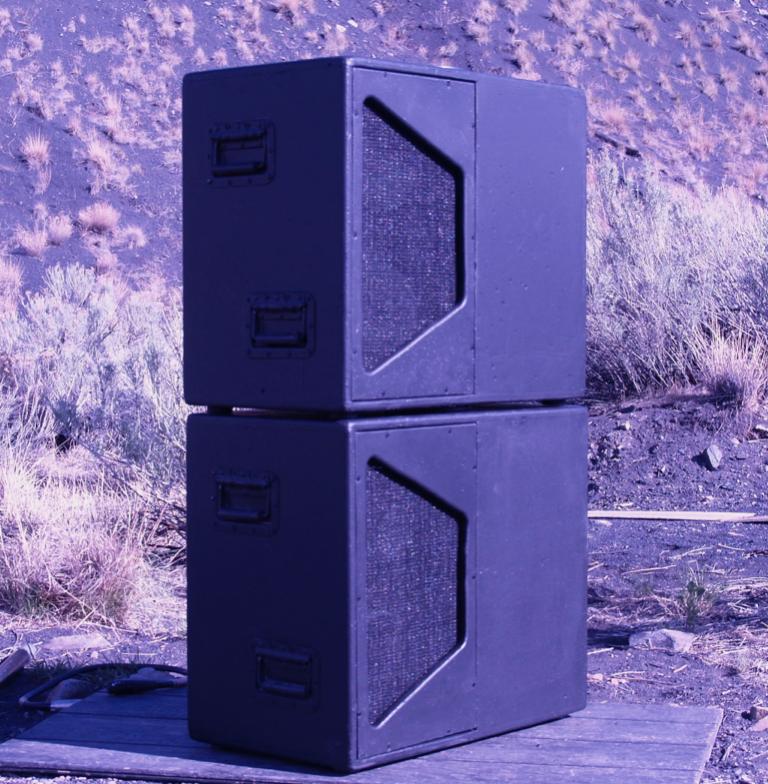

Just recalled a 22.5" x 22.5" x 15" "smallish Keystone" 2x10" experiment from 2011. .
Banging response from Eminence Kappa Pro-10A (only 3.2mm Xmax, really a mid-bass driver).
The drummer that bought them liked them better than the larger (26.5" x22.5" x 22.5") LAB 2x12 BR which went a full octave lower, but were not quite as loud (and far less distorted)- the 2x10" had more "chest thump". I was glad to sell them, win/win
