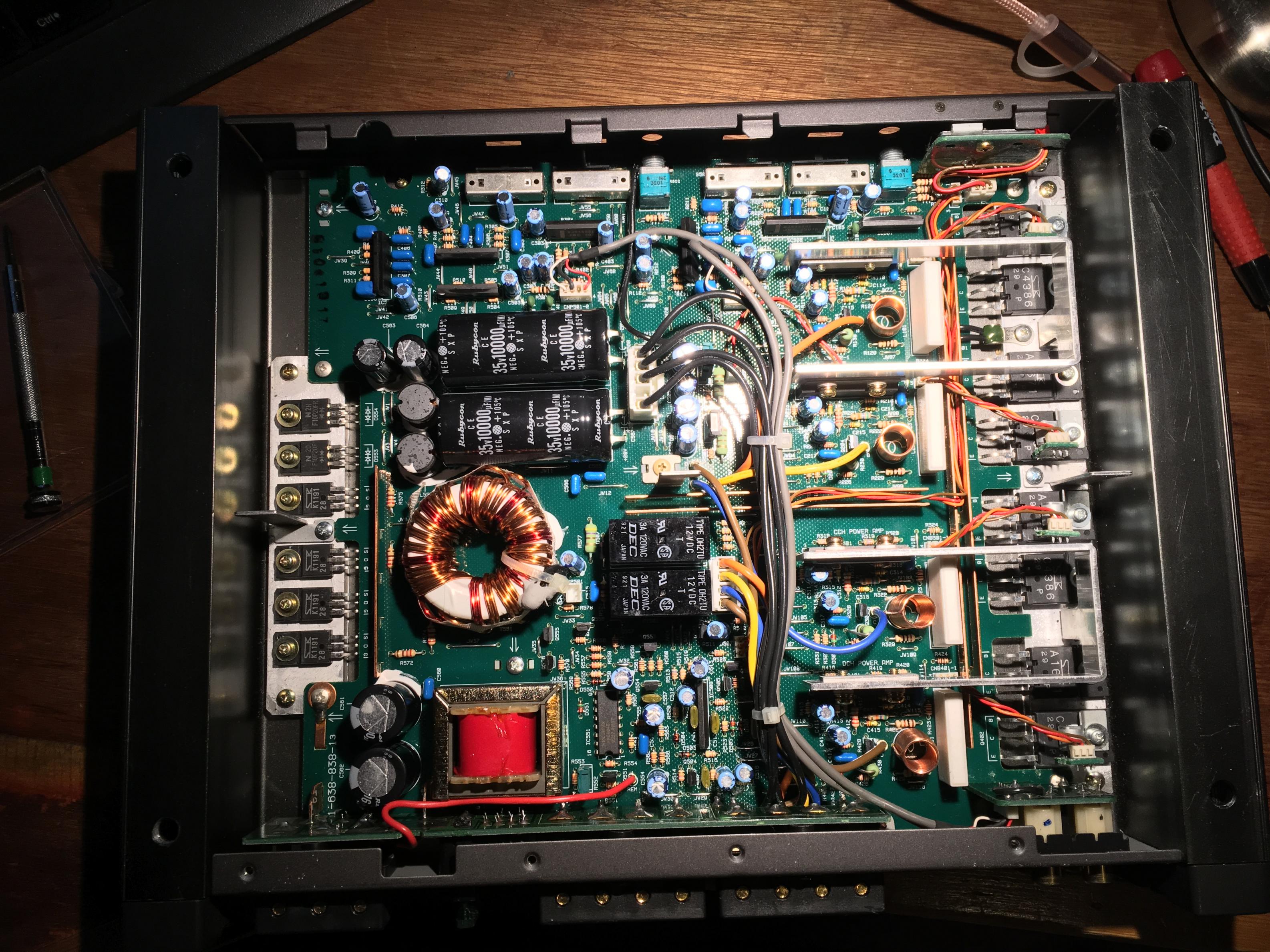

As above gents, I’ve found of these amplifier that is hopefully buggered.
Class A/B so I should have a basic familiarity with the general design, any unobtainable parts or pitfalls to be aware of?
Looking at that general design (very similar to Alpine), the relays and emitter resistors develop bad solder connections. The relays also fail due to dirty/burned contacts.
