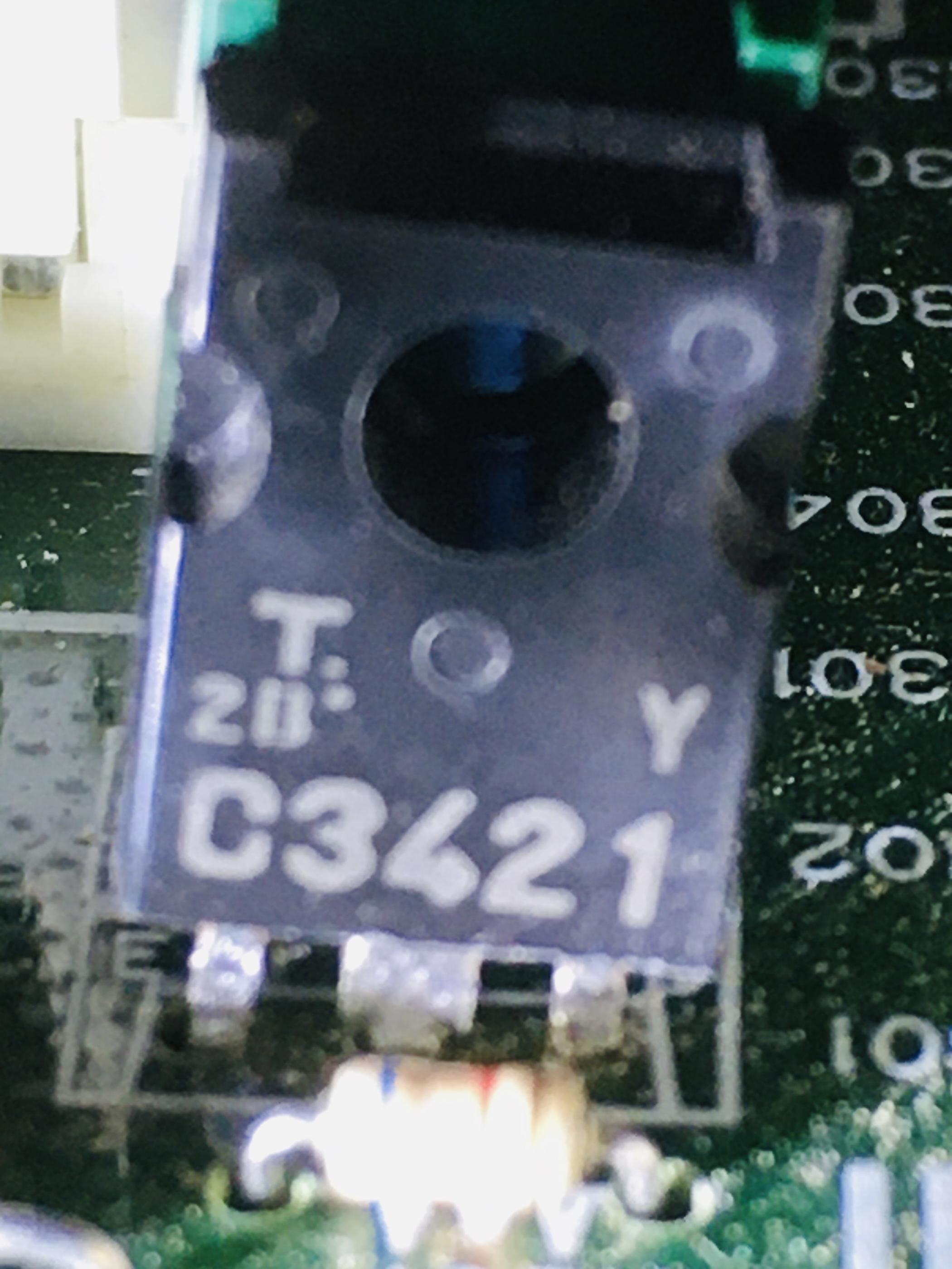

Cannot find replacement 2SC3421-Y with 2B on it. They sell the 2SC3421-Y and 2SA1358-y in pairs so they mist be common and should replace both?

The diode is shorted. The transistors may be OK.

The diodes in the regulator circuit are D301, D302. It's a 15v, 1/2w Zener diode.

With the information you provided, that's the only part that I see that failed.
You can remove and check the regulator transistors for open junctions, shorts and leakage but they're likely OK.
If you want to order replacements, the KSA1220 and the KSC2690 will work.
Replaced the diode with no success, went back removed and tested the transistors. Q302 was open so replaced Q301, 302 and the amp works perfectly.
