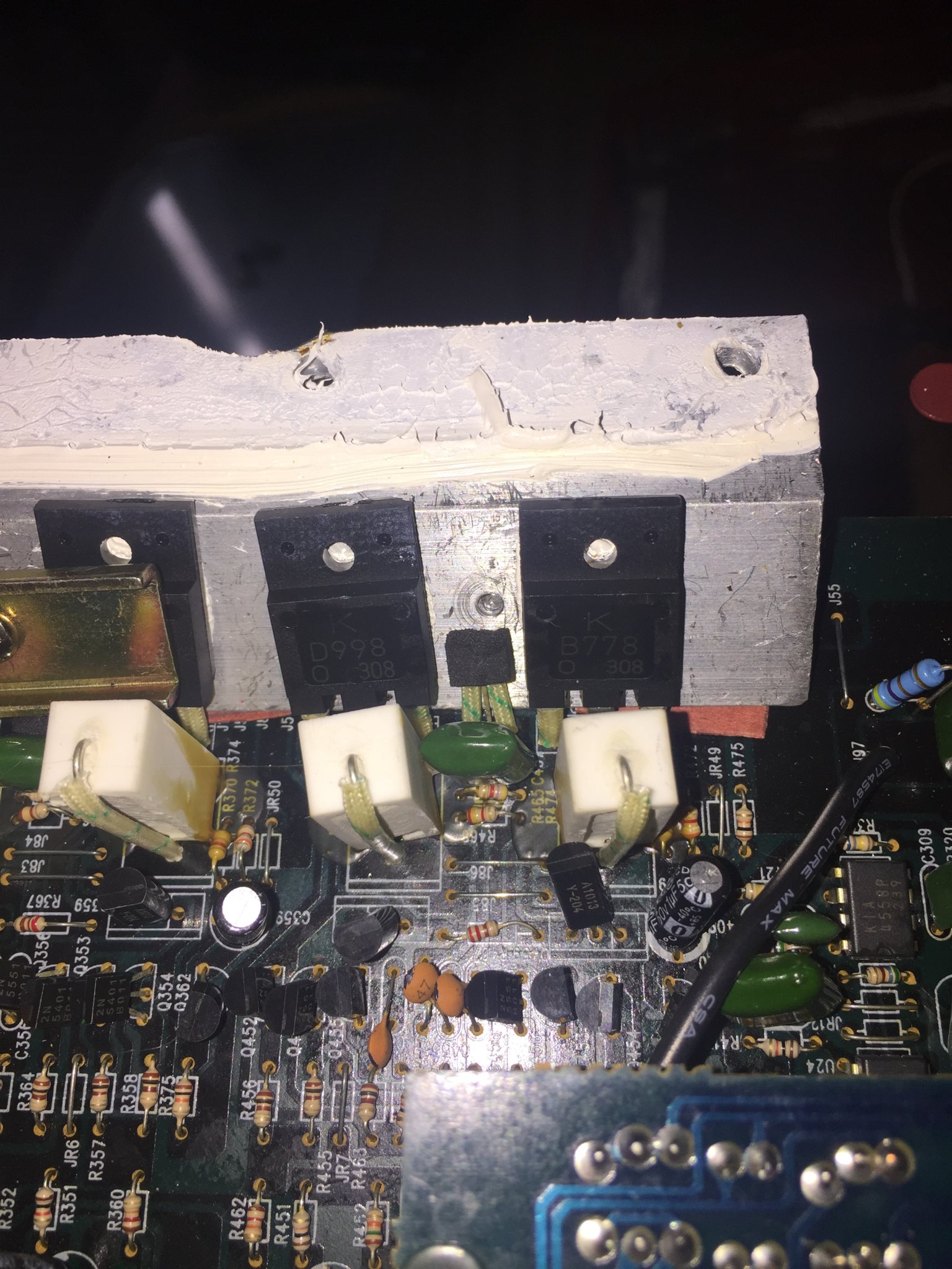

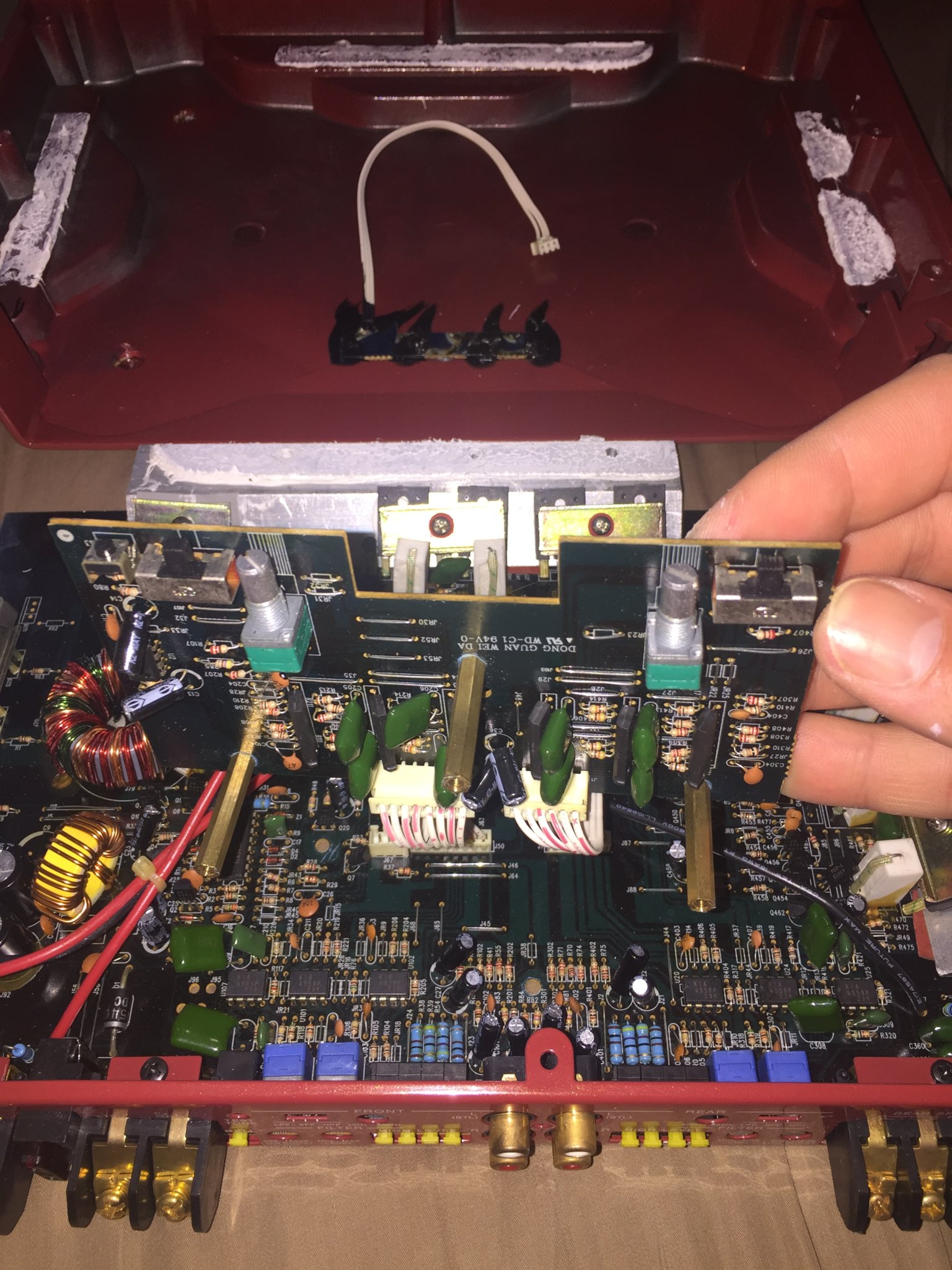

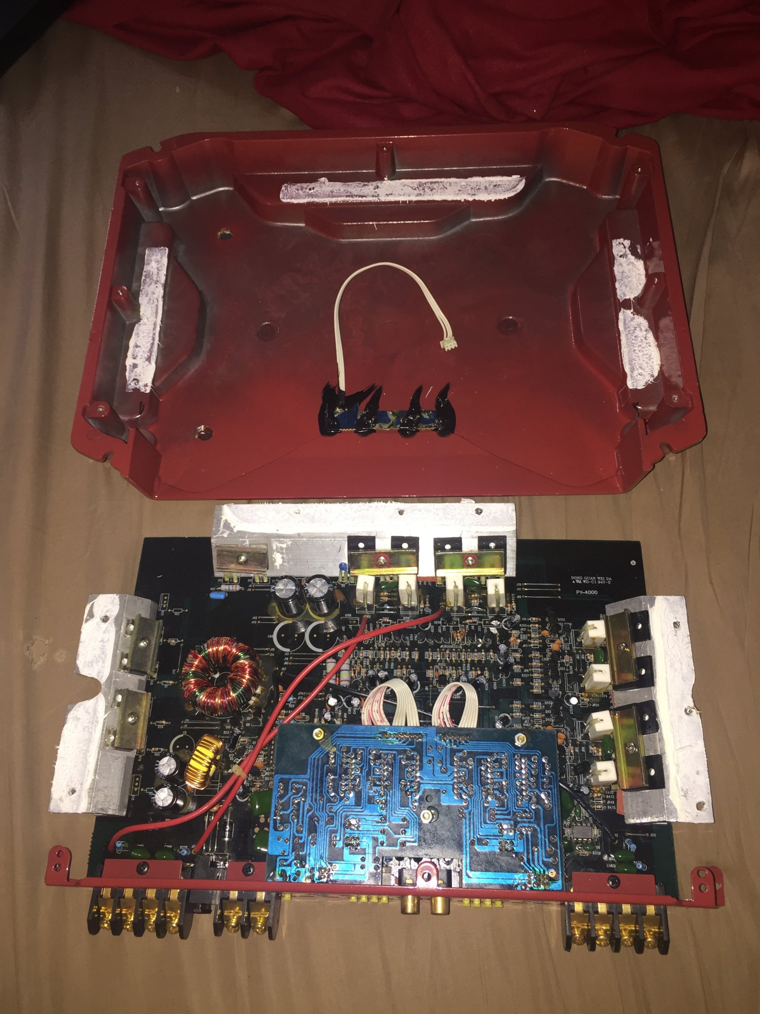

Package arrived, and I must say: I’m more than a little surprised at what’s inside this thing. There’s a legit, though cheaply made 4-channel class AB amplifier board in here! Does this still qualify as cheap flea market BS?
It's odd that they went as far as to copy the internal heatsinks and yellow push connectors. Without the misspelling (intentional or not), it could have passed as a Sony.

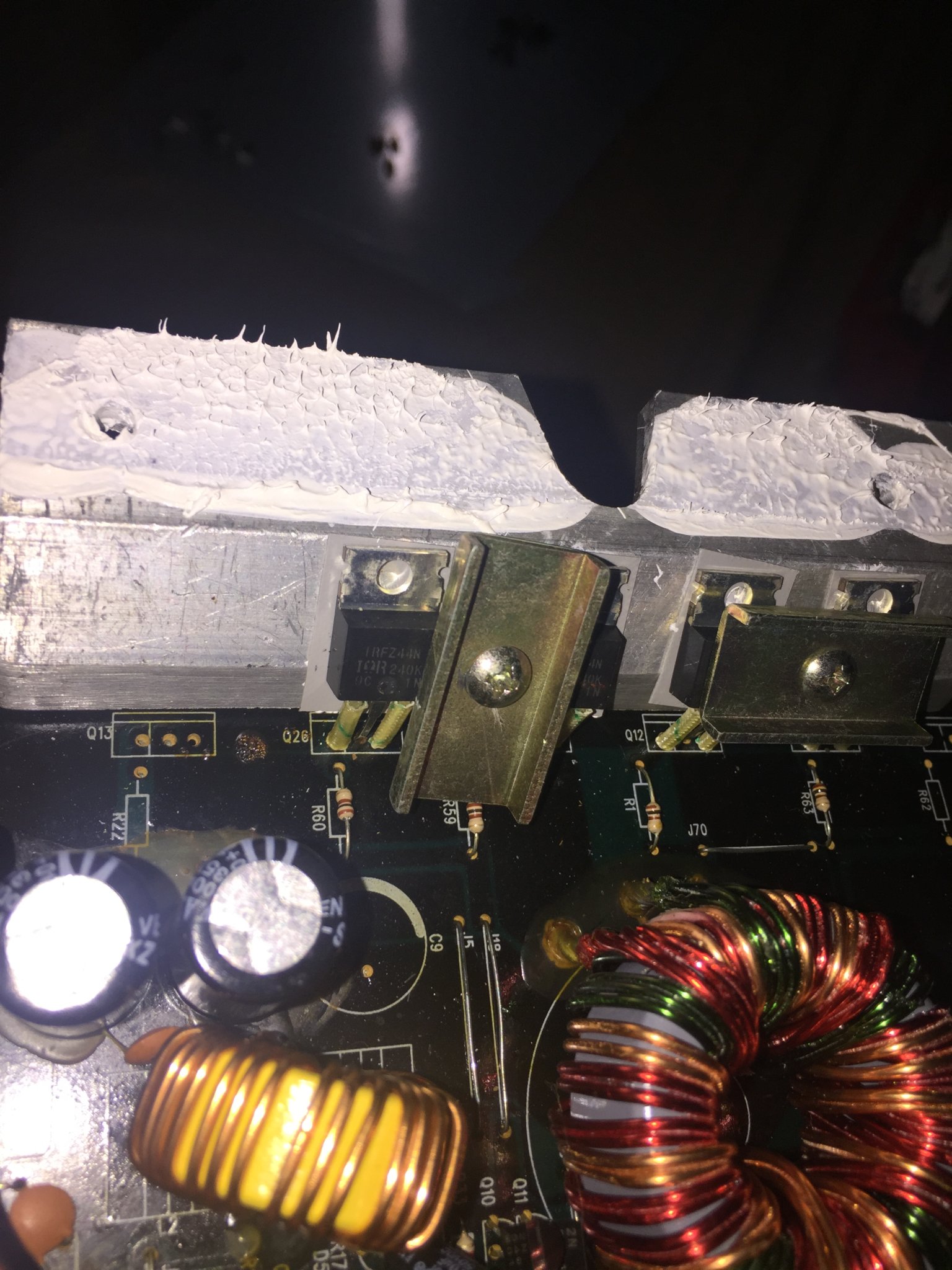

That’s what piqued my interest initially, Perry. I figured at best those were only for display purposes and didn’t actually work, but they do. Which means someone (Dong Guan Wei Da?) went to the trouble of getting even the fine details done, which is super odd for knock offs. And ever though it’s a single sided board with Korean parts, it at least made an honest effort at sound quality. It has all the right parts in it to make 300w peak in bridge mode, outputs appear to be Sanken (not sure if genuine or not) 2SD998/2SB778 and the power supply is using International Rectifier (again may be copies or maybe not) IRFZ44N.

How does an original one look like? The knockoff looks actually very decent.
I know! The chassis even appears to be die cast as the originals would have been, where you’d expect a copy to be a cheap sand casting with a lot of finish work to make it look presentable. But there’s no way they got those nubs on the front as clean as they are with a sand cast part, it must be a die casting.
