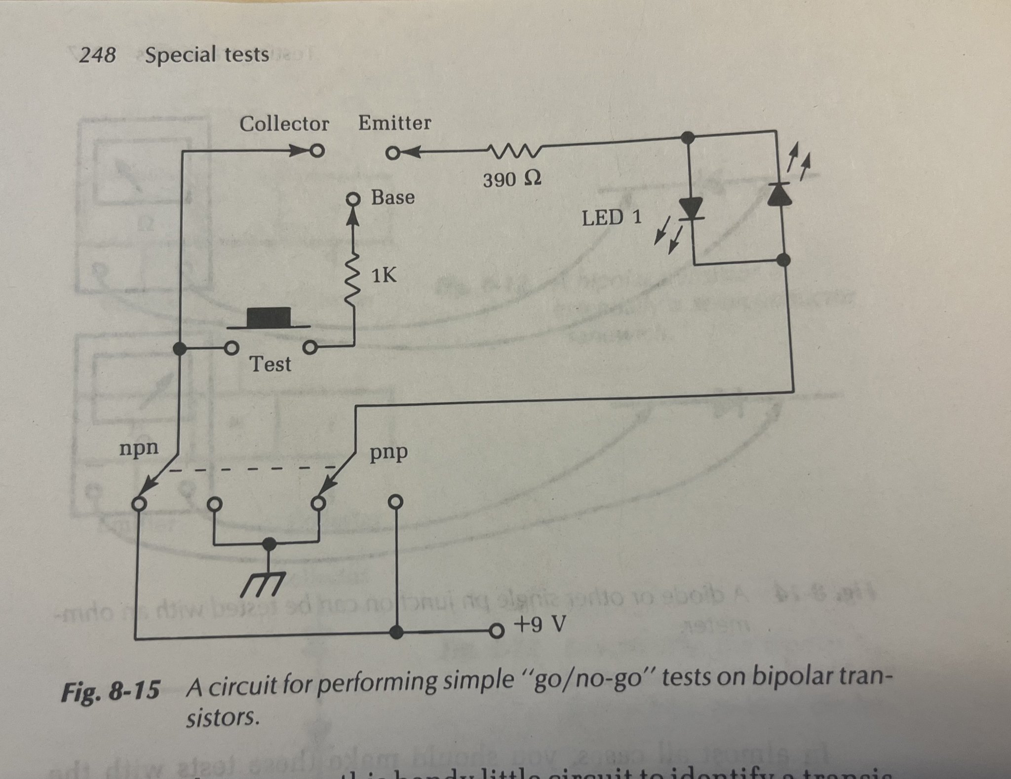

I also built the following circuit, and none of them behaved correctly when placed in it. An LED is meant to light up when the button is pressed - if the transistor is good. I'm sure you would have figured that out 😊

The circuit you show for testing transistors is very basic but should work up to a point. If you short C to E one of the LED's should light. If you reverse the battery (that is all the switch does) the other LED should light.
The resistor values are very low and particularly so for modern LED's and high gain transistors. The 390 ohm could easily be increased to at least 1k and the 1k to 10k.

It is always possible to have a single random failure on a transistor but it is it also very very rare on low power stuff like this. I suspect something amiss with the testing (and unlikely you have fried them) but lets make sure. Lets test the tester 🙂
If you take the tester above you built and switch it on with NO transistor fitted the LED's should be off. Make sure the switch is in NPN position and measure from the battery negative terminal to the collector point. You should read plus 9 volts. The Base point should have zero volts. LED off. If you press the Test button the Base point should rise to 9 volt and the LED still be OFF.
If that is OK then connect any of those transistors to the tester but only connect the collector and emitter. The LED should be OFF.
Make sure you are identifying the pins correctly on the transistor. Data sheets are here:
DATA SHEETS
Just search for the device numbers. Enter just the main part such as 2SC2784 and ignore any letters after that.
Now connect the Base. The LED should still be off. Press the button and it should light.

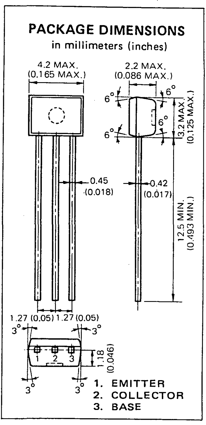

Oopsie. I have misread the data sheets. I actually find them slightly misleading, as they've got the front-on view above the end-on view, and I assumed the pins corresponded, whereas I should have checked the shape of the enclosure on the end-on view, which I've done now.
However, when I was doing my in-PCB testing, I do think I still got them basically right as I was going by the PCB's data sheet which specifies where the emitter is.
Anyhoo, they now test correctly within the test circuit. I had rigged up my button incorrectly as well. I followed the steps you described. Thanks for that!
So I'm now confused, the table above where I'd tested them all with my multimeter in diode mode and got strange results, is that all null and void? I thought transistors tested basically like 2 diodes next to each other..so for example, Q502, when I tested across the base and collector (which I now realise will actually be emitter and collector), I got current in both directions. Do I just forget all that and listen to the results of my test circuit.
I guess the wash up of all this is that I should put the transistors all back on the PCB and keep testing? I'll make sure to put them back in the right configuration 😀

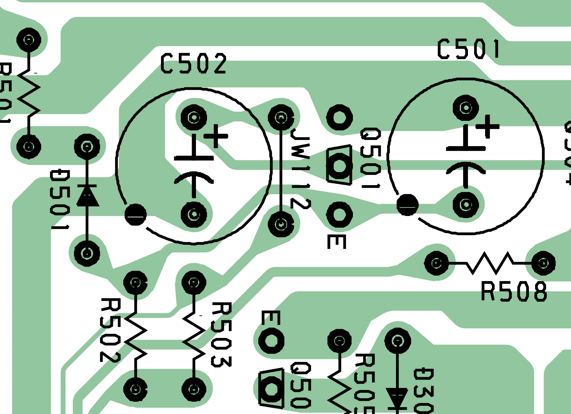

Right now I'm further confused. On the circuit board diagram, where transistors are seated (eg Q501), does the "E" not signify where the emitter goes? Because it appears connected to D501, R502 and C501, however the schematic shows the base should connect to these.. I'm missing something obviously 🤔
This might also explain why I got weird voltage results (eg 0.5v on Q501 emitter)
Welcome to the real world of service and repair 🙂 The board layout markings are indeed incorrect. The emitter of Q501 should go to ground. What is marked E on the board is in fact the base.
