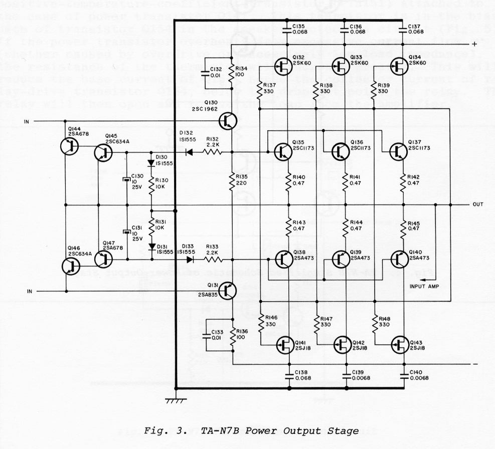

You seem to be operating from some mis-information.
I will address some of your points later, but here is a schematic of the TA-N7
amplifier, showing that in fact the VFETs are being used to cascode the
Bipolar outputs, not the reverse. This is a bipolar amplifier in my opinion,
and any part would have served as the cascode - here it is simply convenient
that the VFETs are self biasing.
:cool:

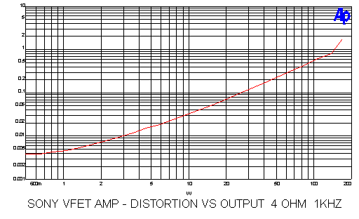

The one and only
Joined 2001
.... We don't have a schematics of it so far ... and that's good, that nobody tries to clone it, burning even more V-FETs for a horrible 2% of distortion afte matching a hundred ...
You are conflating the performance of two entirely different amplifiers.
One, the published DIY project is a common-source amplifier in which the
VFETs are expected to provide both voltage and current gain.
The other, which was made for Sony and is more in keeping with Sony's
particular needs, is a Common Drain (follower) design.
As you should know, followers inherently contain their own feedback in the
form of degeneration with the load. They tend to measure a lot better
for that reason, and don't make for an apples-to-apples comparison.
The amplifier made specifically for Sony's 4 ohm AR1's does 0.6% thd at
100 watts into that load with 6 dB of feedback and has a bandwidth of -3dB
at 100 KHz. I believe that this is comparable to the measured performance
you quote. Attached is a curve.
:cool:

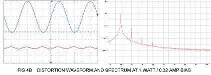

The one and only
Joined 2001

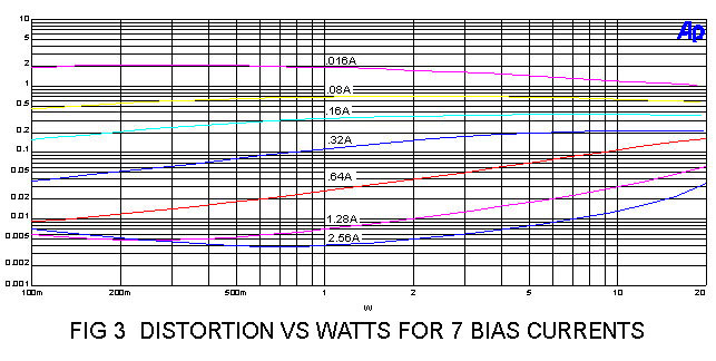

Declaring the 0.5A idle current in e.g. a TA-8650 as being Class B strictly follows the definition of Douglas Self, that Class B is where the minimal (static) crossover distortion is. Above the associated bias point you get gm rise (often called gm doubling), below you get gm droop close to zero.
I do not accept a 0.5A bias as being Class B. I regard it as AB.
I recall that Douglas Self (who is a great bloke, BTW) is talking about bipolars.
When it comes to THD measurement, he is totally correct on the matter of
"optimal bias" as well as the proper ballast resistors to use to get the effect.
As to sound, there is a little more controversy - I have noted that higher
bias in bipolars still sounds better than "optimal" and this was how I biased
the Threshold "Stasis" amplifiers - they measured better at lower bias, but
they sounded better at higher bias.
With FETs, it is my considered opinion that (within rational limits) the higher
bias the better. All you have to do is build an output stage and measure
the distortion vs bias current and you will clearly see what I mean.

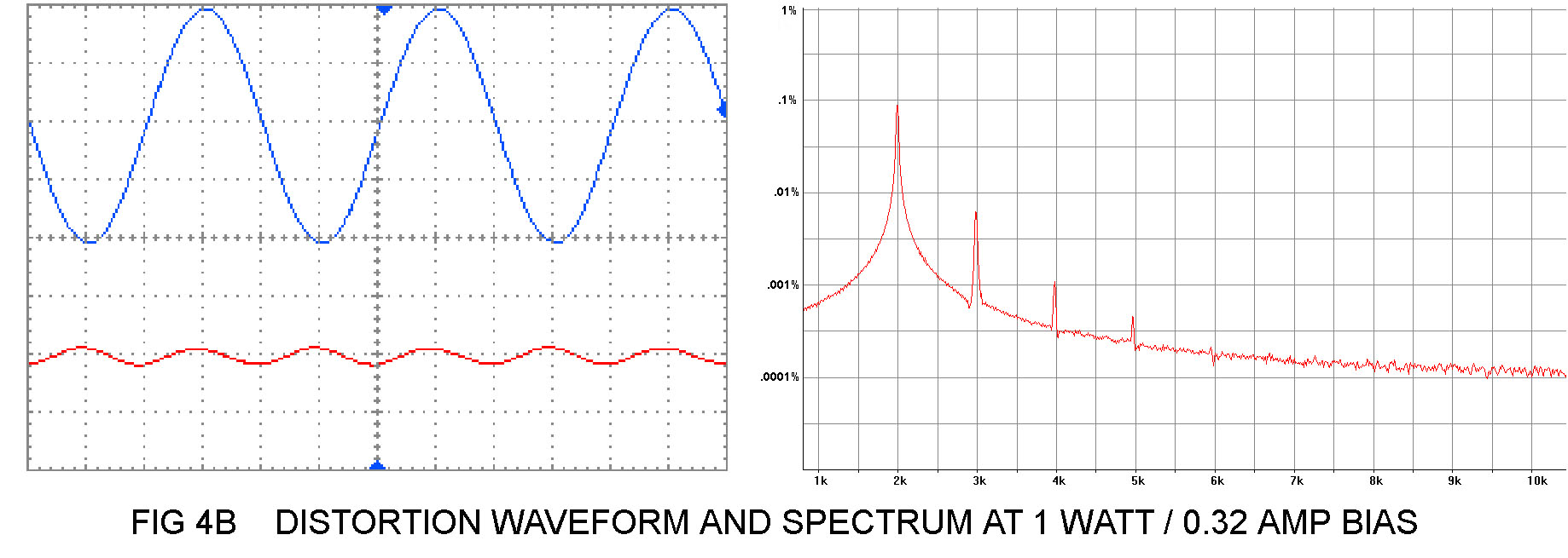

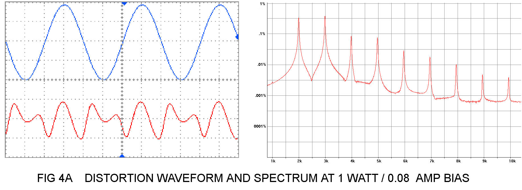

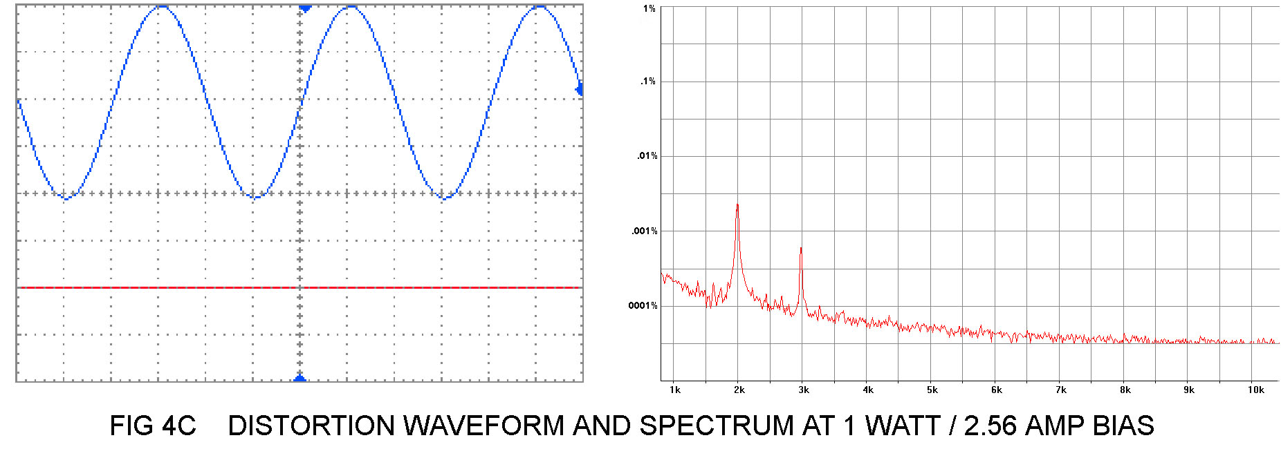

I attach some graphics of distortion vs bias for a push-pull follower FET
output stage:
:cool:

IMO 0.5A for 3 devices 2SK60/2SJ18 in parallel or two 2SK77 PP can be considered Class B as well as 35mA could be considered Class B for a bipolar stage (with the right choice of emitter resistors).
In your reasoning that the bias can't be high enough, you were absolutely right, if you would consider the output stage gm being constant vs. bias current. Unfortunately gm goes up with bias increased and this increases feedback in the output stage intrinsically reducing distortion further.
If you would normalize your THD for your example FET stage to intrinisc gm (calculate back to a virtual open loop), the distortion would not drop anymore above a certain bias point and that could mean that any other kind of (local) feedback and/or feed forward applied to the OPS could also be used to reduce the non linearity in the very same way as you do by increasing the bias.
I don't see, that the rise of gm vs. bias is really the most perfect distortion reduction mechanism one could apply here. It is brute force indeed, and it is thus as simplistic as one could imagine, but there is certainly healthy life below the area, where classic Class A operation is. The complementary SONY V-FETs give opportunities here (in the direction of Class B) and IMO their "raison d'être" is not in Class A or deep Class AB. This was btw. also the opinion of the SONY engineers, who created them (clearly written in SONY technical documentations).
Without having much real world hands on experience with the bias point game regarding V-FETs I can only say, that the OPS gain vs. output DC voltage, which Douglas Self uses for judging over-bias or under-bias is certainly a very informative means, showing probably a quite different picture than the traditional THD vs. Power you use. And this can be definitely also measured, not only simulated (as Douglas Self mostly does). From my perspective both representations have their right to exist, even, if both lead to completey different interpretations, where an optimum bias level could be.
At the end the ears tell the final truth and again: Classic V-FET amps sound excellent, even while only operating (close to) Class B.
Regarding Class B and standard bipolar EF stages (and also for vertical MOSFETs), I can only say, that thermal and dynamic distortion effects completely kill the theoretical advantage of this operation mode.
And yes my experience is also, that slightly overbiased bipolar Class B stages sound better, but that could also be because of the pronounced switching distortions at lower bias levels and the less pronounced modulation of bias due to thermal effects at "over bias". As I know, at least complementary V-FETs with their very smooth crossover region don't show switching distortion in Class (A)B, nor don't they show the dramatic thermal dependency of bipolars of vertical MOSFETs.
So the commonly accepted rule to avoid Class B if possible doesn't necessarily apply to complementary V-FETs. I would say, that the exception proves the rule here.
The TA-N7B is IMO not a full-blooded V-FET OPS amp, because the output stage basically is a Class (A)B bipolar EF stage, cascoded by V-FETs, so its behavior is mostly dominated by the bipolars. That's all I meant about that and I didn't confuse this at all (I can draw you a TA-N7B schematics by memory, but my English is a little limited, so some of my statements may have been misunderstood).
Interestingly the cascode with V-FETs let the smallish bipolar outputs keep their junction temperature rather constant and due to their enormous speed (ft=200MHz), one could say, that here Class (A)B really works with bipolars for the very first time.
This is probably the reason, why many consider the TA-N7B being one of the best sounding classic amplifiers. Here the amp doesn't sound good because the V-FETs dominate the sound, they only give the opportunity for the bipolars and the rest of the amp performing much better.
