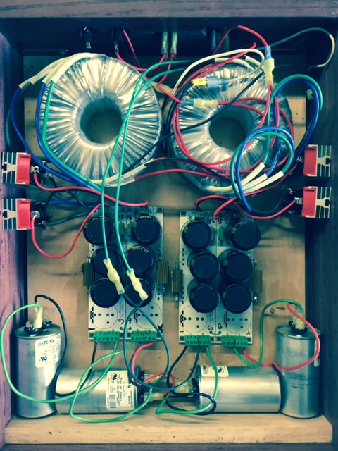

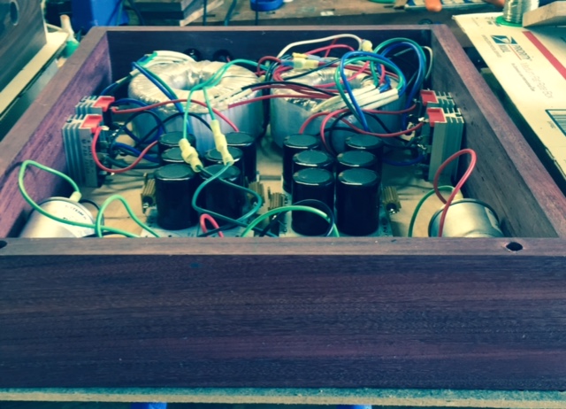

PSU
Completed my PSU for VFET2
22+22 500VA transformers
Tea Bag PSU boards with 60k (40 + 20) per rail and motor run caps as bypass (50 microF per rail) - +/- 30V DC no load
VFET cases will be auxiliary units
Best
Bob
Best
Bob

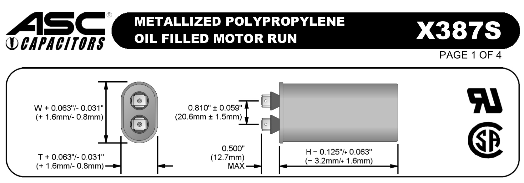

ASC produce high quality oil caps
the lower price is 5,05 $ :
Search results for "oil capacitor" - Allied Electronics
http://www.alliedelec.com/images/products/datasheets/bm/ASC_CAPACITORS/70006849.pdf
