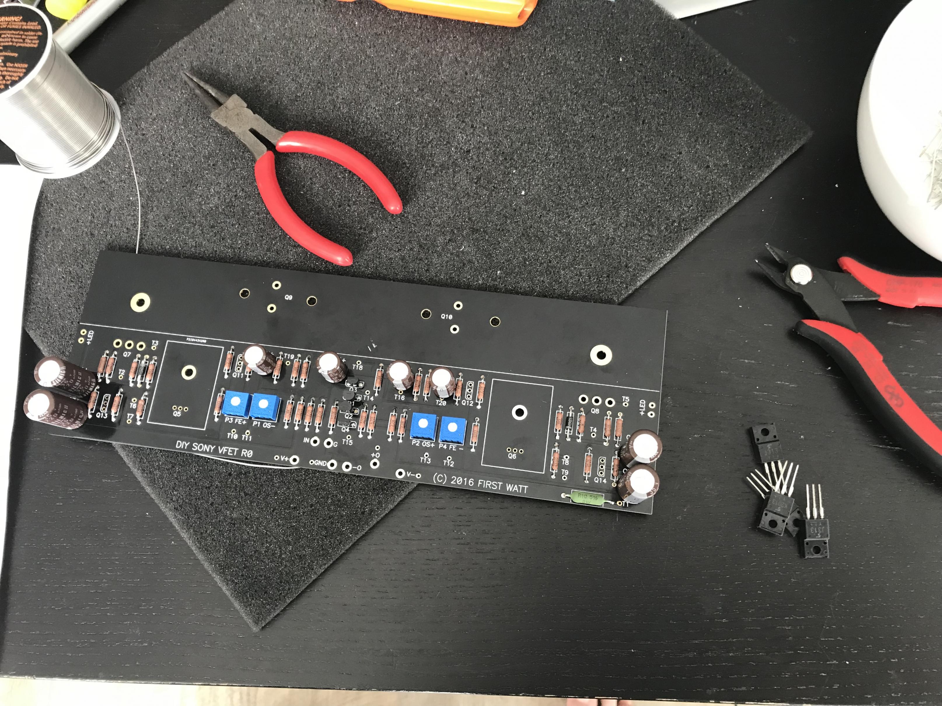

I’m trying to Bias the front end to 1.5v J313 is good but the k2013 on P4 will only go to .9 with T18 near 0.
At 1.8V it will sit at 1.1v.
I’m measuring across the 47.5r resistors, and don’t have the Vfets in yet.
Any ideas?

Biasing the front end is a pain. After heating up, your 0.9V will go up to about 1.08, which is however still below the desirable voltage. It is either to change p3-p4 to 1kOhm or (in my case) r34-r35 changed to 333 ohm and still I am slightly below 1.2V.
More pity is that I use "matched" pairs of LSK/LSJ from diyaudio store...
Unfortunately even when you are using matched jfets, you can run into
this issue if their idss is on the low side of the BL/B grade range. 🙁
damuffin: Assuming the R5/R6 values are correct at 47.5R, have you tried
backing off a bit the bias on the J313 and then see if you can increase the
bias on the K2013 while maintaining reasonably low offset at T18?

Thanks for the responses, The Jfet devices were marked as 7.5 and 7.59. I have another set marked 9.2ma.
The recommendation “JFETs are selected for Idss to within a milliamp or so at 8ma”
After further testing it looks like the other channel is acting the same way with a .7v stagger.
What would be the lowest and highest practical value 1.2v and 1.8v with the offset near 0?
The trim pots are not maxed out so will changing resistance values actual narrow the gap?

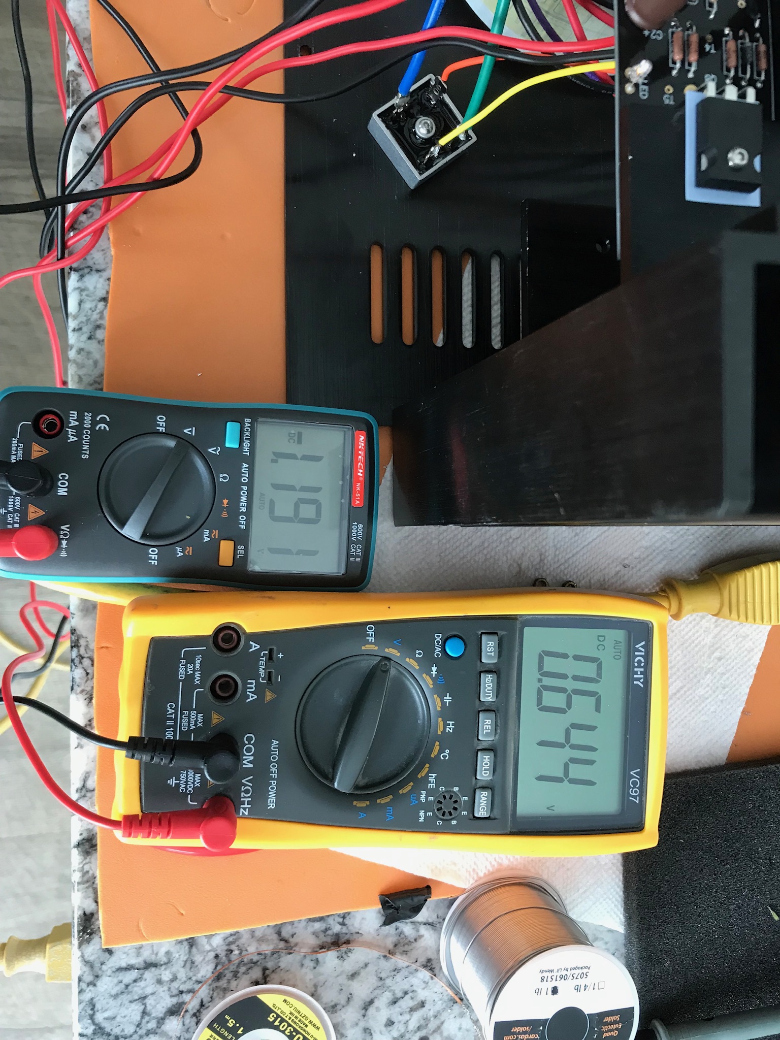

So after a few hours of loosing hair, I’ve come to realize that my volt meters measure .5v differently...........

Phew! Glad you figured it out. 🙂
I read again what your wrote afte looking at the schematics and
realized your measurements were inconsistent, since the diff in voltages
across R5 and R6 would imply a current going through R31, giving rise to an
offset at T18.

An aging battery in one DMM will also produce screwy results. Glad to hear it turned out to be something simple. A vfet2 amp is probably my next build. I think the only parts missing are some PSU caps and a chassis. Little by little... I'm excited to connect it to my in-progress B1-Korg preamp.

So how did you decide which one to use as the benchmark?
I'm almost ready to start my VFET kit and I just bought my 3rd meter. It's good to know that I should check them against each other!
Success
The older VICHY has been used in many amps. It was the new NKTECH meter that was out. I clued in when measuring the supply voltages. They showed up as 32V and the VICHY was 28V.

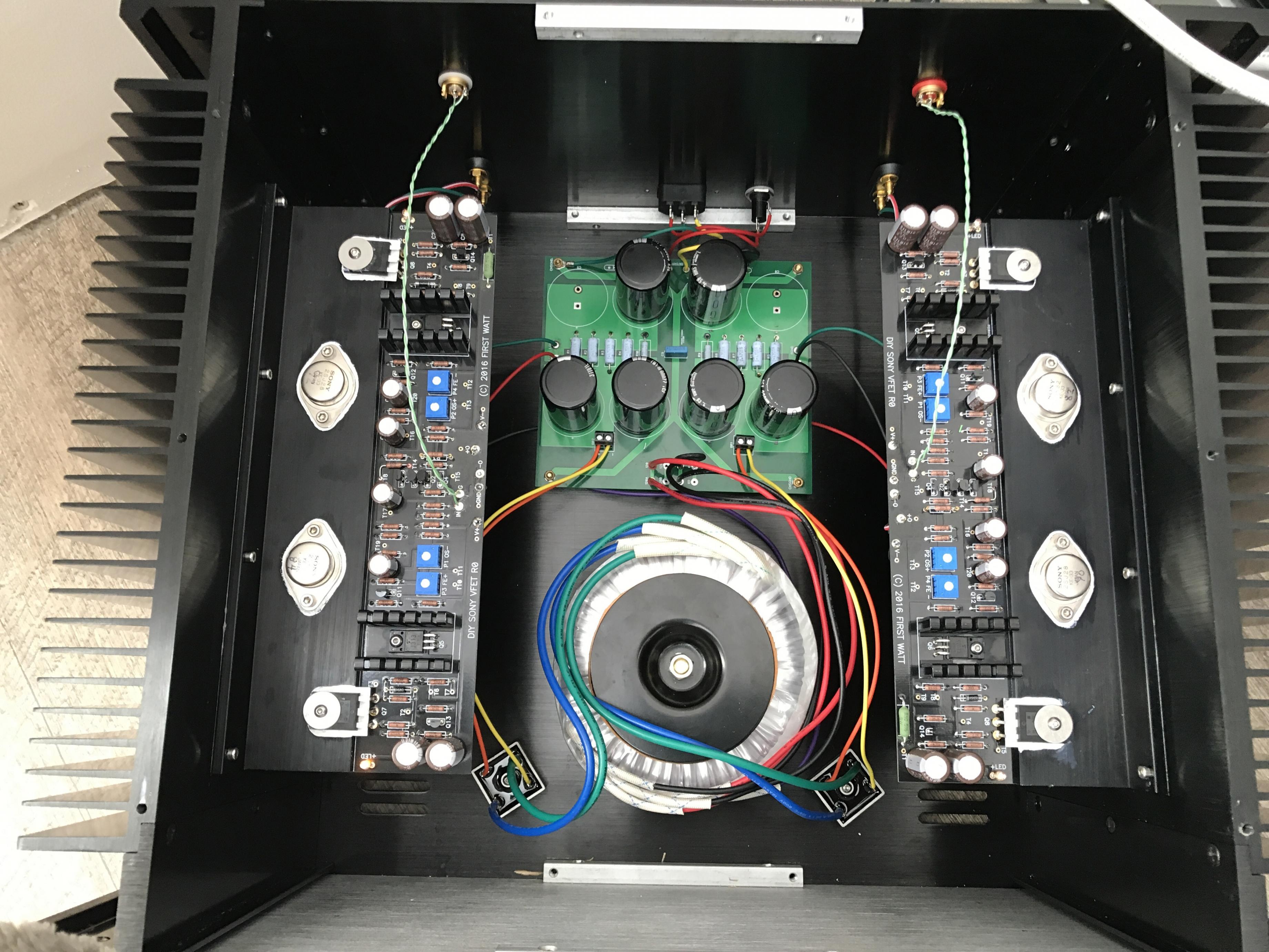

So after 4 days of drilling and soldering we’ve got music.
I’d like to thank everyone involved in creating this amp, you can tell Papa had at least one sleepless night playing with this circuit.

@damuffin
Looks very nice and tidy excellent build. What is the PSU you are using looks compact and almost like the FW commercial one. Where did you get this PSU?
