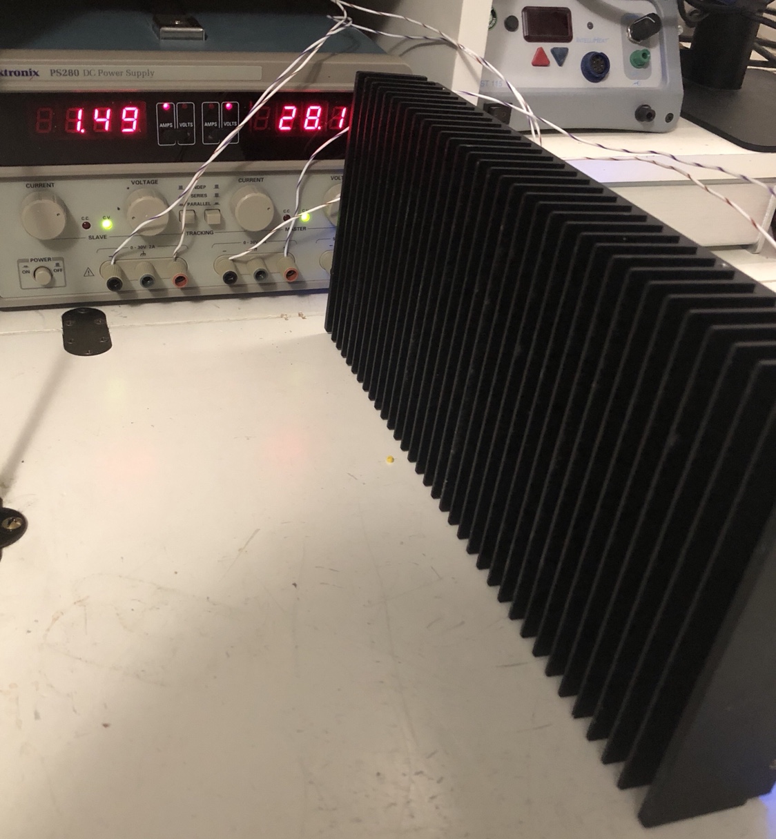

and now i have twins 😎 any my brother has his own vfet baby.
second time biasing was easier, best tip was to first bring t6/t7 and t8/t9 up to 1.4v with p3/p4, offest t18 around +-100mv and warm it up, wait 10min.
readjust p3/p4 for offset t18 around +-100mv then bring r32 up to 80mv with p1/p2, output offset +-50mv. wait 15 min.
now adjusting all 4 pots p1/p2 - p3/4 in cycle up to 1.45v at t6/t7 and t8/t9 and r32 to 90mv (check first t18), againg offset around t18 +-75mv and output offset +-50mv. baby steps needed or it run away fast (even more with one turn pots). let it heat up then for at last 30 min.
after this time r32 was a little bit under 100mv. go for 1.5v at t6/t7 and t8/9 and r32 to 100mv, check offest's. readjust again in cycle all 4 pots for the target bias and offsets. now with baby baby steps 🙂. wait after every adjustment some seconds, you get the feeling when the circuit get into a stable state. dont touch the small heatsinks, the offest over t18 acts at once. i done the final fine adjustment via p1/p2.
at the end i had a bias of 101 mv, offest t18 floating around +-50mv at t18 (1.51v) and output offsets +- 20mv.
remember everything up to +-200 mv over t18 is ok and +-50mv output offset is ok, +-50mv over t18 and +-20mv output offset is perfect for me. the amp needs 1 hour to get stable. floating around a bit is normal.
this way was a lot easier then put t6/t7 and t8/t9 direct to 1.5v, hope that helps.
don't rush 🙂.

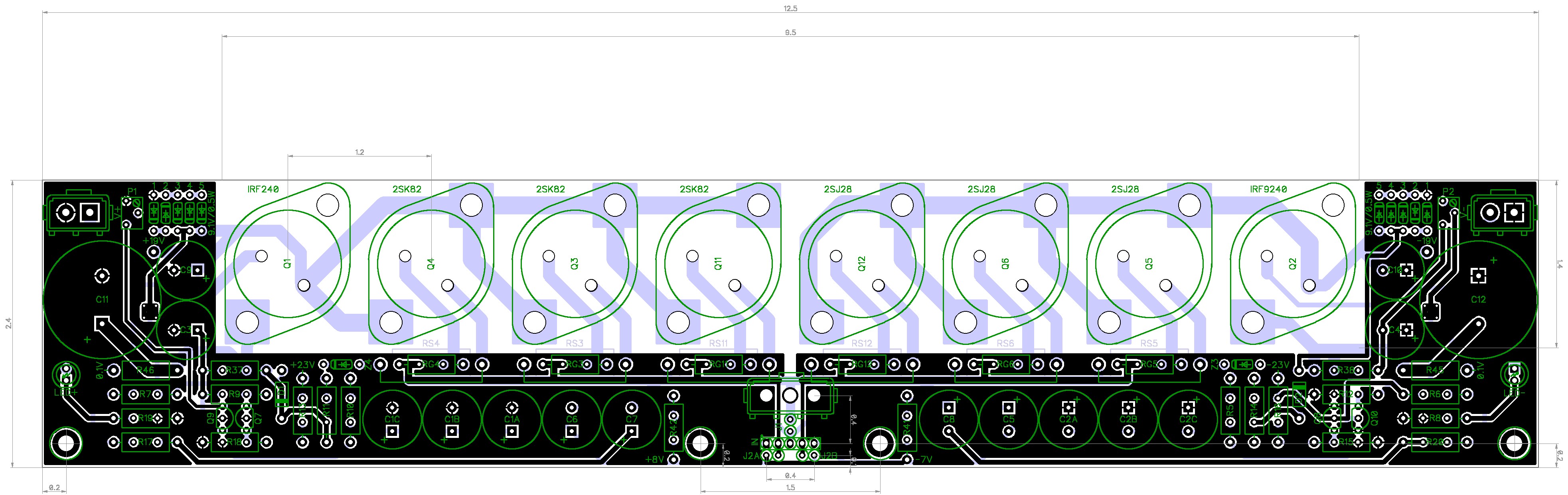

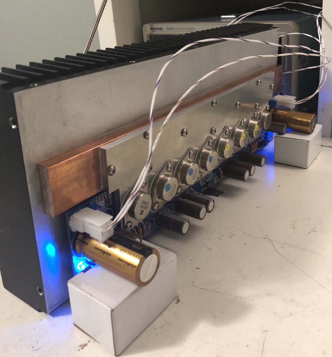

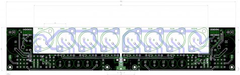

I have some three output versions of an output stage that can be used in all the VFET designed posted.
I am trying out a creative way to mount the boards and devices, so it might not work for everyone, but I'm glad to share the boards that I have already made.
If I understand correctly your board can be built with 2 pairs of Vfets only right?
What creative solutions are you looking into for mounting into the heatsinks?
