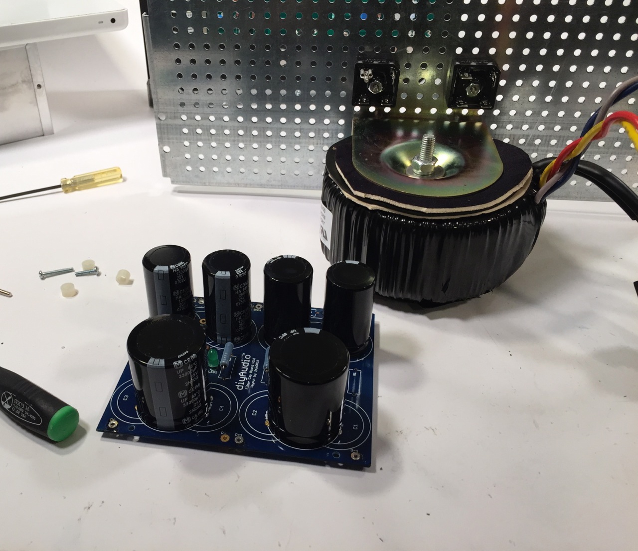

Chassis
At last doing the V2.
From reading the entire thread, I think I understand that the DeLuxe 4U is sufficient with regard to heatsinking. Both for the single and dual pair VFET. Correct?
What is the experiences with regard to space inside? It seems to also be sufficient. But if you load it up with protection circuitry, remote power on and other fancy/necessary stuff, is it still room there to change the belt for the overhead camshaft etc? 😀

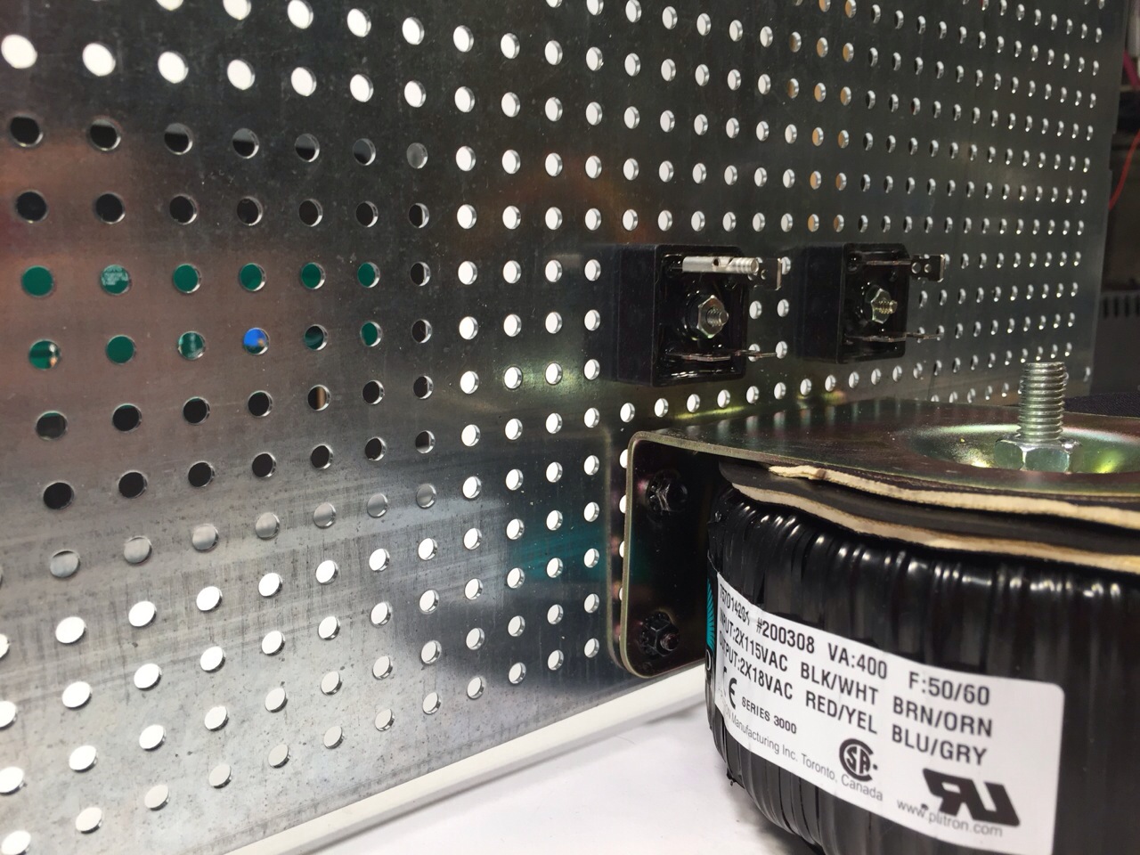

If heat sinks are sufficient but you need more space try psu toroid on L bracket like show by 6L6 on his build guide.
Best regards 🙂
