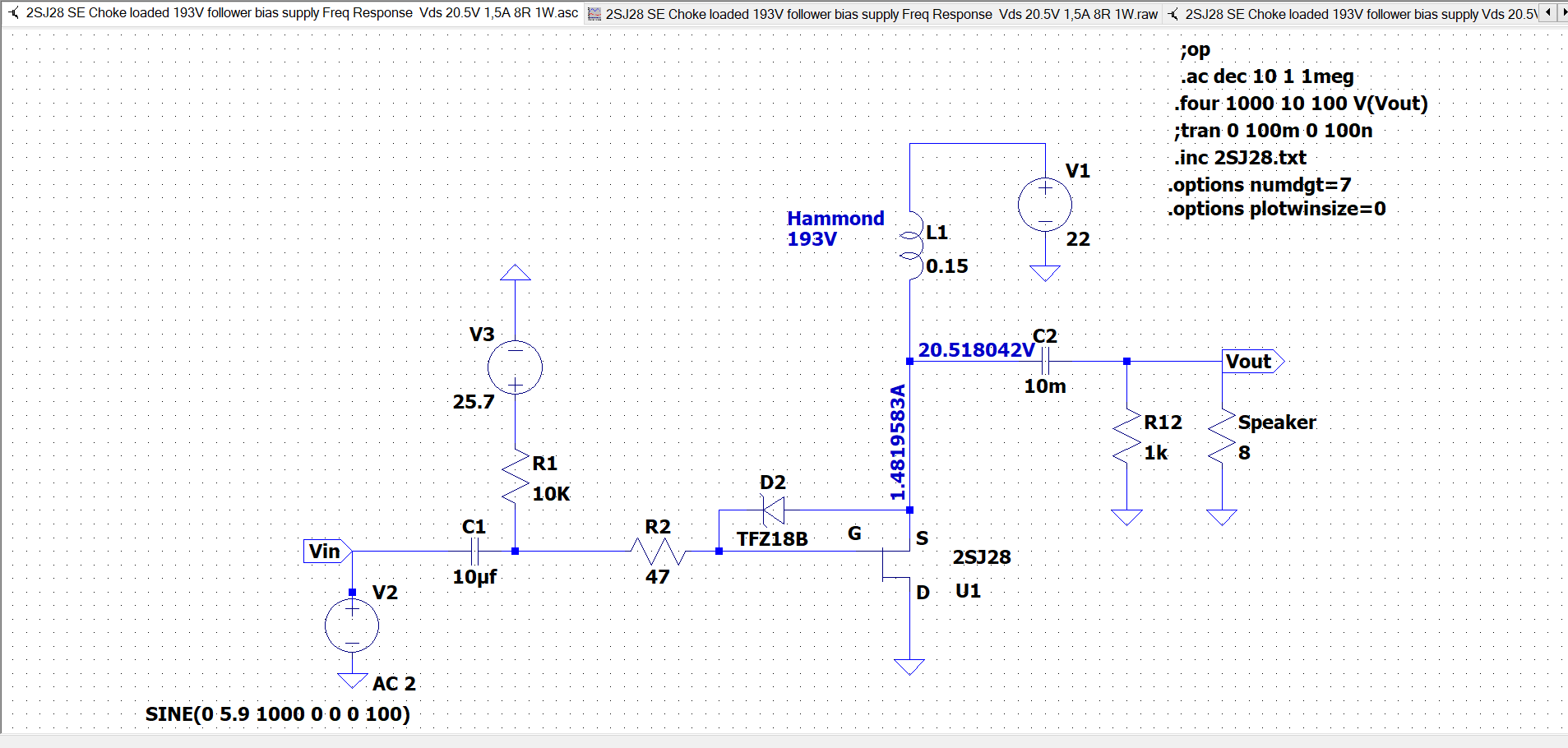

ra7, Congratulations on your build.

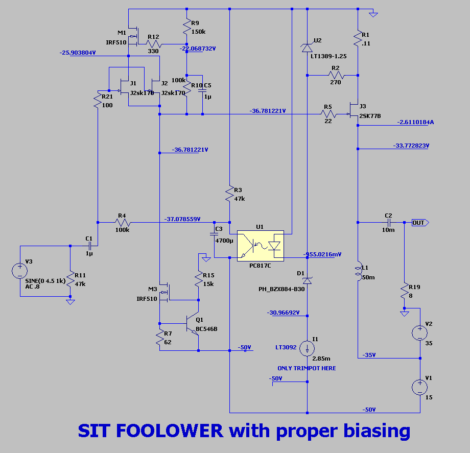

For your bias supply did you build it stand-alone as my original schematic or did you do as I did in post #17? In the post #17 schematic I used the V+ supply to boost (add) to the 12V bias supply, so the higher voltage stand-alone bias supply was not necessary.
I have been listening to my THF-51S common drain mu follower until recently when I put in my choke loaded 2SK180 follower. However after reading your post, I became curious so I put the choke loaded 2SJ28 follower into the system.
On first power up, there was a very mild thump. My speakers are 103dB sensitive and the thump wasn't very loud. Subsequent powers up were just a bit louder but still not objectionable to me. I put a meter on the output for the subsequent power ups, after checking that all of the capacitors were fully discharged. At the speaker output, I saw 4 to 5VDC but that fell immediately to 0VDC. It definitely didn't go to 18VDC and slowly drop.
The main difference I can see is that I bypassed my speaker output caps with a 10uF film (motor run) capacitor. I don't know whether that makes a difference or not.
My choke loaded 2SK180 follower has no power up thump at all. Apart from the 2SJ28/2SK180 difference, that amplifier has the power supply on the drain and the source/choke is grounded. The reason I did it that way was because that was left over from the original common source configuration that I changed to follower configuration. However the drain to ground with the power supply to the source/choke configuration that I use for this 2SJ28 follower is supposed to be superior due to the lower noise, as explained by Mr. Pass in his DIYAudio VFET Part 1 amplifier writeup:
You may wonder why the Drain of the VFET is attached to ground. The reason is that the Drain impedance of the VFET is quite low compared to regular transistors, and any noise that appears on the Drain is going to make it to the output signal. Since Ground is the quietest spot in the circuit, it is logical to attach the Drain there. In the N channel version this is still true, although the supply voltage for the current source becomes negative instead of positive.
As I recall people have written that the DIYAudio VFET amp also has a power up thump.
Regarding the VFET temperature, if the VFET body is only at 40C, I wouldn't worry about it. I haven't used Keratherm but I have used similar pads that were designed to be installed without goop with no problem.
My amp is very quiet, even with my 103dB speakers. I am a firm believer of minimizing loop areas (twisting wires) and keeping power AC far away from signal AC and DC. It is possible to get your amp to be hum free. The 2SK180 follower with the power applied to the drain, which is supposed to be noisier, is also hum free. Wire management does make a difference.

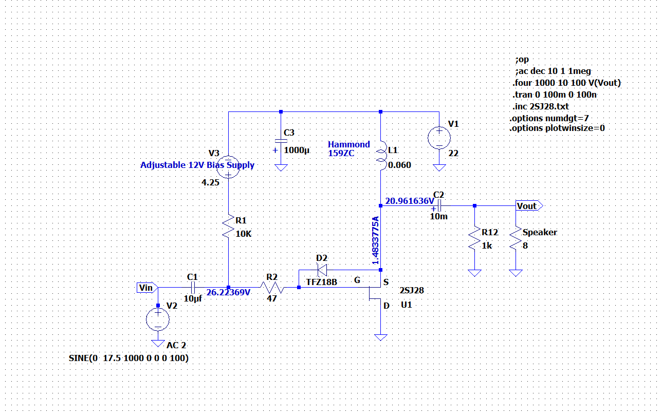

No, I built a separate 30 VAC supply, with a voltage divider and a pot to go from about 40 V to 20 V. Works nicely.ra7, Congratulations on your build.
I will try with an 8 ohm dummy load and see what I get.I have been listening to my THF-51S common drain mu follower until recently when I put in my choke loaded 2SK180 follower. However after reading your post, I became curious so I put the choke loaded 2SJ28 follower into the system.
