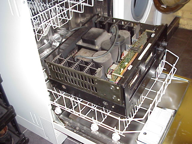

Ehh, ahum, err, first thing I did with mine was putting it in the dishwasher. No special precautions, just the way it is. Let it run through an "economy" cycle, and it comes out as new. This is really unbelievable, so clean, factory new (had no scratches, only very dirty and smudgy).
Switched it on, no problems whatsoever. Because of the hot drying cycle, and the special ingredients in the diswasher tablets, there is NO residue on the pcb and other internal parts (that's also why those glasses come out sparkling).
I needed to actuate the power switch a couple of times to get it switching with a good 'feel' but that was all.
I have dishwashed lots of amps and test equipment, never a problem.
But the machiune smells funny afterwards, you need to run a cleaning cycles afterwards to keep your OSH happy.

Netlist said:
ROTFL
What about shiny front panels?
Also, does the brand of the tablets effect the sound? :devilr:
/Hugo 🙂
Front panels come out like new. The TA-N7 has black painted cans over the transformers and the supply caps. They looked like they were painted yesterday.
Tablets: I used PowerTabs, with a red blob in the middle. Results are a more powerfull, but at the same time warmer rendition of the sound field.
For test equipment I use blue tabs, which seems to improve the calibration a bit.
Jan Didden

I'm currently working on a similar problem. An old Hitachi HMA-8300. Many safety resistors out of spec, replaced a lot already but still no sound. Oh... put it in the dishwasher and came out like new apart from some minor problems.
If I fix it I'll start a new thread about it. I've got a feeling it's quite an interesting amp.
Edit: schematic anyone? :angel:

Hugo,
this amp is stuffed with 2SK/2SJ mosfets 😀
Supply rails ok ?
Cleaned the relais ?????????
DC offset before the relais ? Maybe protection active ?
