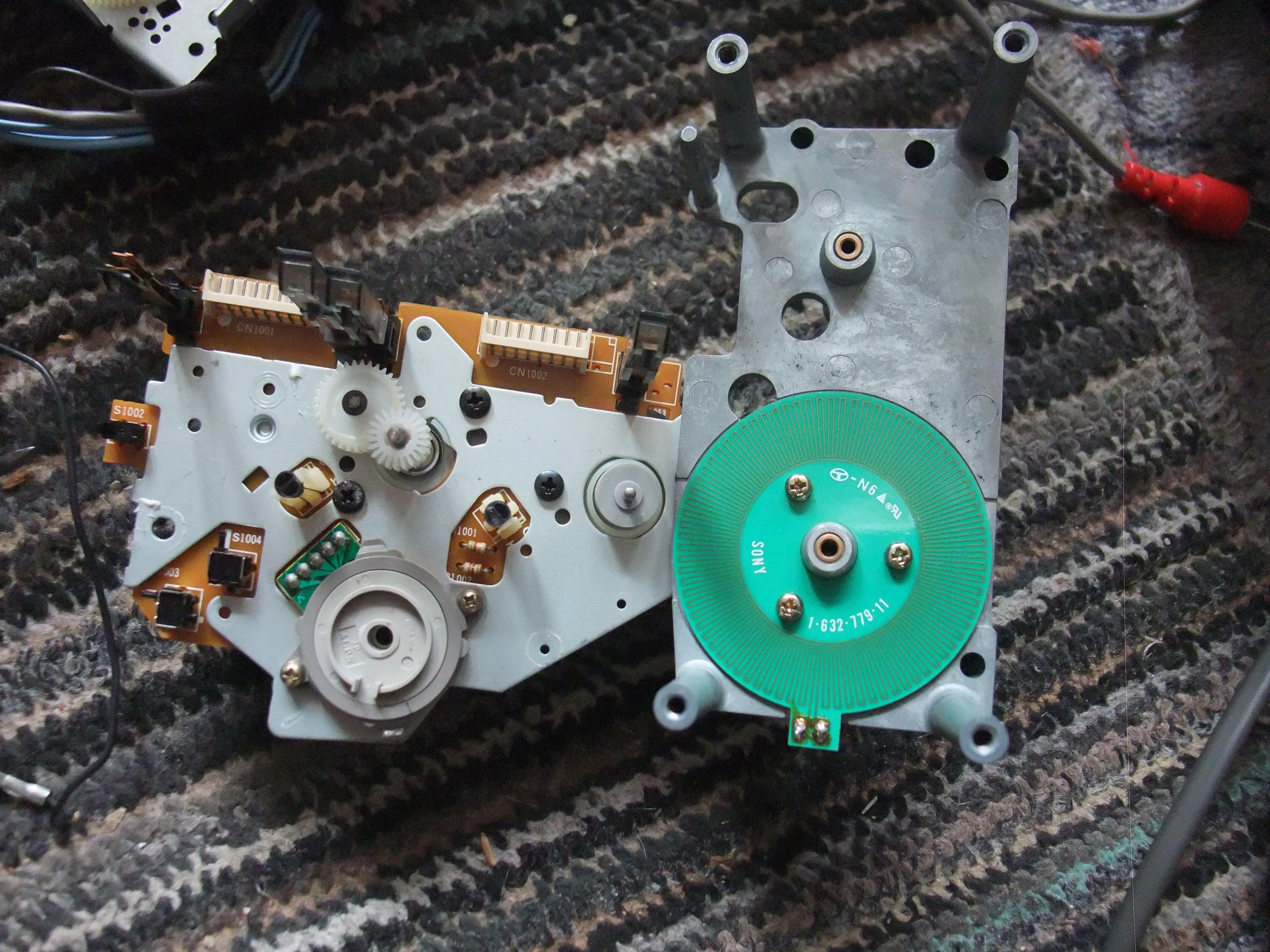

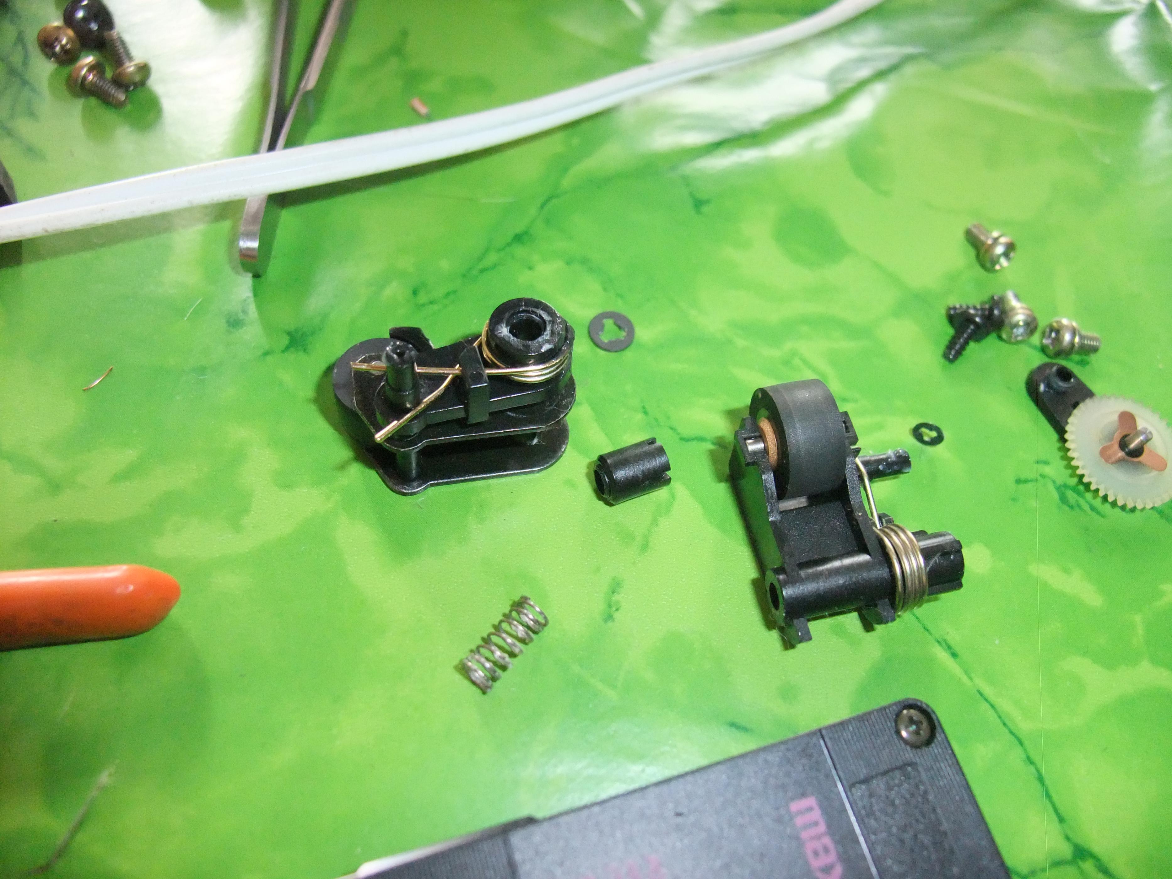

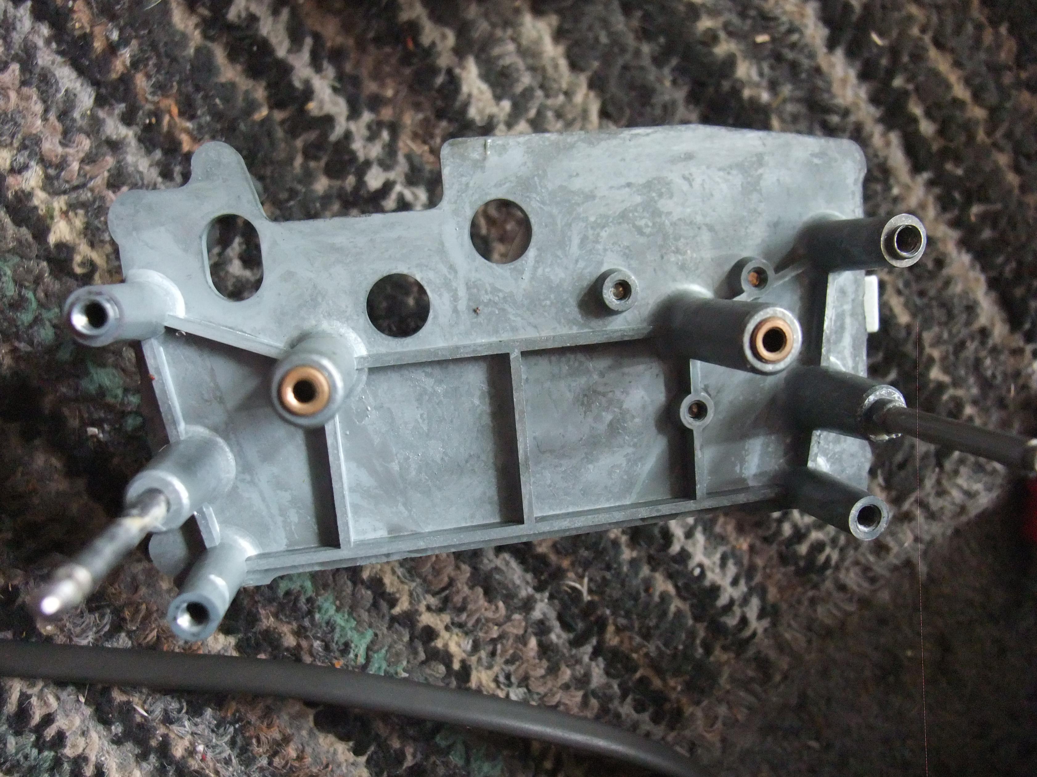

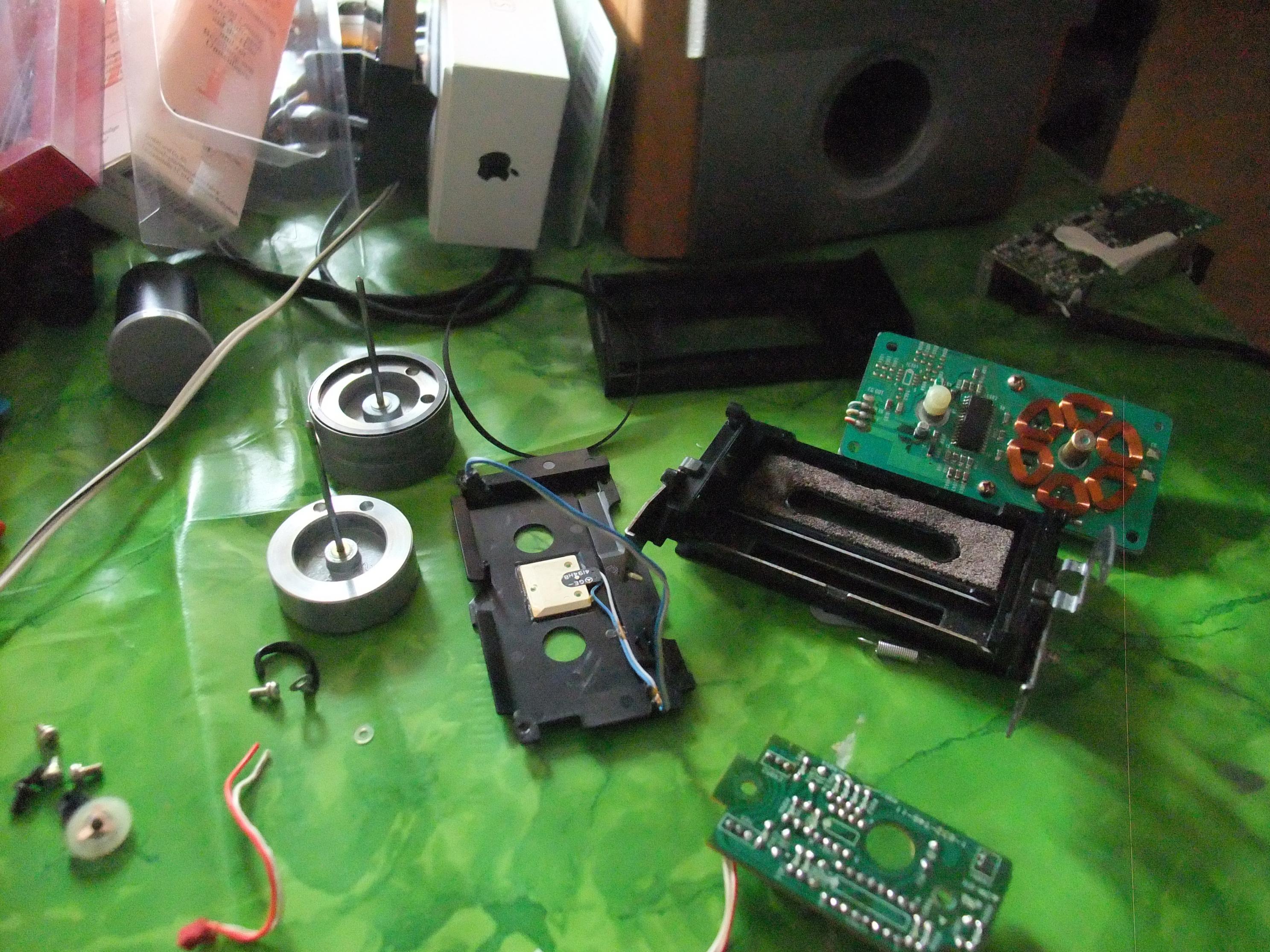

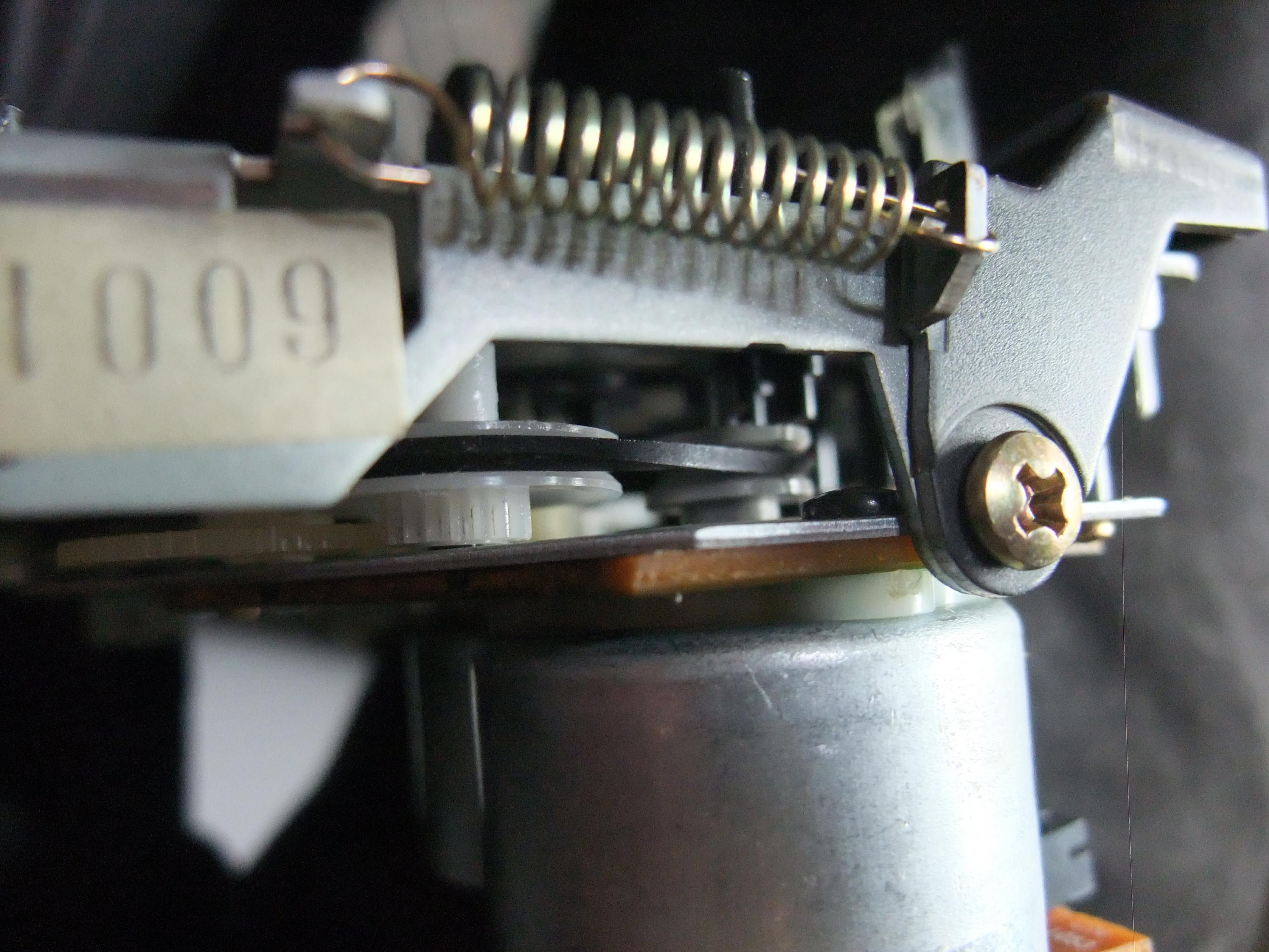

Contrary to my origin intention I purchase a TC-K570. This was yesterday arrived. First step was repairing this deck - only the voltage regulator for the Capstan motor was faulty - replacing a 13V zener and additional new belts so as cleaning led to a flawless operation.

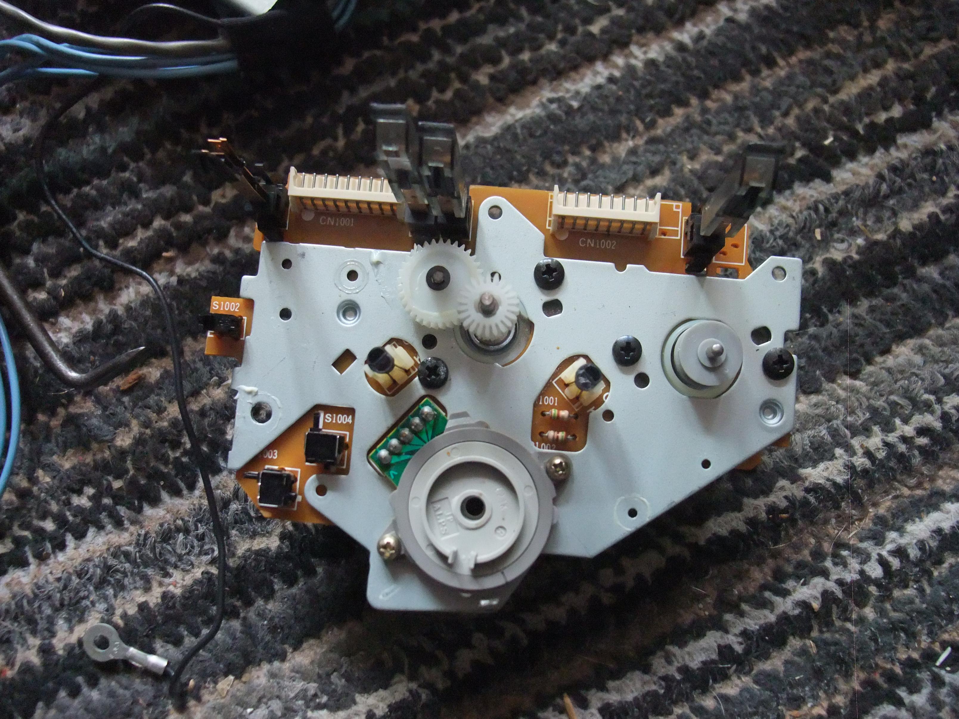

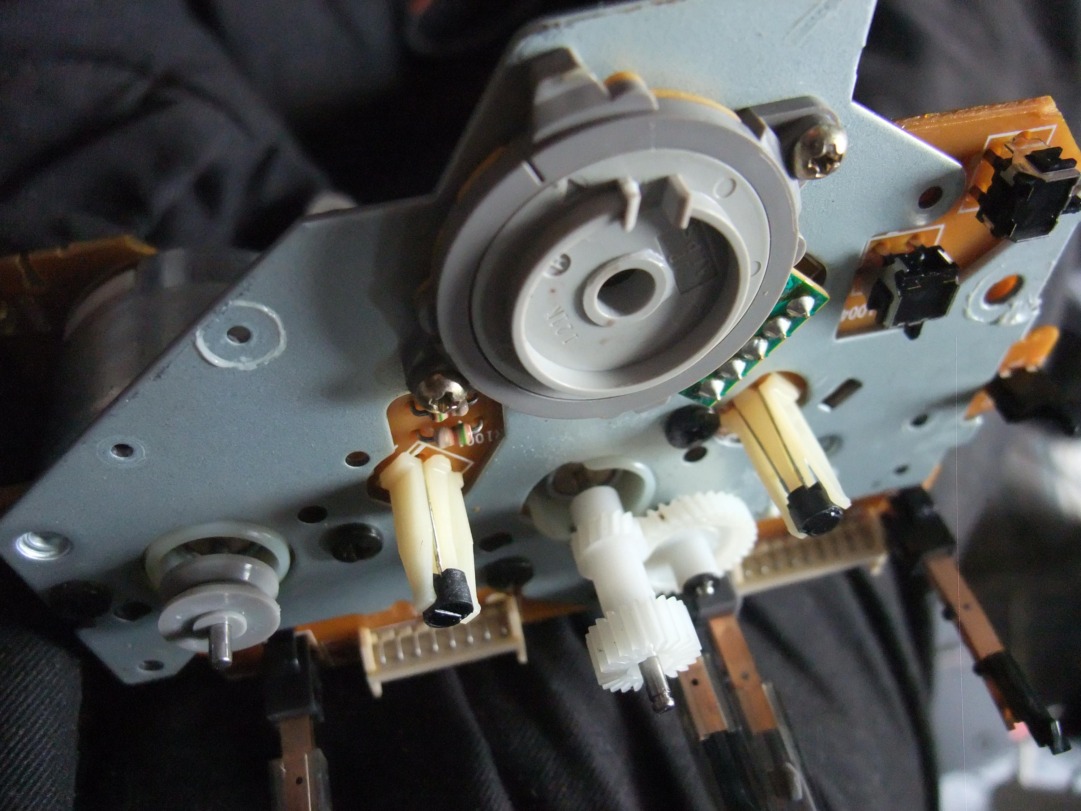

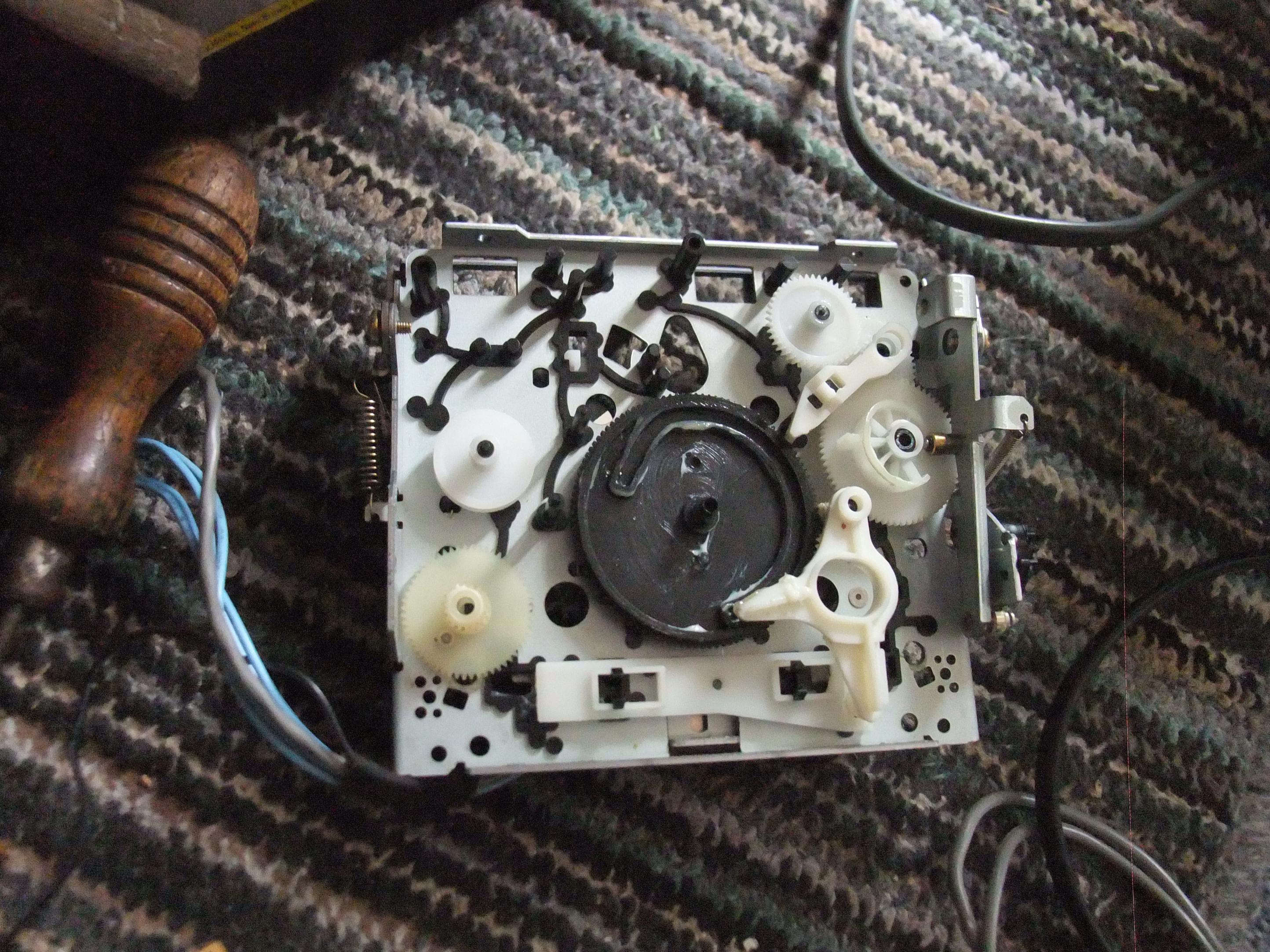

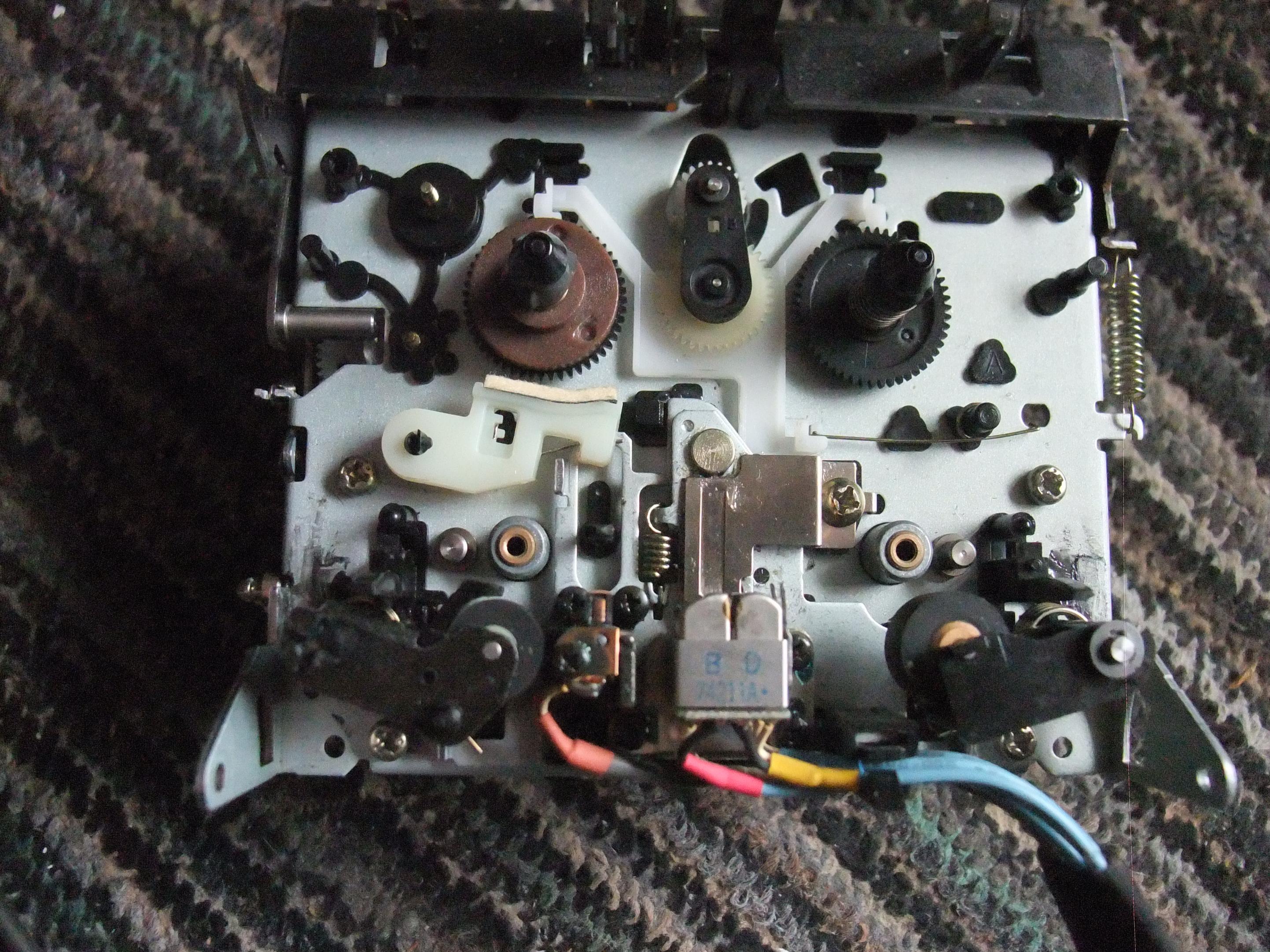

Now I dismantled the TCM-200 from the TC-K770ES
The cause of the in post #1 mentioned error was the gearwheel "Communication C" 3.356.703.01 (service manual TC-K770/570, page 44/32, No. 216/168 from exploded view).
After interchanging this gear weel and the motor board with both motors (reel motor and loader motor) from the TC-K570 to the TC-K770 the error went to the TC-K570.
The actually reason was that at the defective gear wheel had stuck in a groove a wire residue - go to the attached images.

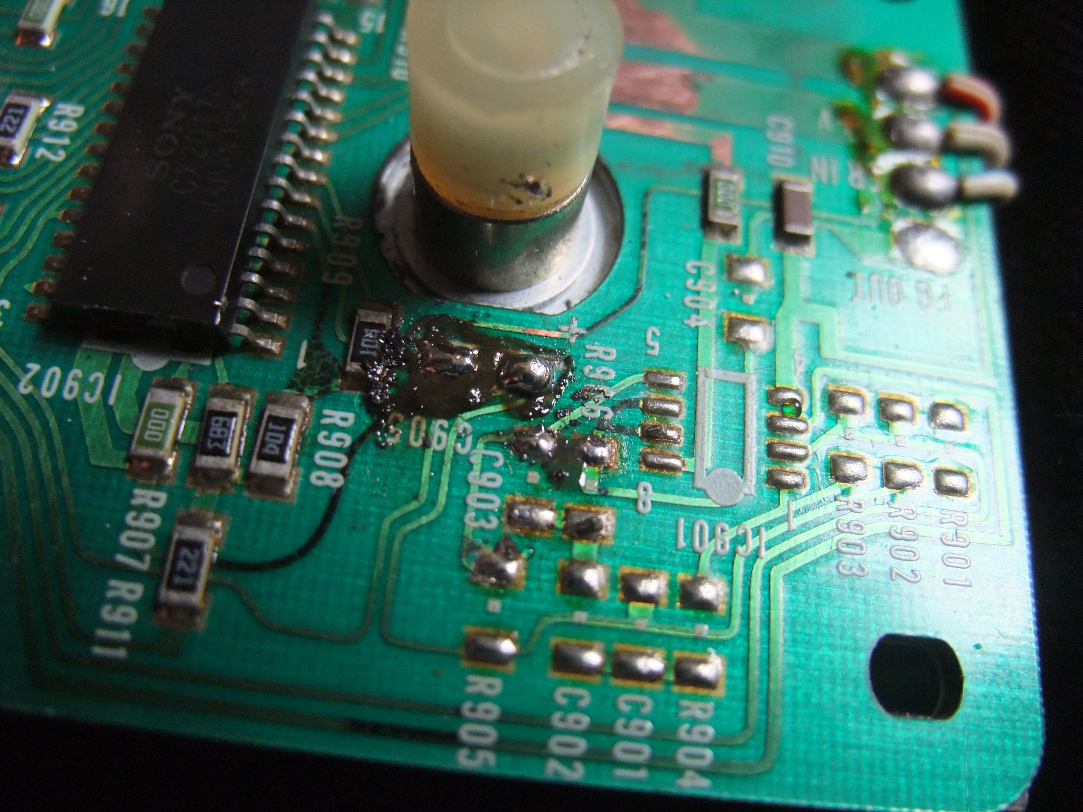

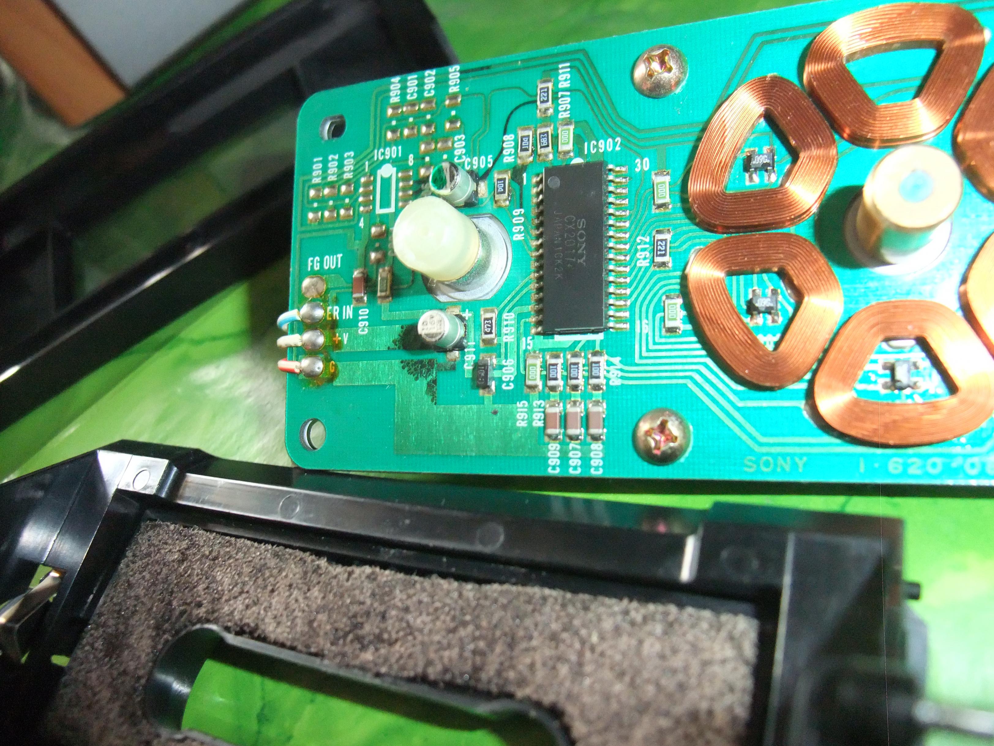

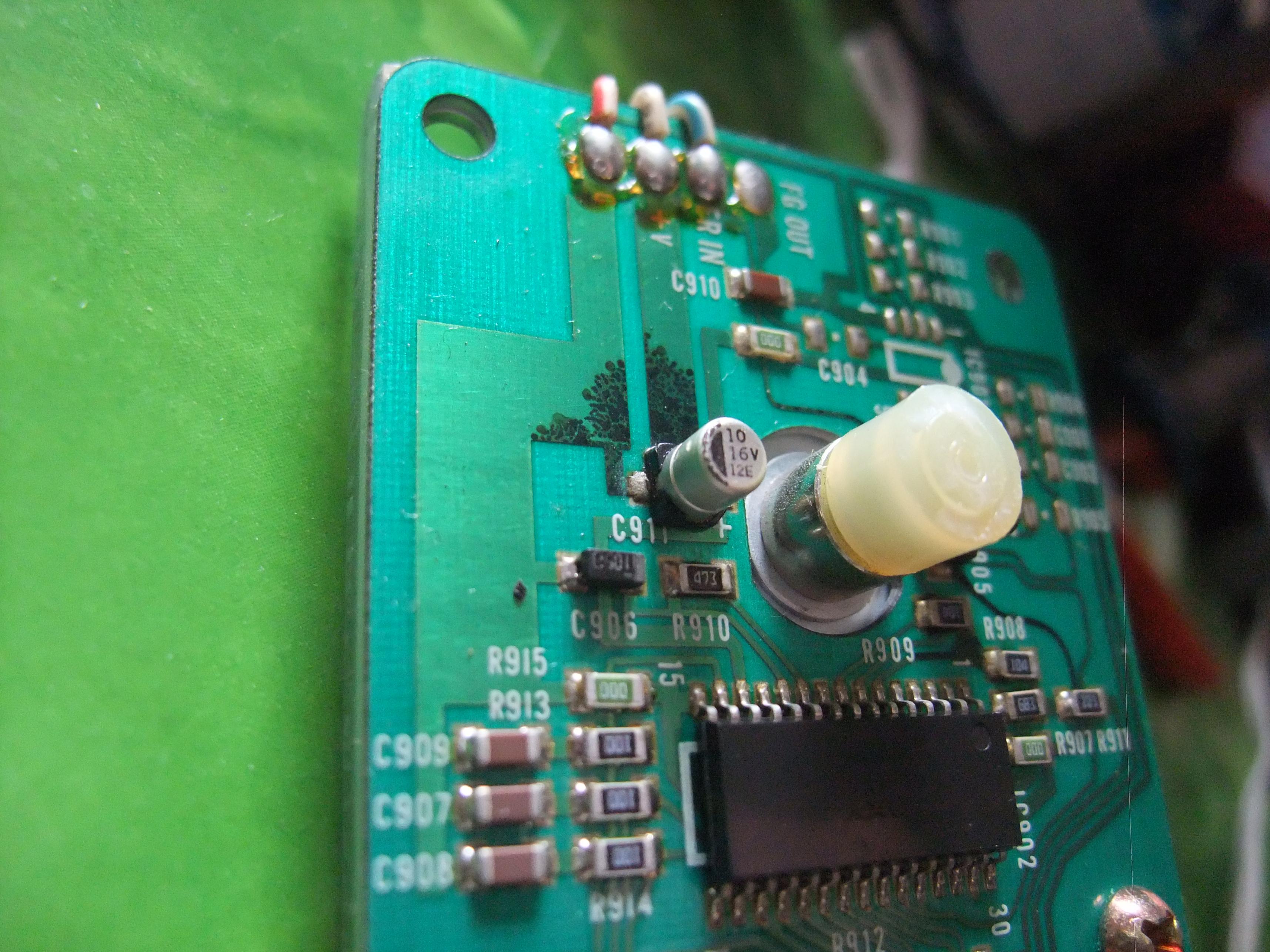

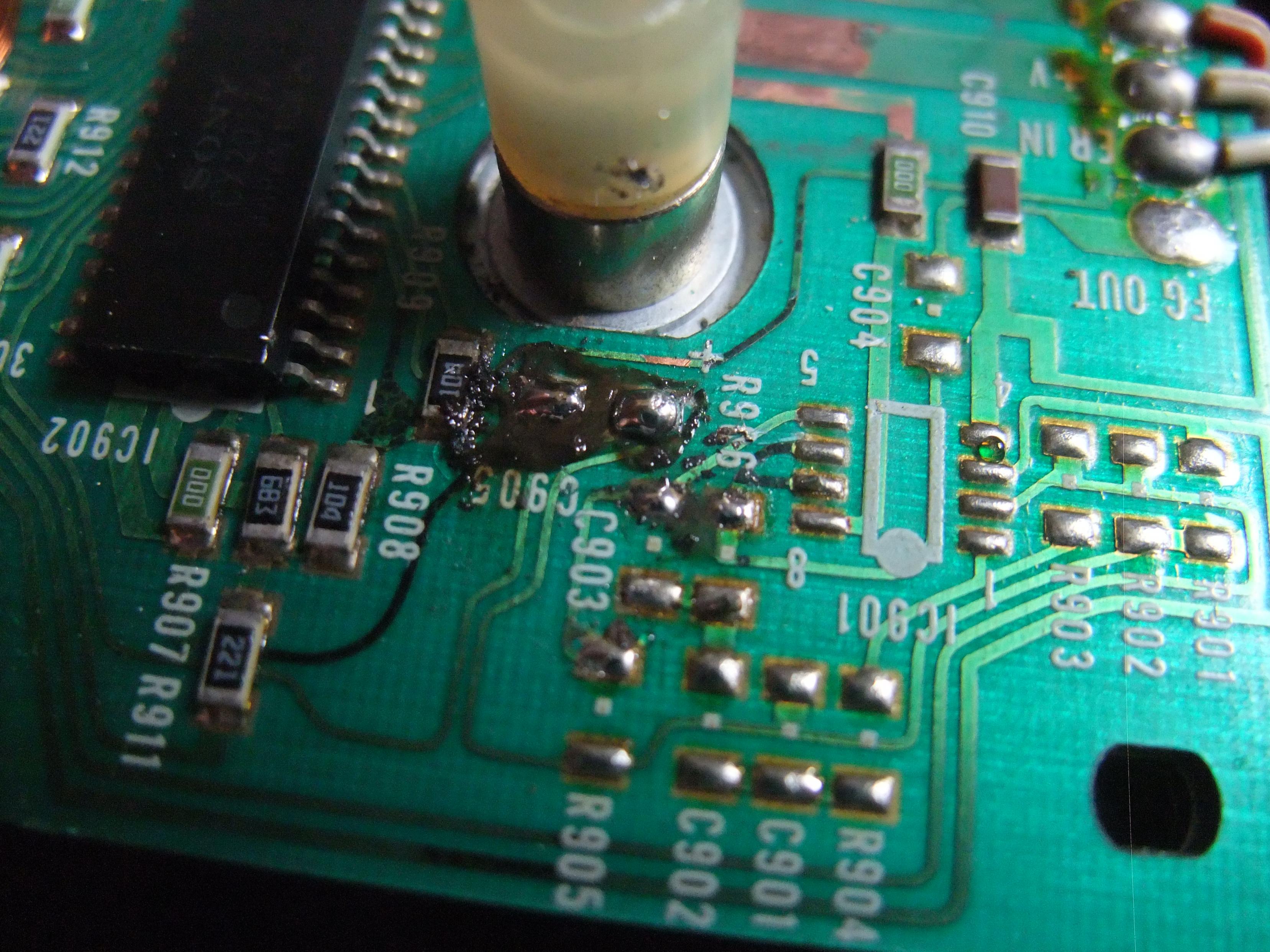

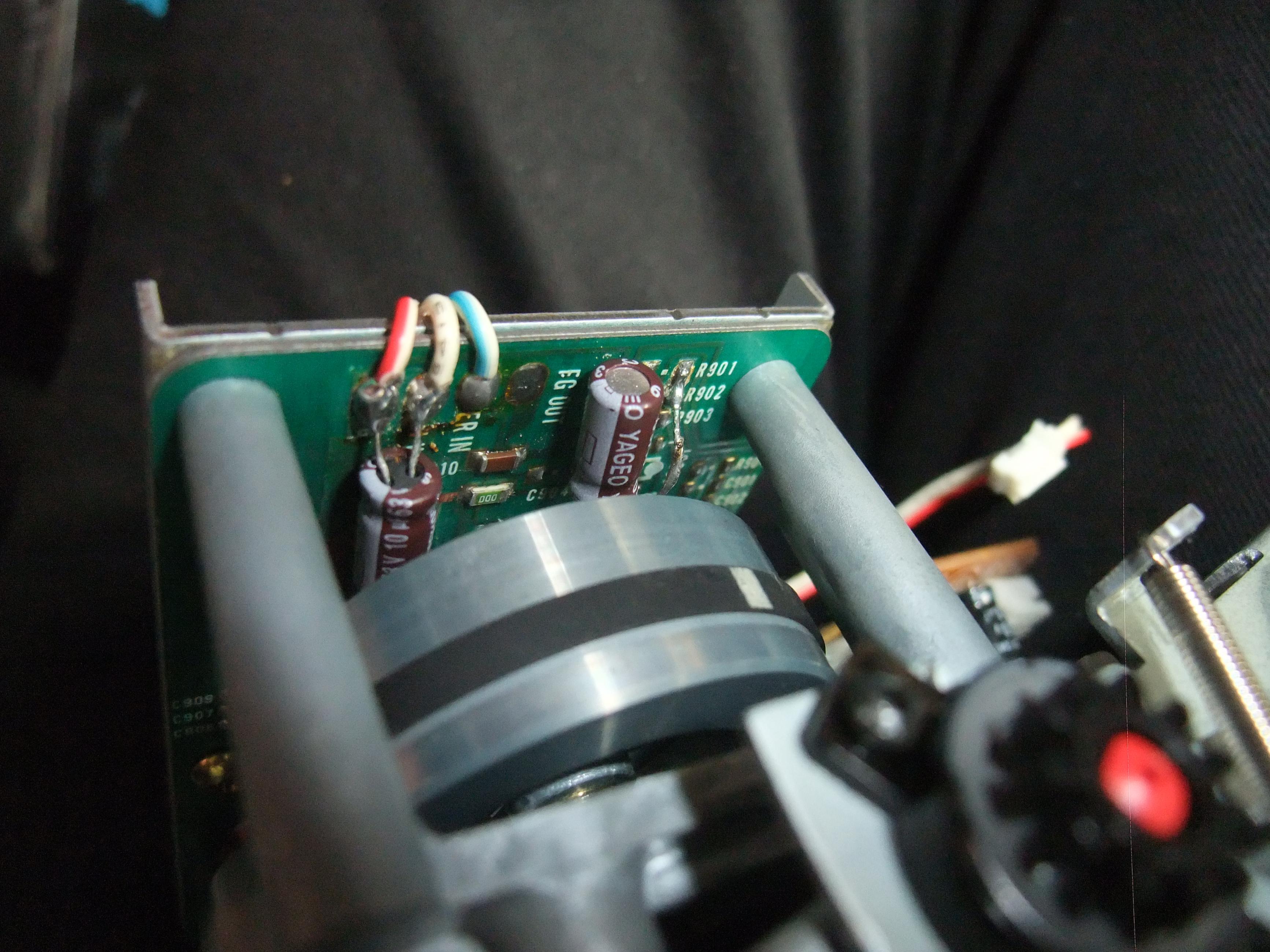

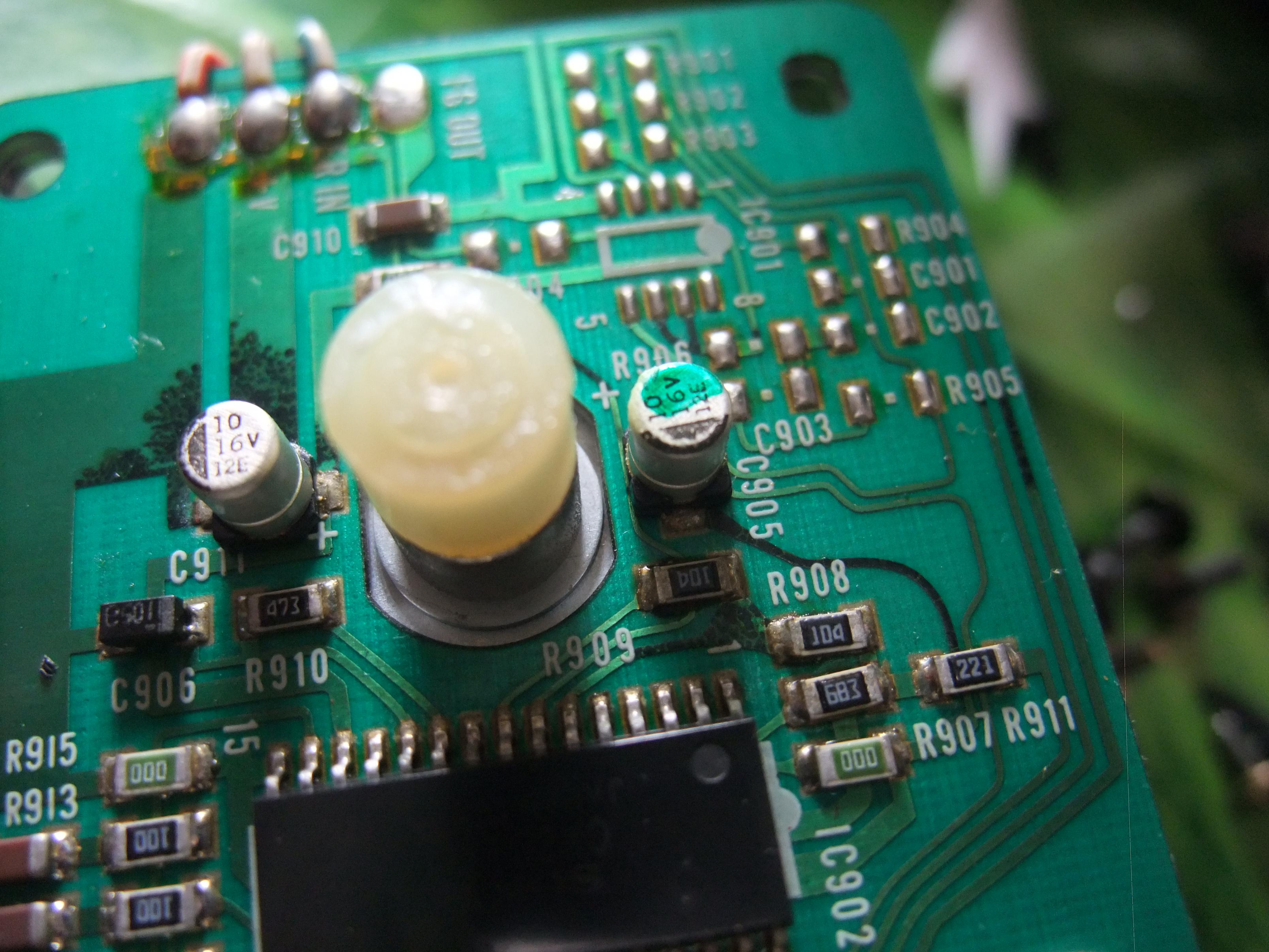

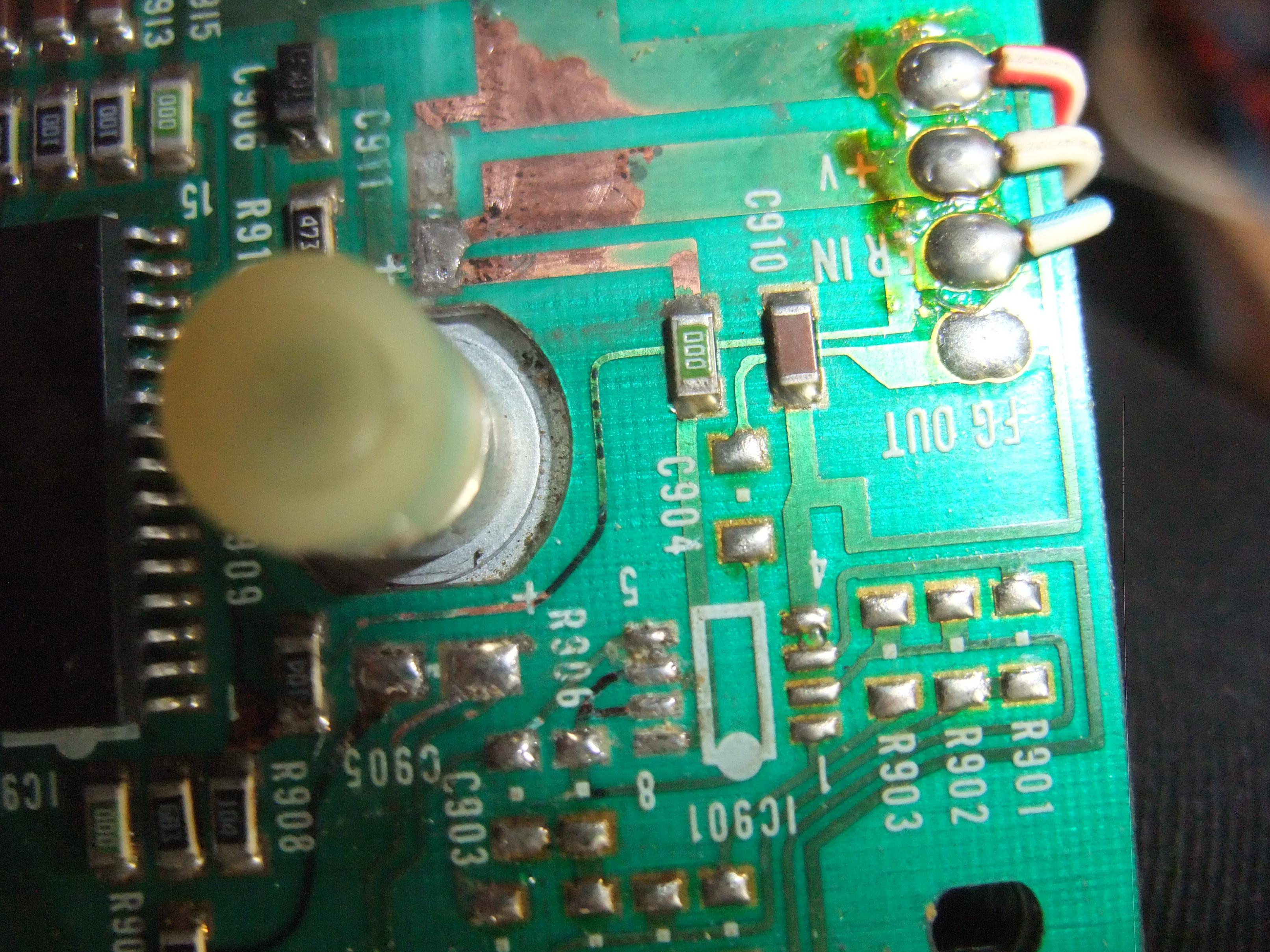

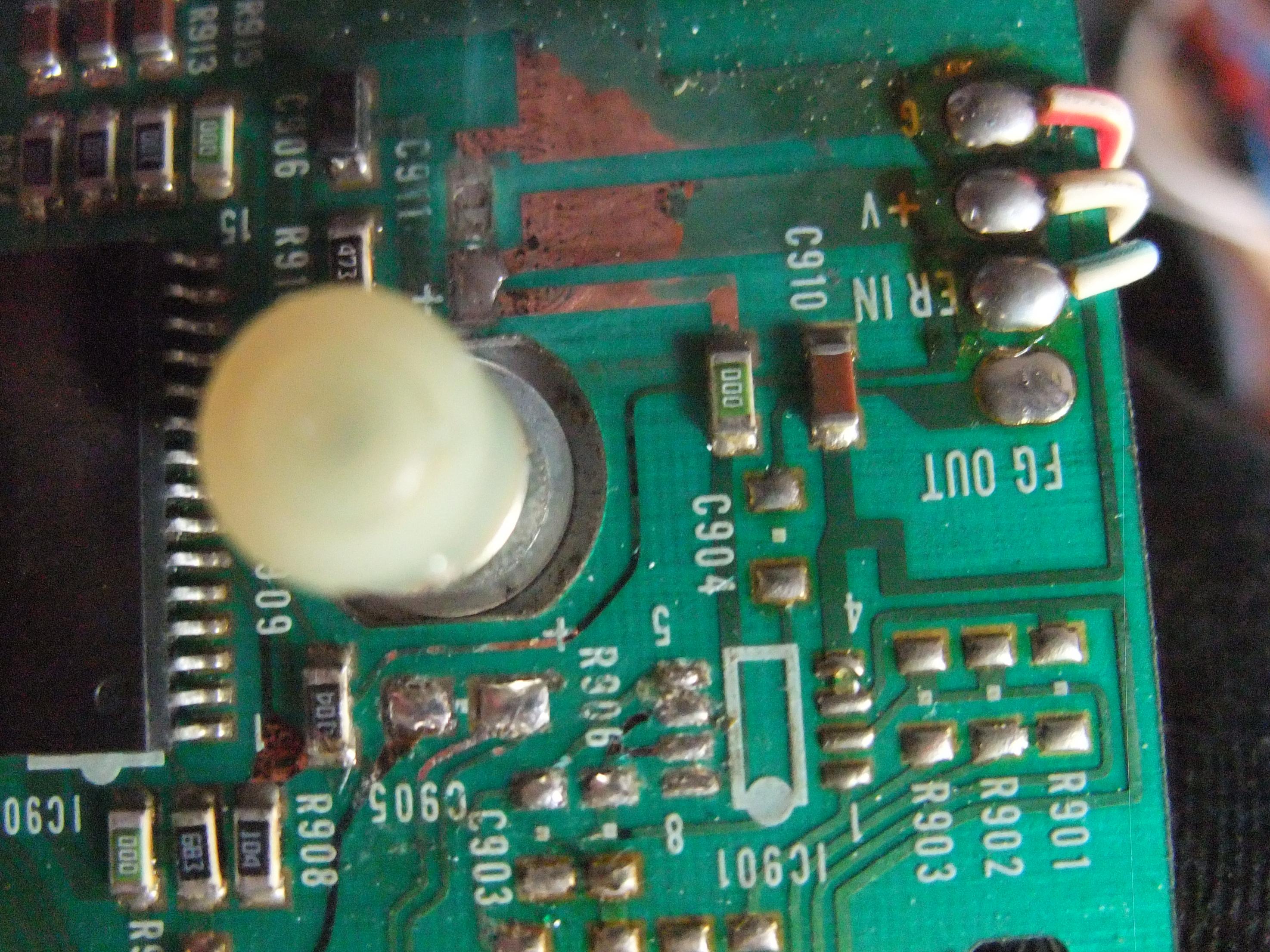

Now I note no constant speed due to leaked electrolytic capacitors in the capstan motor control (inductor-) PCB. This images you will find in the next posting.

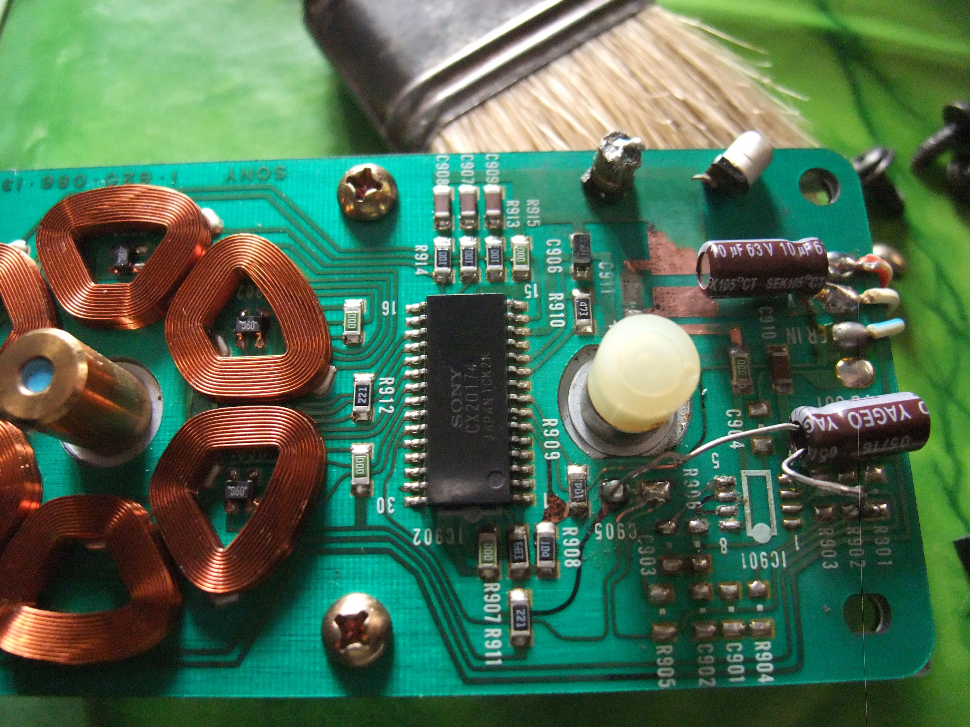

Replacing leaked SMD electrolytic caps
This was very difficult, because the solder joints was oxidized.
After carrying out the replacement with wired versions, a perfect operation without speed fluctuations was observed.

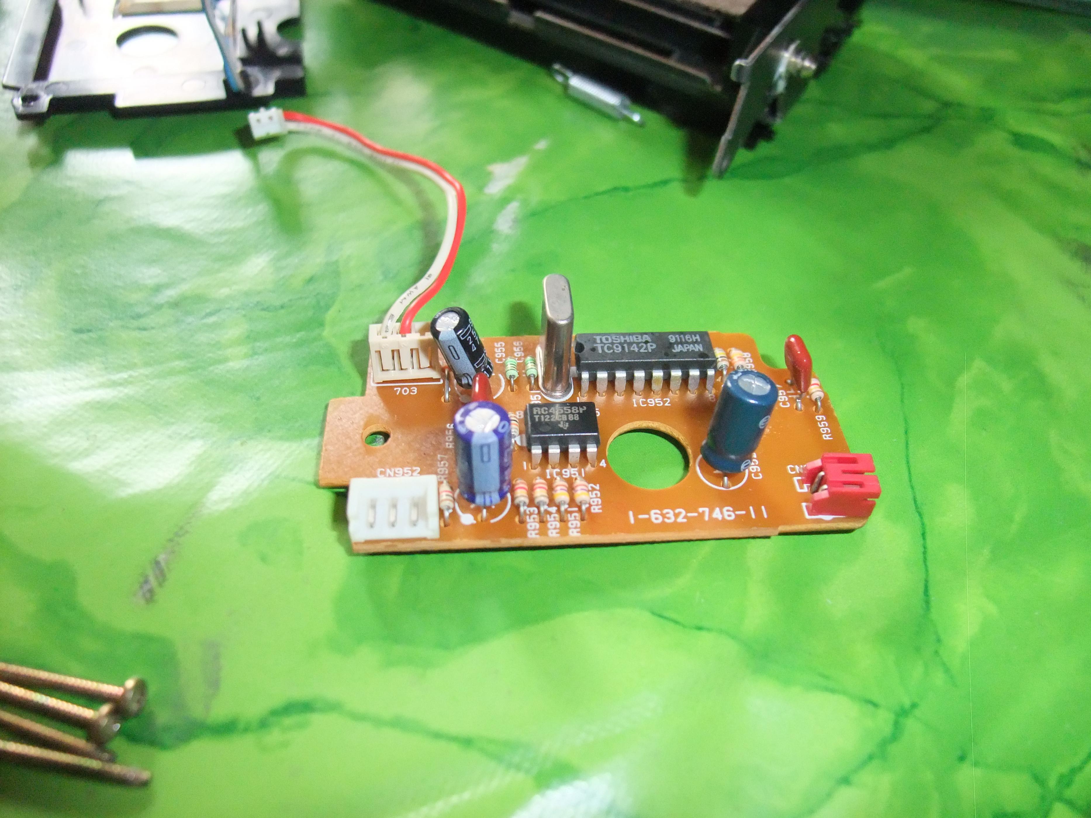

some additional images from this transport mechanism from Sony.
The designation of the photos can be found if you log out.
