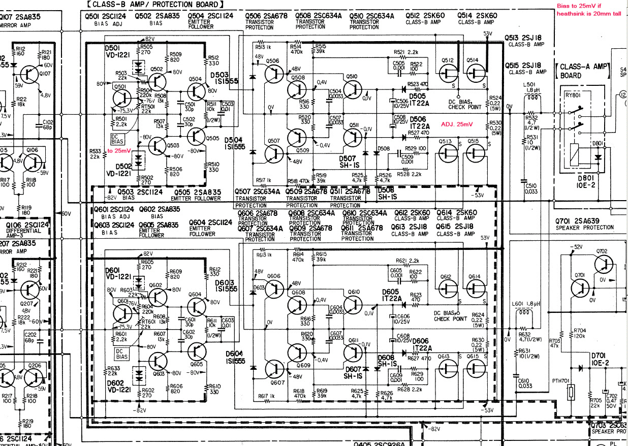

Powering up a VFET amplifier with a 'dim bulb' setup WILL, I repeat WILL BLOW UP THE VFETs.
And when they do, I sincerely recommend that the author of the question bill you for the 8 that will die, which, IF you are lucky, will cost you $50 a piece.
Now for the real advice:
It IS possible to power up the amplifier without the VFETs fitted and check out the VFETs as well as the relevant voltages to know if it will work. It is NOT trivial (needs some clever mechanical tricks as the VFET screws also hold the power amp PCB), but it can pass enough signal to drive a set of headphones with which the basic functionality can be checked.
There have been many threads here and also over at audiokarma.org, regarding all the Sony VFETs...
Normally yes, but first you have to change the biasing diodes D501, 502, 601, and 602. Replace them with series connected regular silicon diodes.
Than adjust the bias to 25mV on the V-Fet source resistors, or 20-25 Celsius above ambient temperature. Some amps have smaller heatsinks.
Be care full ! V fets are difficult to get. First remove the bottom plate. you can get access to the V fets. Remove and check them.Do you know how to check V fets ? V fets are depletion mode devices so very low resistance between source and drain.But between G-S and G-D shows as diode. If all the v fets are okay check the power supply voltages before putting the vfets back.
Please dont get upset with John ...he is been told many times before for similar issues ....some things will simply never change ...
Repairing above 1000 audio machines per year this the only thing we NEVER DO the minimum will be a visual inspection for capacitors and soldering issues before even think on powering up .
Machines that operate in higher bias than typical a few ma consumer amplifiers do , simply NEVER !!! Expect 100 timer more troubles in high bias machines ...
Pruimenvlaai I don't know how far you come with the switching on the amp, but I would listen to what ilimzn said. This is not about low or high bias, this is about the correct bias being there when the output stage gets his power. The v-fet is a depletion device, without the bias it represent a short to the B+, that's why would it self destruct.
