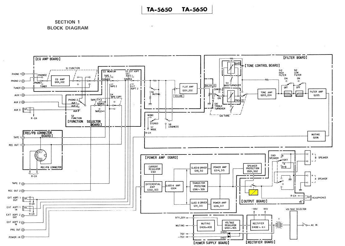

as the block diagram does not show any relays

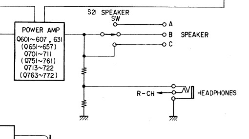

@Citizen124032 Sorry for the confusion. My unit is TA-8650. I am on this thread to obtain the TA-5650 speaker terminal blocks from @tfm3 to replace the ridiculous speaker terminals on the 8650. The spring-loaded ones from the 5650 appear to be an exact size fit. I thought that I would asks for the speaker relays too, except there are no relays in the 8650 (from the service manual block diagram). I do wonder if that is also a concern, no speaker protection.
I'm def seeing a relay - prob protect circuit. Located behind power sw. Don't have time to follow up- I'll check the schematic later.
Be easier for me to pull and ship the tiny pcb that the relay sits on. That's going to take me a few days to get at. Might want to open yours up so I can send you a pic of mine to compare. Or listen closely when you power yours up. I could hear it kick in clearly behind the front left. On another note, you may find the spkr blocks suitable without the 5-way post mod. I had 12 gauge stranded Belden spkr wire in them that seated just fine.

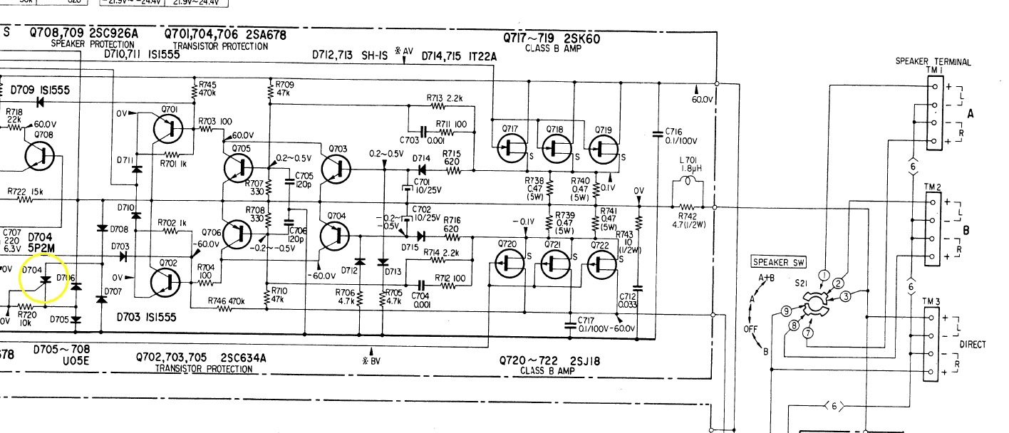

Fair enough, the 8650 has no relay indeed, only thermal protection (kicks in at yellow circle).My unit is TA-8650.

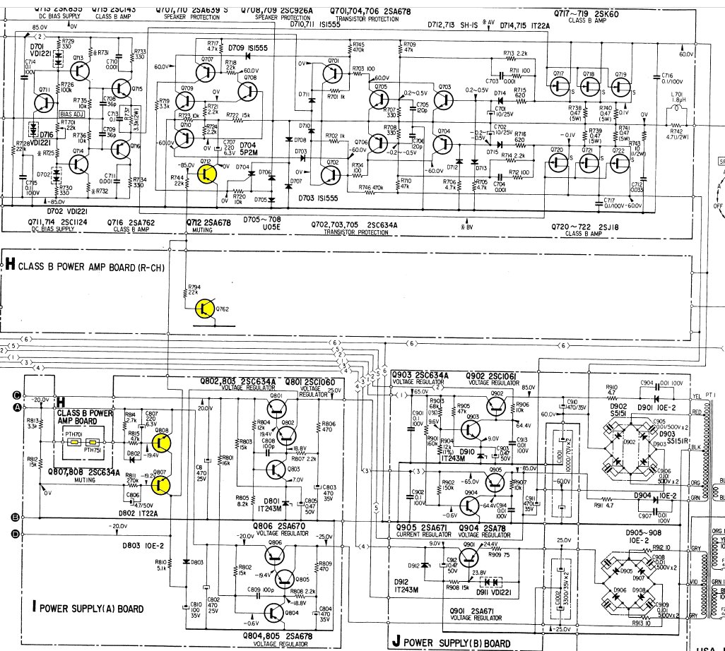

Sort of statement, as this thermal protection prooves another confusing 'solution'....performed some sort of protection some other way...
My guess that D704 was part of it is wrong. It's more involved with muting in some way when overstressed.
Again yellowed the thermal protection parts, a nice evening spend to study upon.
And even more something I noticed: those protection circuits are useful when the amp is running. But very questional how it operates during startup and shut down. Hence maybe this 'large volume surge'.
