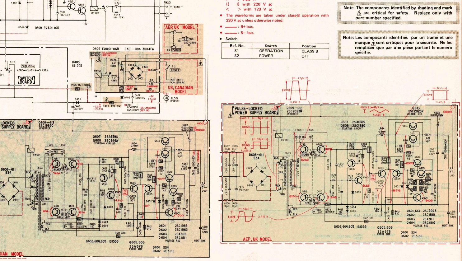

sony ta-n86b power supply help please
Being looking at this board for a few hours checked all transistors and change most diodes
i marked the voltages i am getting at test points
could anyone take a look and send me in the right direction..
most of the voltages are twice what they should be see attached
thanks so much for any help

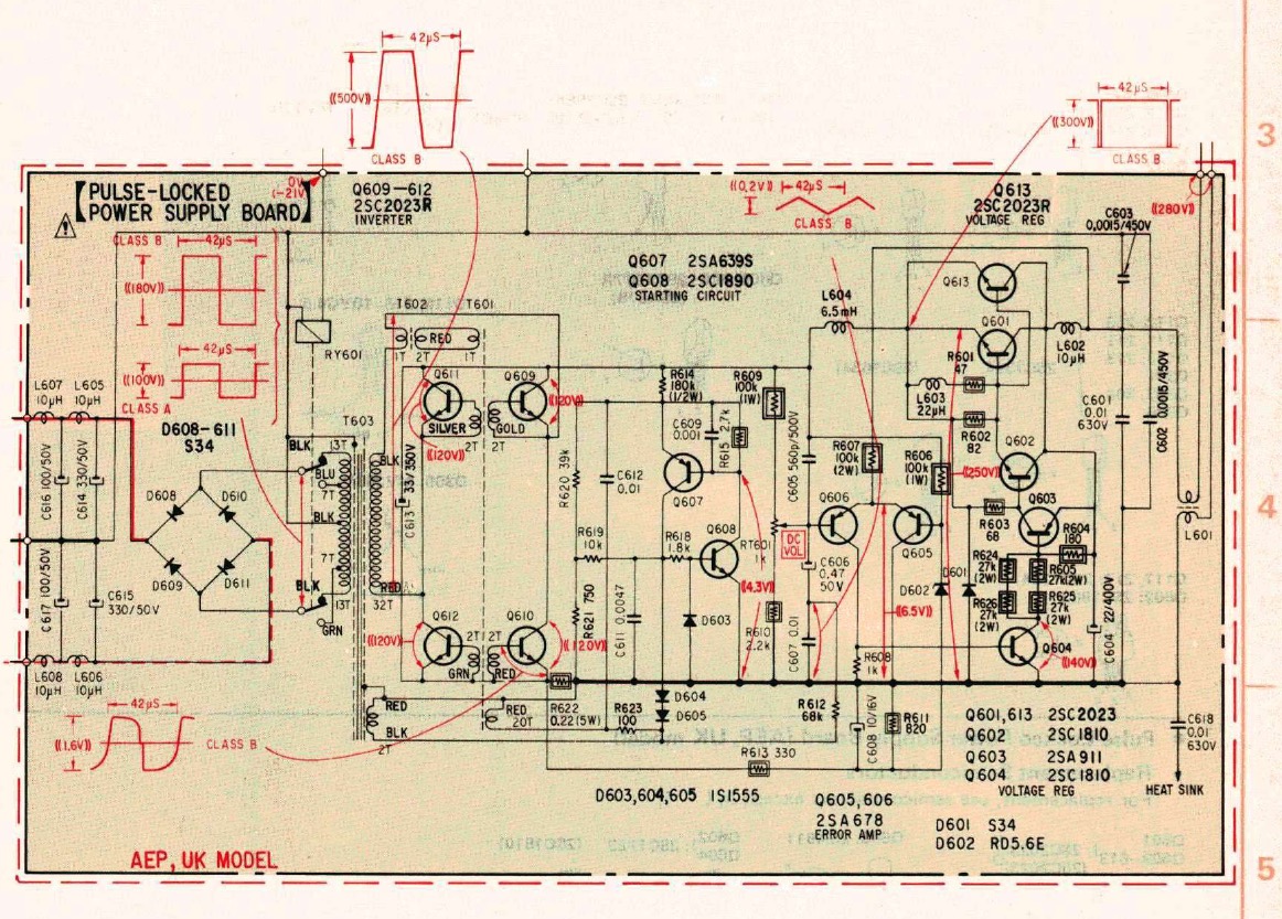

Keep in mind there are two main variations of this supply: the 110V and 220V versions. Not knowing where you're from, I supplied the EU version below. If it is a 220 version on 240V, you get 9% higer values (131 is close to measured 134).
Drop me a pm for a extensive Service Manual.
