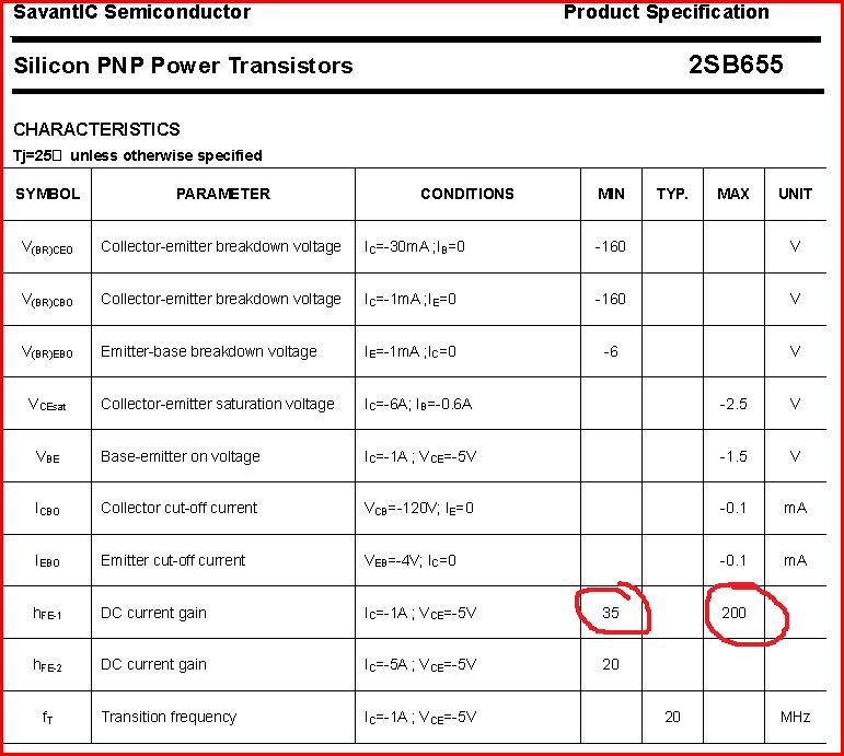

OK, here's what I am thinking.
I remember telling you earlier that the transistor types won't make a difference... and that's true as regards "volt drops across junctions". That's cast in stone and down to the properties of silicon.
However... I have tried to find info on the output devices and although I can't find much I see they are quoted as having a DC current gain of 35 to 200. Now 200 is exceedingly high for an "old" device and knowing how Sony often select devices...
You see what I am thinking is that if the gain of the ones fitted as replacements is low, and if any others in the stages before have been replaced too, and they also are low gain devices, then in order to get the required 100ma bias in the outputs (to generate that 22mv across the 0.22ohm) it is going to need more current to drive them. That current comes from the IC and its supply is limited current wise by the resistors feeding it from the main rails.
I can't remember whether you said all the other transistors were original or not ? If not, what is actually fitted ?

All four output transistors have been replaced from the original Hitachi 2SD675 / 2SB655 to an OnSemi MJ21193 / MJ21194 per channel.

I guess it might be an idea for me to try and get some genuine NOS Hitachi output transistors to make sure it really is working fully to spec. There are some on Ebay but they look far too modern - probably fakes. Still then I'd not know what gain Sony matched these for. Hmmm....!

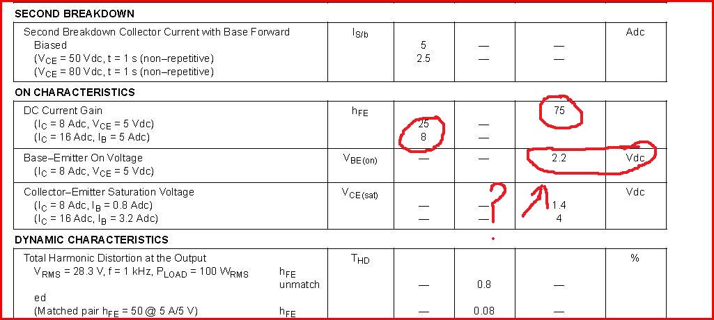

Just been having another look at the specs for the outputs. The Base/Emitter volt drop at high base currents is very high for the MJ's. That adds to the reason why they are behaving like this I suspect

See what you think anyway and have a think what you want to do. Its a case what would you fit other than the MJ's

I think you won't be happy unless it's "right" so let me have think what might be suitable replacements. I'm pretty sure now we are on the right track with this... as you say it's all down to incorrect parts being fitted.
