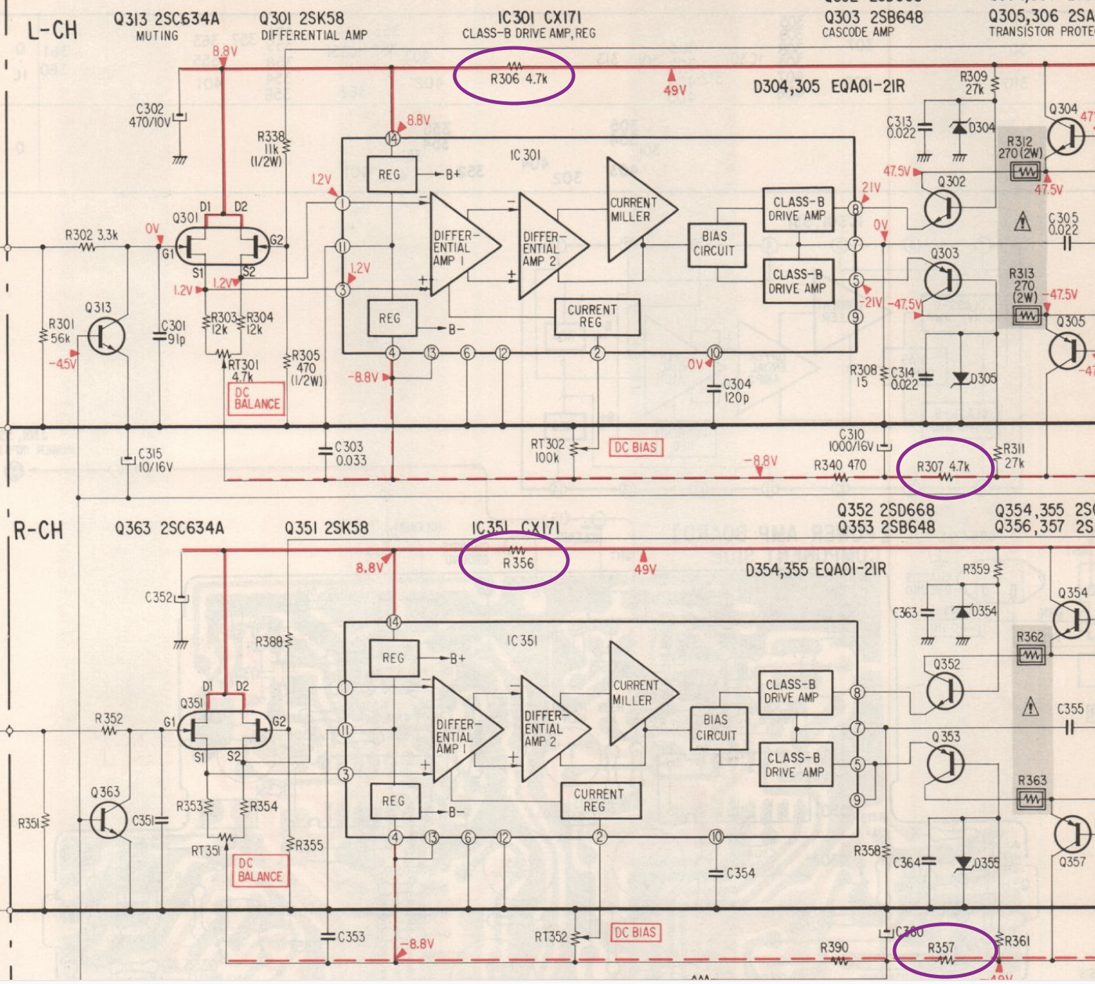

I inspected closely the board, and found a few 4.7k resistors with cracked shells. The interesting part is that these resistors are on the same place on both channel. These are 0.25W resistors, I'll replace them tomorrow with 0.4W(i don't have in 0.25W right now).

Those resistors feed what will be a shunt regulator (like a Zener) within the chip. If the rails (the 8.8 volts) are correct then the the resistors are probably OK. It's not uncommon to see the glaze cracked on hot running parts like these.
Wattage needs to be:
49-8.8 gives 40.2 volts dropped across the resistor. Power dissipated is (40.2*40.2)/4700 which is 0.34 watts. A 1 watt metal film would be a suitable choice for replacement. I can't find the originals in the parts list but typically they would be metal oxide which are good for high temperature running.
If the originals read OK when isolated they will be fine.

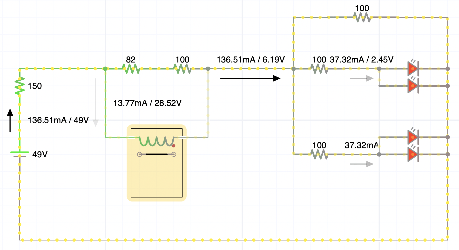

Mooly, I made a small mistake :) I just realized, that I soldered a wrong resistor to the LED replacement for the VU meter light. So I think the soft start relay never switched...
Today I made a rough calculation to the replacement lights: 1W 100 ohm resistors parallel with the main light rails -> in each meter 2 LED in parallel+ series 0.6W 100 Ohm resistor. The LEDs got ~19-20mA.
From another topic I remembered thath the relay coil resistance is 1622 ohm(24V), and the original lamps was 6.3 70mA so I made the calculation based on that.
The problem is, that the 150 ohm 7W resistor starting to get pretty hot after a few minutes, and the speaker protection relay is taking much more time to click(around 10 sec). Before that it was like 4-5 sec.
I don't think this has to be do something with the bias problem, because I measured it while adjusting the preset and the problem still persist.
Did I made a silly error during the calculation?

The 150 ohm will get hot. It has to given the voltages involved.
Some variables are whether the relay is intended to run at 24 volts or whether it is slightly under run.
Another variable is the volt drop of your LED replacements. Working to the values you have (1622 ohm relay resistance) it works out like this.
The bulb must have had a hot resistance of about 46 ohms. The 150 ohm will dissipate around 3 watts which will make it hot.
As long as you have approx 20v or more across the relay then it should pull in normally.
Thanks for confirming, then it should be ok. Just the resistor seemed to be really hot(you know, when starting to smell:) ) and I scared that I messed up something, because just 2.8-3W heat should be dissipating and it felt like more.

If the voltage across the 150 ohm is as both our diagrams show (about 21 volts) then all is well. 3 watts is more than you think and will heat the resistor significantly.
I think you said both channels have the bias issue and that makes a duff CX171 very unlikely. Does pin 2 of the chip vary correctly as you turn the pot. It should go from zero to -8v or so.
I'll measure the voltage on 150 to make it sure.
Couldn't measure voltage on pin 2 , because I started to replace a few propylen/mylar caps which looks like original. But.. I had an idea and measured resistance between pin 2 and -8v rail. It stays on 3.5 kOhm, no matter how I set the preset(just on one end showed 0).
So I thought what if something shorting out the bias pot? Desoldered C303 33n mylar cap and voila, the pot resistance changes between 0 and somewhere 10k. Ok, what about the other channel? Desoldered the same cap and boom, the preset is changing here too, from 0 to 10kOhm.
Soldered 2 new 33nF MKT cap as replacement. I hope it solves finally the issue and before powering up I'm started to replace the remaining mylar caps.
